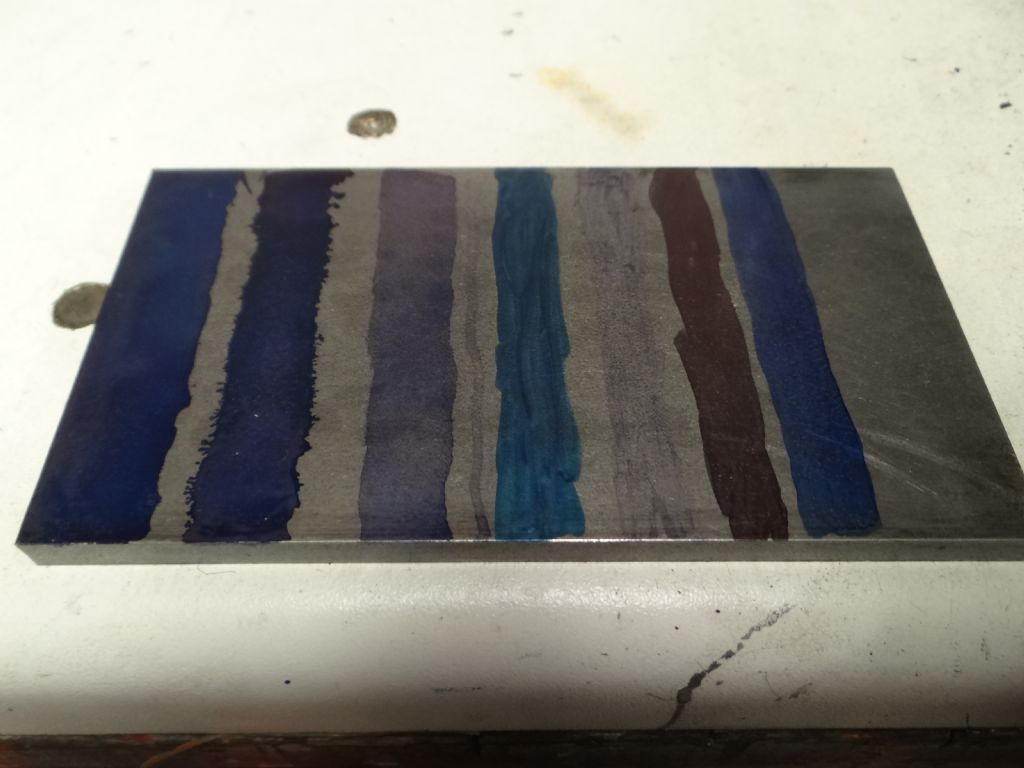

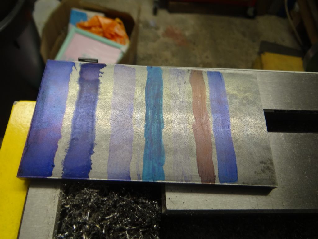

                                                  Couple more photos to look at. They're the same mild steel plate at different angles to the light. The plate was degreased and wiped with meths.
                                                  From left to right they are:
                                                  • Unbranded Layout Blue bought at an Exhibition
                                                  • Dykem Blue bough recently in the UK, I think via Amazon
                                                  • Home-made by mixing Stuarts Micrometer Blue and Meths (bit thin)
                                                  • Berol Blue Permanent Marker (bit streaky)
                                                  • Unbranded Blue Whiteboard Marker (terrible; it works much better on a Whiteboard!)
                                                  • Sharpie Black Permanent Marker (faded to brown as it dried but usable)
                                                  • Sharpie Blue Permanent Marker (best of the felt tips I have)
                                                  When the plate is rubbed with kitchen paper, all the felt tip markings come away within 8 strokes. The Dykem is still solid after another 8, but the unbranded layout blue is beginning to show signs of wear.
                                                  So for best density and wear resistance buy the real thing BUT a decent felt tip is good enough for most work. You may need to experiment before finding a good felt tip.
