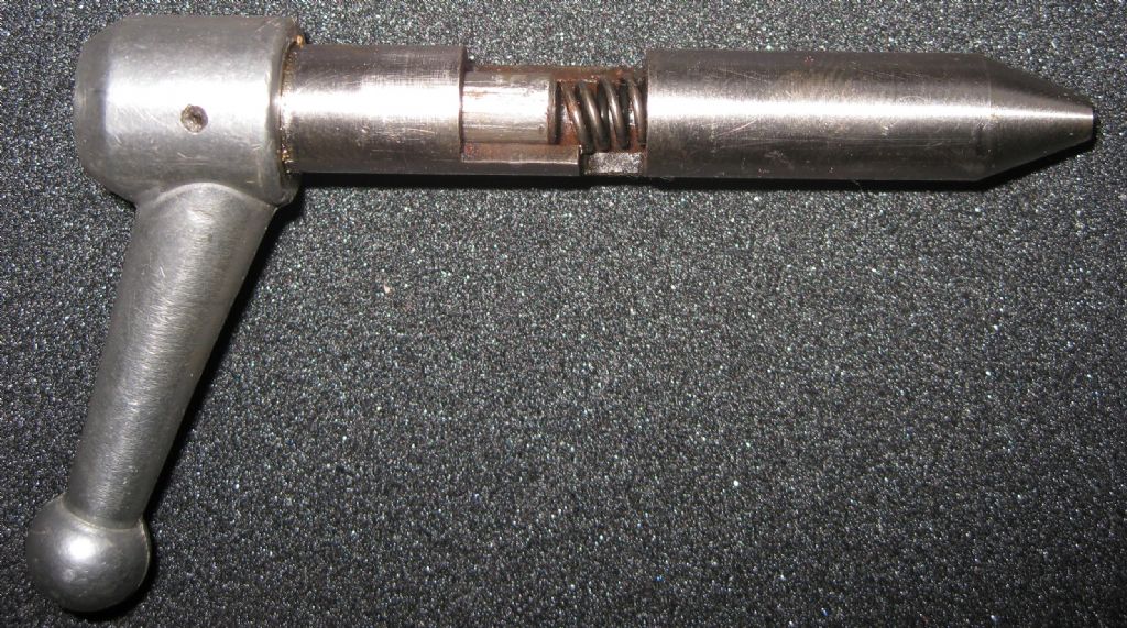

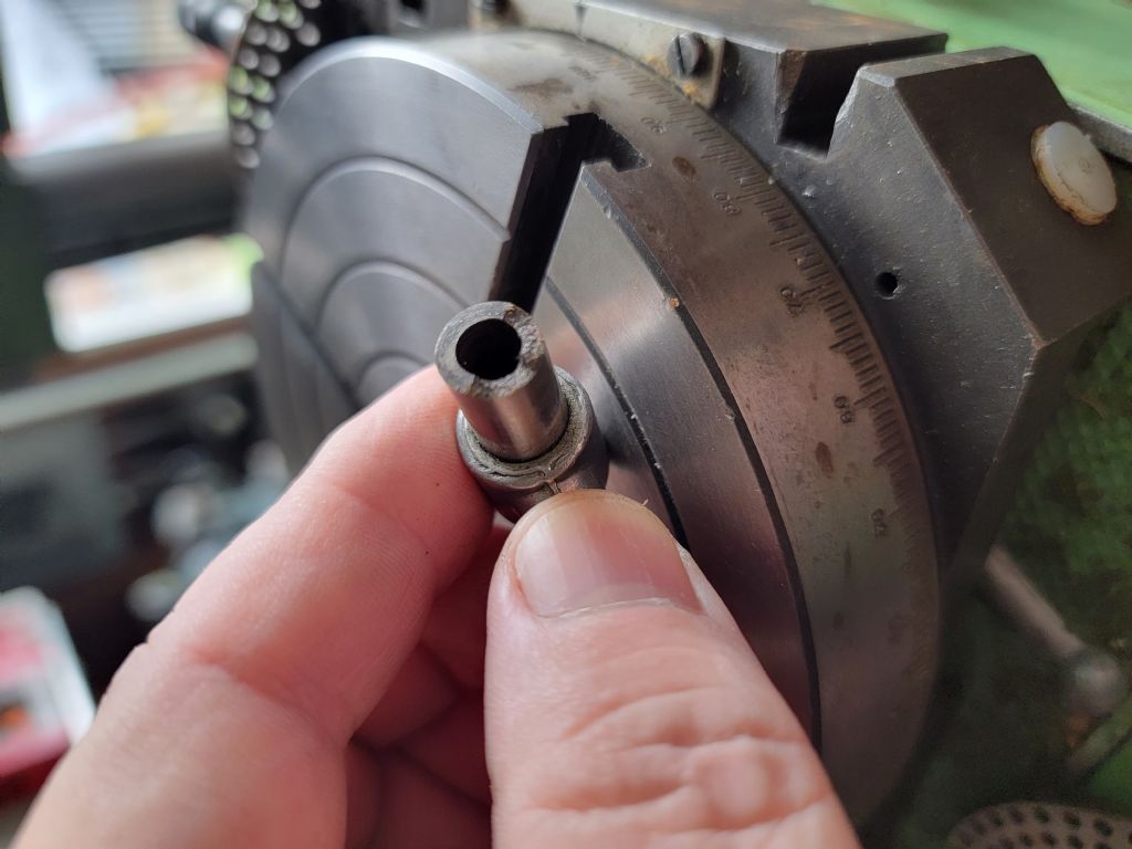

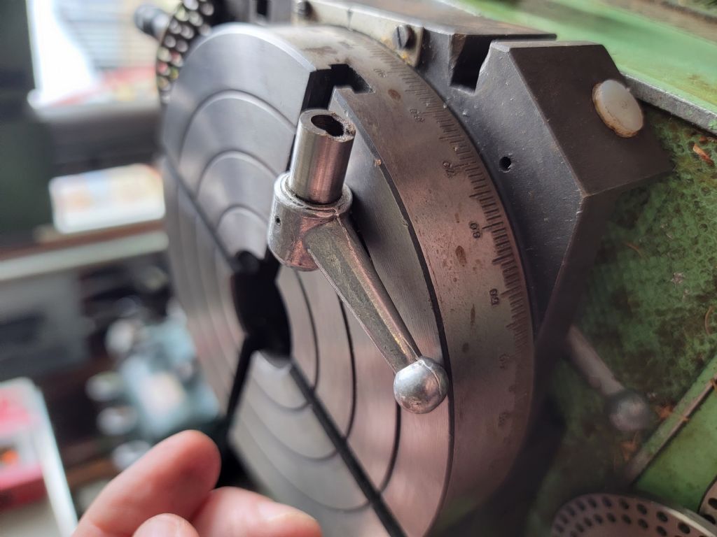

            #660115
            Jeffery Morris
              @jefferymorris50968
              Joe,

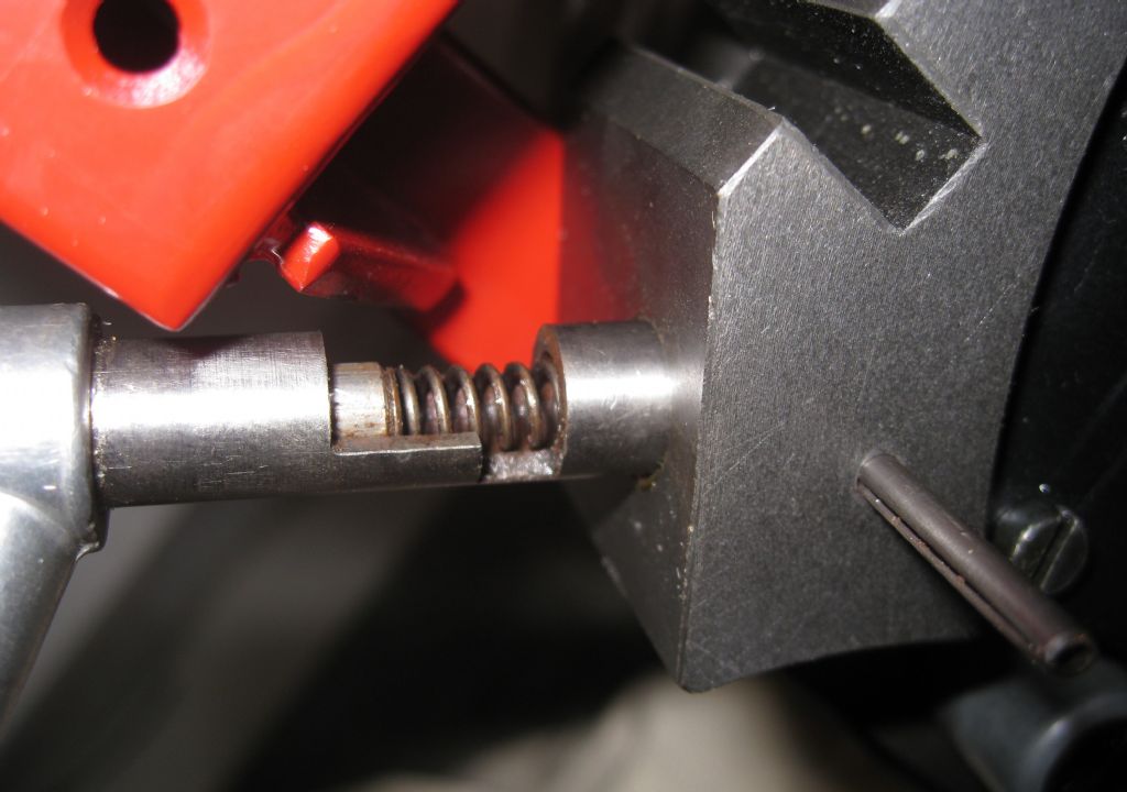

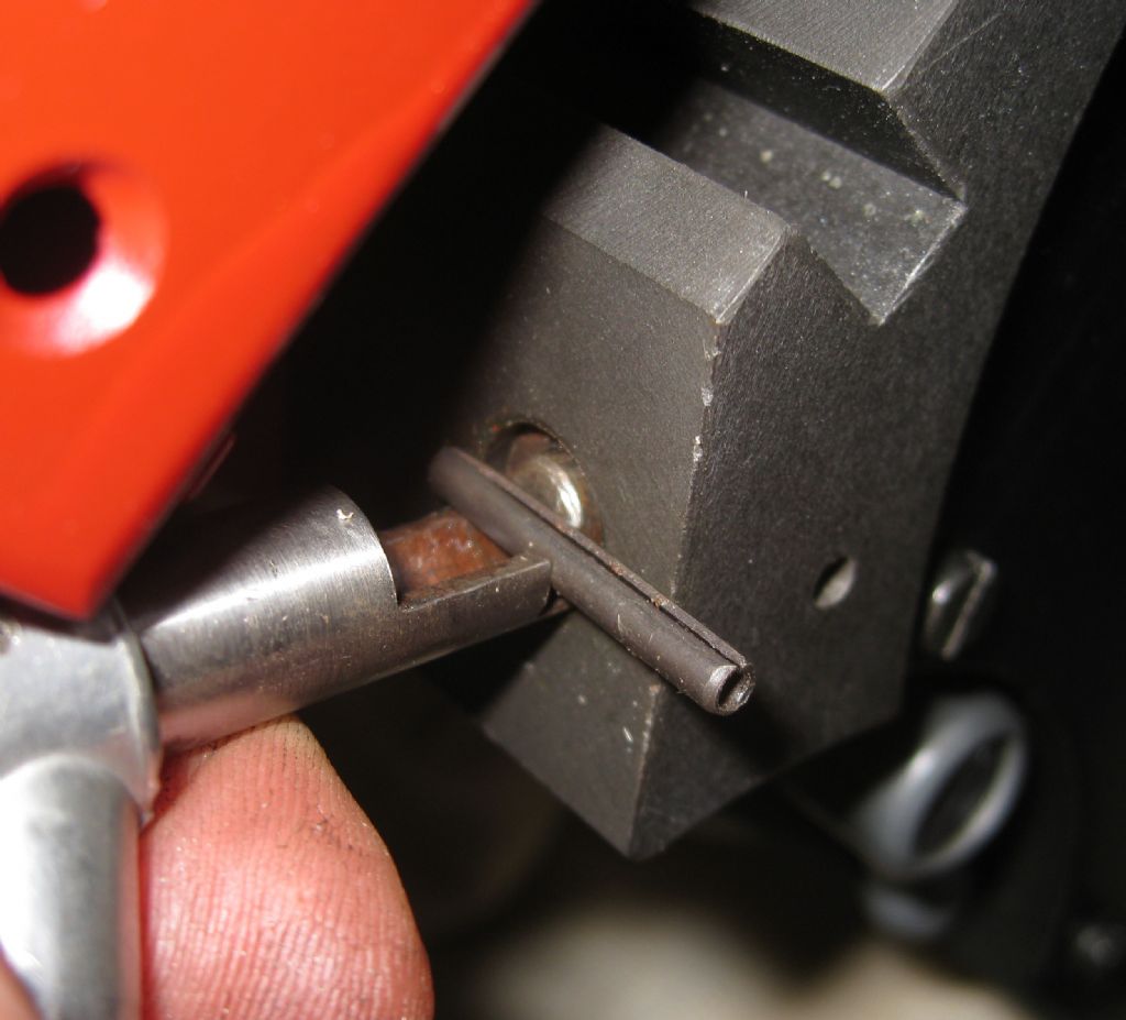

              I know this is an old post, but I have a couple of questions regarding the lock pin. I looked at your pic's and when you added the stepper motor it looked like you removed the handle and locking pin parts. you wouldn't happen to have pic's of them, would you? I picked up a v10-p lathe and this rotary table was included. it has a plug where the handle should be. i found the handle in the toolbox but it appears broken and I don't see anything in the hole. I'd like to see the parts that make up this part of the assembly.

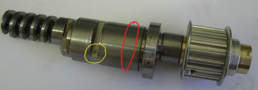

                  Hi Jeff,
                  I don't have photos I fear – there are part breakdown docs on the web, google will find them, but most are in French or German, and the part drawings are not very clear it seems…
                  This photo shows where the pin – item 9 in parts list, impinges on the point ringed yellow. the pin is screwed in, rotating the eccentric which snugs the helix up against the ring gear to take up play and backlash. The red ring is the surface that is clamped in the table body, by cap screw item 16, preventing the eccentric from rotating. To relieve the helix from contact with the ring gear, loosen cap screw 16 and rotate the eccentric away from pin 9, and the helix rotates away and free from the ring gear. Pin 9 slide in the slot ringed yellow, 'up' towards the top end as the eccentric is rotated, Pin 9 keeps the eccentric from pulling out of the table.

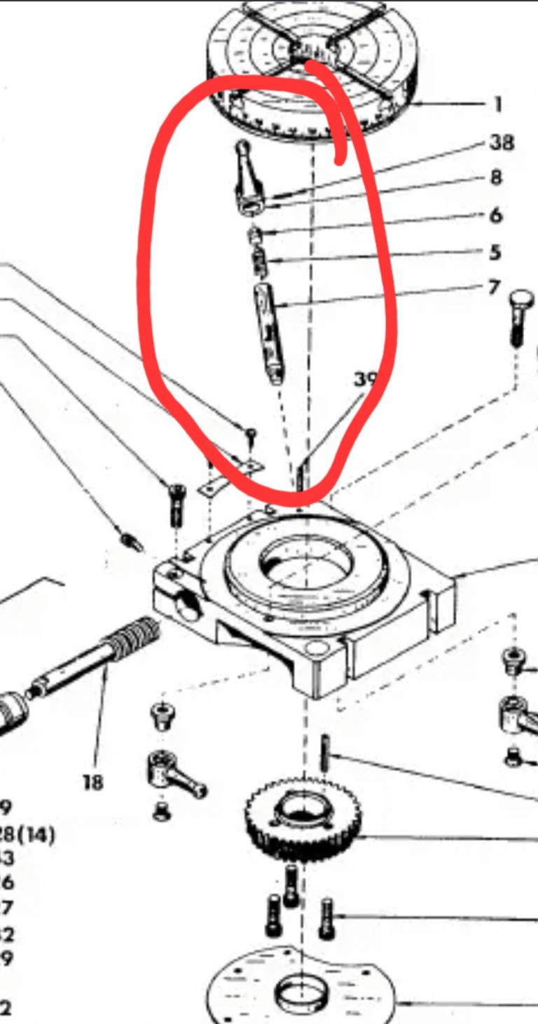

                  #660169
                  Jeffery Morris
                    @jefferymorris50968
                    Joe,

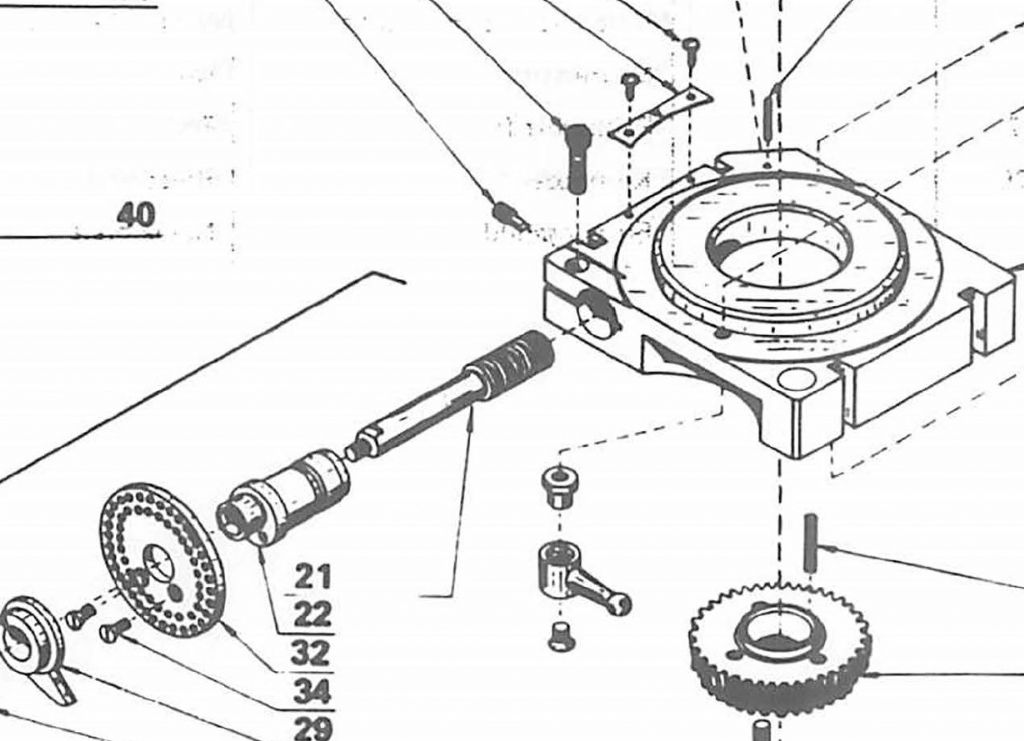

                    Thanks for all the information. I was actually looking for info on this part of the parts diagram:

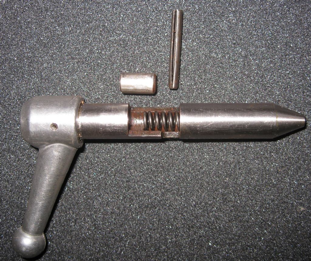

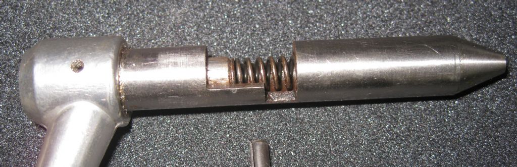

                    Here's my broken piece that I have:
                    Parts 5,6,7,and 8
                    Jeff

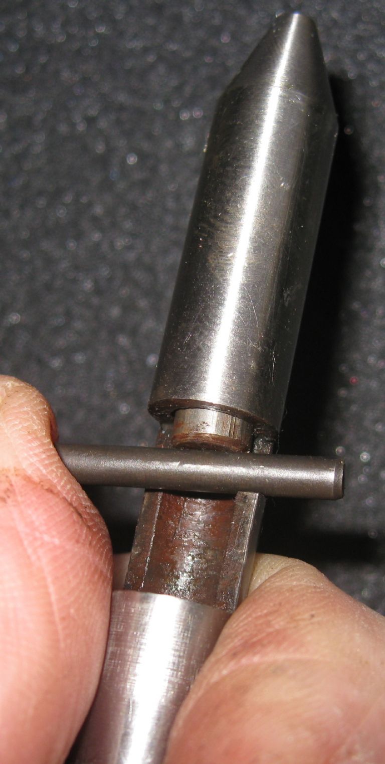

                    #660181
                    Joseph Noci 1
                      @josephnoci1
                      Sorry about that – without reference to the actual parts it becomes anyone's guess…
                      See photos below of the part – if you need a dimensioned drawing, let me know, I will see what is possible..

                        #660276
                        Jeffery Morris
                          @jefferymorris50968
                          Joe,
                          thank you so much!! those are the pics I was hoping to see. Now I understand how it works!!
                          thanks again!!
