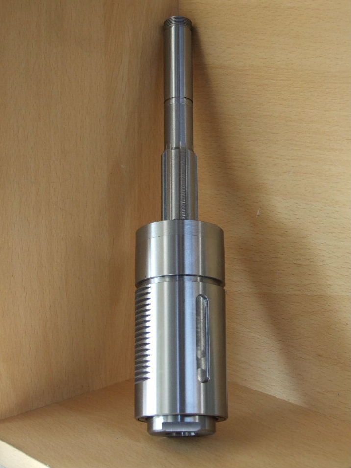

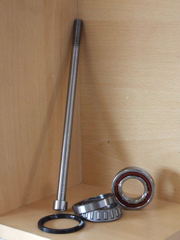

                          bought in items for revised fb2 quill.jpgnew parts for redesigned fb2 quill.jpgPosted by Kiwi Bloke 1 on 26/09/2018 08:41:11:
                          I'm sure I remember seeing something in this forum about the conversion of the needle roller bearing (& the others, of course) to taper roller bearings. Now I can't find it. Perhaps I'm mistaken. However, I think Graham Meek may have been involved. His earlier posts seem to have been redacted from various threads, which is most unfortunate for his followers. It's good to see his return to the forum. Perhaps he'll notice this thread and enlighten us.
                          You were right, guilty as charged. Please find below the missing images

                            Update: with the Needle bearing part number known I was able to forward this on to the bearing supplier and they are working on sourcing a replacement. I was also able to extract the old bearing and outer race from the quill, it came pretty easily a few taps after a little bit of heat.
                            The tapered roller bearing, is this a replacement of one of the ball bearings at the top of the quill? What would be the advantage and would it be worth doing?
                            #373701
                            Graham Meek
                              @grahammeek88282
                              Hi Sam,
                              The Quill assembly is all new. It is 8 mm longer than the standard Quill in order to accommodate the front taper roller bearing. The keyway slot shown would break into the bore of the new bearing on a standard Quill. The top bearing is an angular contact bearing.
                              The Sleeve was made from EN 8 and the new spindle was machined and ground from EN24T. The whole purpose of this new quill was to try a new bearing arrangement. At the same time I was making a new standard Quill sleeve with a larger outside diameter, for a better fit in the milling head bore.
                              Was this new set-up any better than the standard set-up? That is hard to say, I could not see any visible difference. There was no improvement in milled surfaces. If anything the standard needle roller bearing will withstand more load than the taper roller bearing, according to the bearing catalogue.
