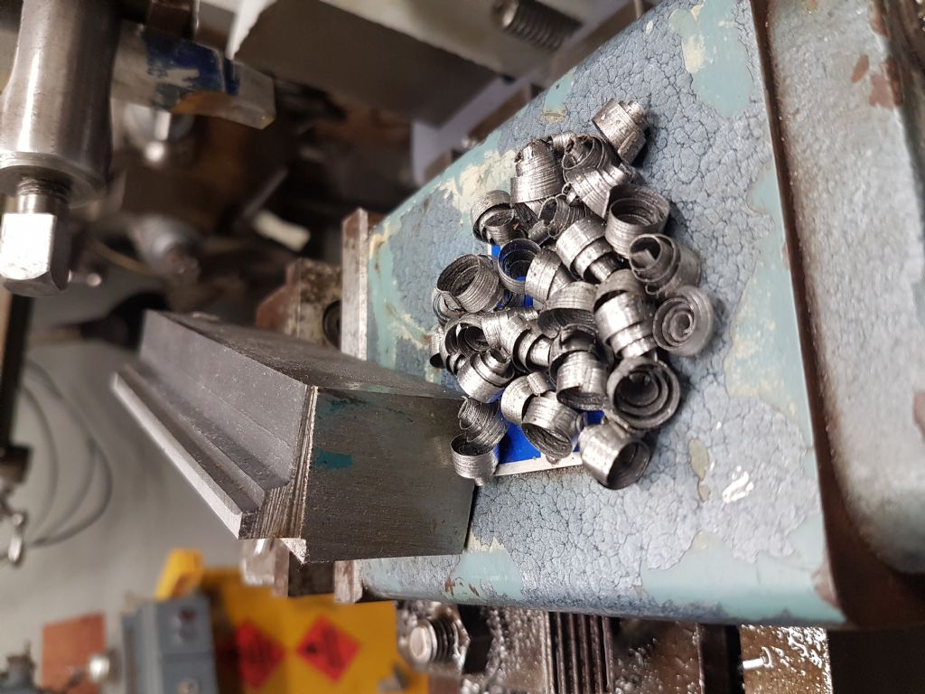

            I'm currently in the process of putting bigger flip top oilers on the ram and putting wipers on there to to keep the oil in
            I have been amazed at the shear power of these machines last night I was roughing down some steel at a 4.5 mm depth of cut I'm sure this could he improved as it's the first shaper tool of made

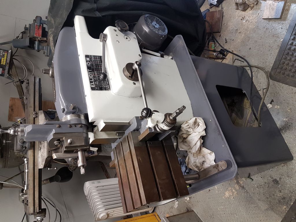

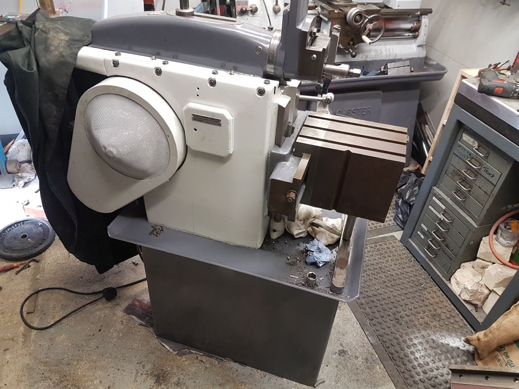

                      Looking good Sean, do you have the cabinet door?

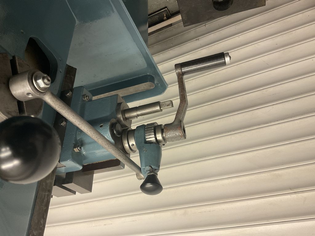

                        I see you also have an intact gear shift knob, that often get smashed being made of thermoset plastic mine has.. Can you do me a favour? If you have what looks like an original winding handle post some pics with a rule, I need to make one and would like to get it close to the original. Thank you.

                            Tony, if you want email me at lincsecret@gmail.com I can send you pictures of my machine with a replacement gear shift knob and what I believe to be an original winding handle, or at least it came with the machine and fits. I have never had any need to shift the gear or change the belt on the pulleys as it does everything I want of out of it on one speed. I just adjust the length of stroke and ram position occasionally to encompass the job in hand.

                                  My gear shift knob is not orginal the orginal ones where not ball shape

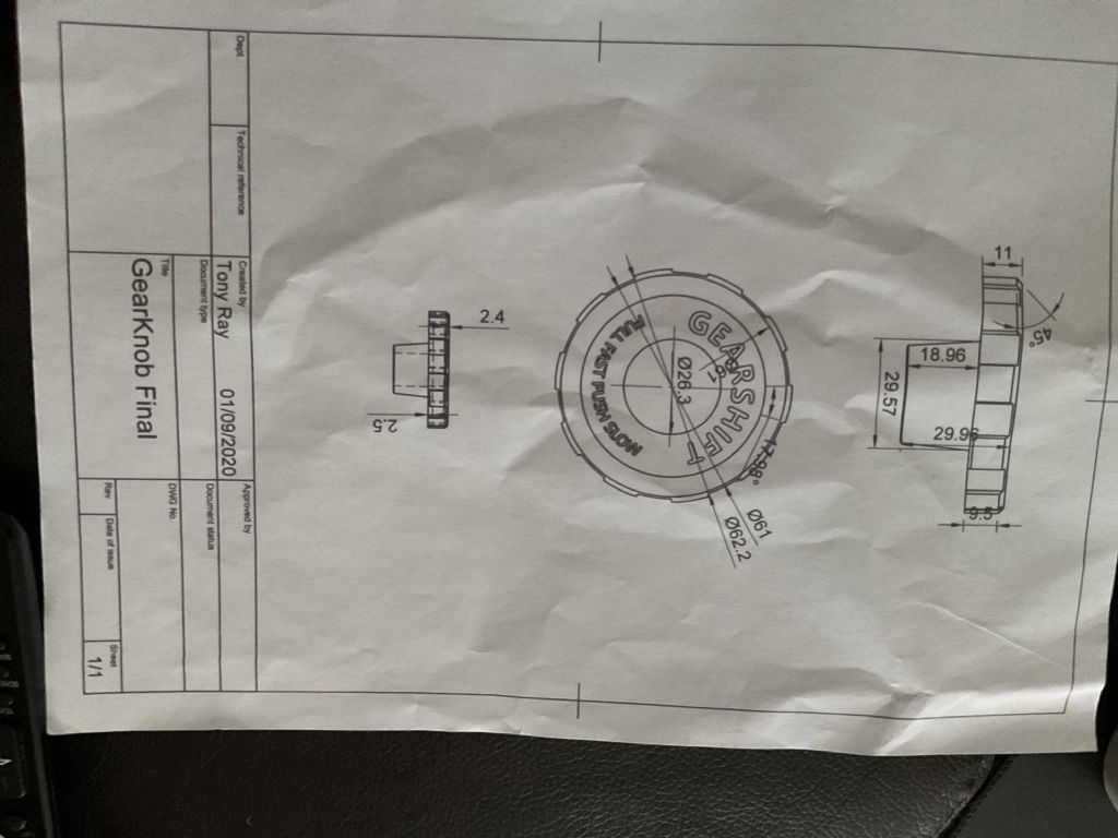

                                    Here is my drawing for the gearshift knob. My intention is to make it from acetal, my friend has a cnc router and the intention is tfor him to do the lettering . It will probably take a few trial runs to perfect, if all else fails I’ll leave it plain. If anyone would like a copy of the 3D model just let me know.image.jpg

                                      Winding handle thanks to Sean’s description I realised I already have one it came with an Elliot shaper vice that I acquired long before the shaper itself. Don’t ask me why the image is inverted!
