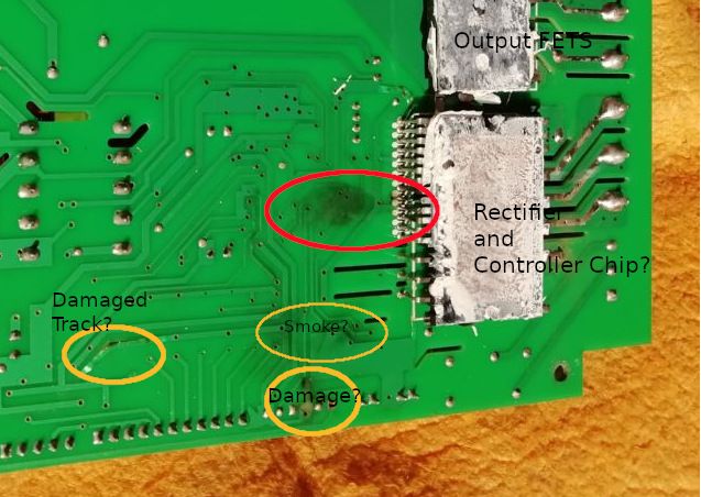

                            Which model Warco lathe is it Kevin?
                            I agree with Martin C (in the VFD / capacitor thread) that the white stuff on this photo is normal heat transfer paste.  I don't see anything suggesting a short to the heat-sink, fingers crossed:
                            Next is more sinister, the white marks on the terminal strip and black marks on the board bottom right near the blue mains filter capacitors look like heat damage. Can't read the label on the damaged end of the terminal, but I guess it's earth. What was the lathe doing when the electrics failed?
                            Can you take a few more focussed photos of the affected area from various angles, and of the other side of the board. With luck the fault is only that the capacitor shorted to earth and burned the track underneath away and that can be fixed by soldering a wire bridge across the gap. But that theory doesn't fit too well with the badly fried switch – whatever did that may have done a lot of damage to the VFD.
                            Do you have a circuit diagram?
                            If it's necessary to replace the VFD at least they're not as expensive as they used to be!

                            #394412
                            kevin large
                              @kevinlarge76611
                              Thanks Dave
                              The end terminal is earth
                              When it went I plugged it in the vfd came on then flicked the switch to start lathe and it flashed and that was it
                              It worked fine day before but was cold in garage and I think the speed was set quite high so don’t know if that’s what caused it

                                    #394496
                                      Kevin pointing out the damage and his new photos aren't encouraging.
                                      On first contact I thought all the damage was concentrated near the earth terminal and nearby mains filter capacitors. Not so!
                                      I'm not familiar with the component I've guessed to be a single combined 'Rectifier and Controller Chip?'. But it appears to be heat damaged in the area circled in red. Also other heat damage, including what might be a bubbled track, in the areas circled in yellow. I think this is 'Beyond Economic Repair', ie cheaper to buy a new VFD than to diagnose and repair, even if you can get the parts.
                                      The combined 'Rectifier and Controller Chip' shorting to earth via the heatsink would explain the damage to the board, but I don't understand what happened to the rotary switch, or how a short on the switch might have done the VFD in.
                                      Might the root cause be the motor, perhaps a shorted winding pulling enough power to fry the rectifier and the switch? John's comment about the need to set the over-current protection correctly might explain all – possibly the VFD was been running in 'Damn the Torpedos' mode, which works very well until something goes wrong! What should Kevin do to confirm the motor is OK?
                                      Edited By SillyOldDuffer on 03/02/2019 13:18:13

                                        #394504
                                        kevin large
                                          @kevinlarge76611
                                          I turned on the power to vfd then flicked the start switch on the vfd via a remote pod
                                          #394505
                                          kevin large
                                            @kevinlarge76611
                                            Oh forgot to say lathe is running fine on another vfd
                                            #394513
                                              Posted by kevin large on 03/02/2019 14:26:01:
                                              Best news so far – it means the motor is OK!
                                              If it were mine I'd replace the VFD and move on.
