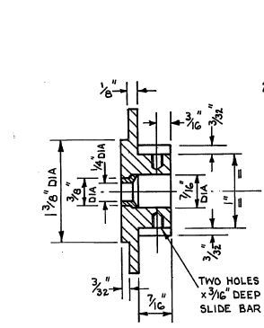

          I am wondering if cast iron would be ok for the cylinder rear cover, I know CI is a good bearing material but would it be ok in this application. Having no piston I am extending the cover into the cylinder to offer more support to the piston rod, it will be running in a bearing length of 22 mm plus the piston gland.
          Its just that I have the CI on the shelf but if it would be better to go with bronze I will have to get some in.
          #432467
          Paul Kemp
            @paulkemp46892
            Ron,
            In your case you can make the gland the bearing, just make it long necked with a step and fit it in the cover. Cover can be anything then, ally of you want! The gland isn't going to have to do much sealing after all with no piston on the rod.
            Paul.

              Or you could do as Fowlers did and put a neck bush into the hole in the cover, a dummy gland solidly fitted would have a similar effect.

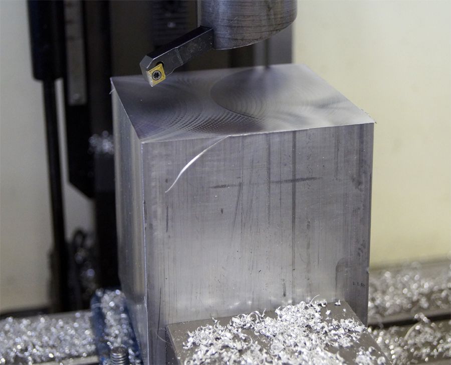

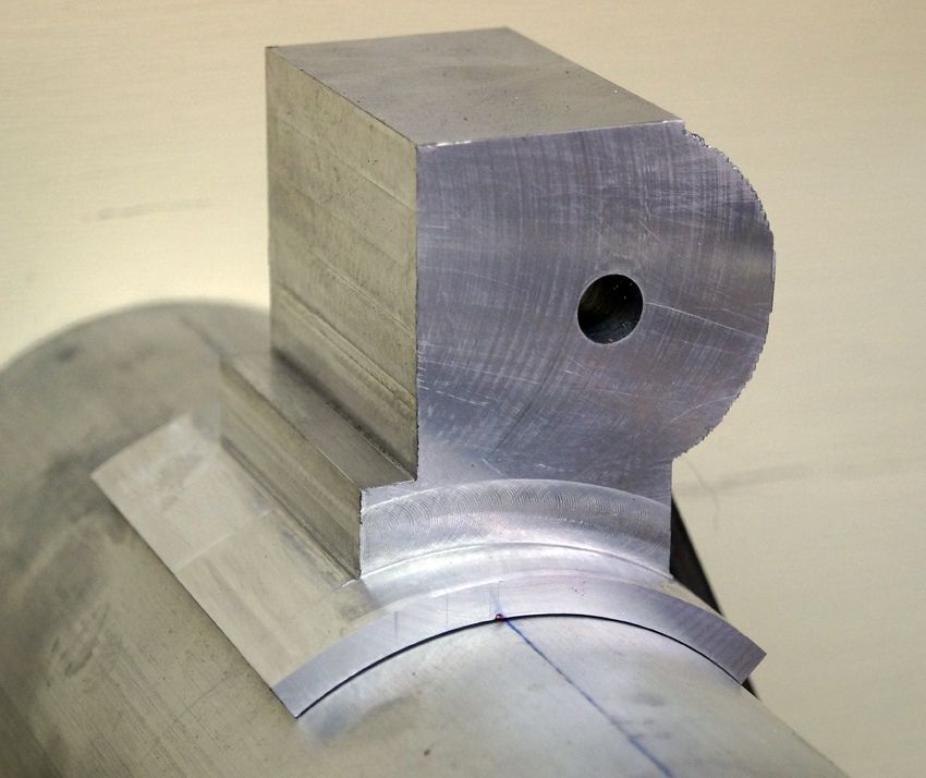

                  The largest lump I have had on the little mill so far, even had to remove the vice jaws to fit it in. Hopefully a one piece cylinder will come out of it. First job reduced the height by 15 mm with the flycutter, faster than back and forth with an endmill. I do most of my fly cutting now with an insert tool robbed from the lathe, works really well. The radius is 45mm which is about as much as I would want to go but it worked, dont think I would go that large with steel, well not in one pass. The slight tool out of balance vibration disappeared above 1500 rpm so I ran at 1750 with 0.030" cuts which sailed through it. I dont have any GT inserts, maybe I should get some and use those for ali.

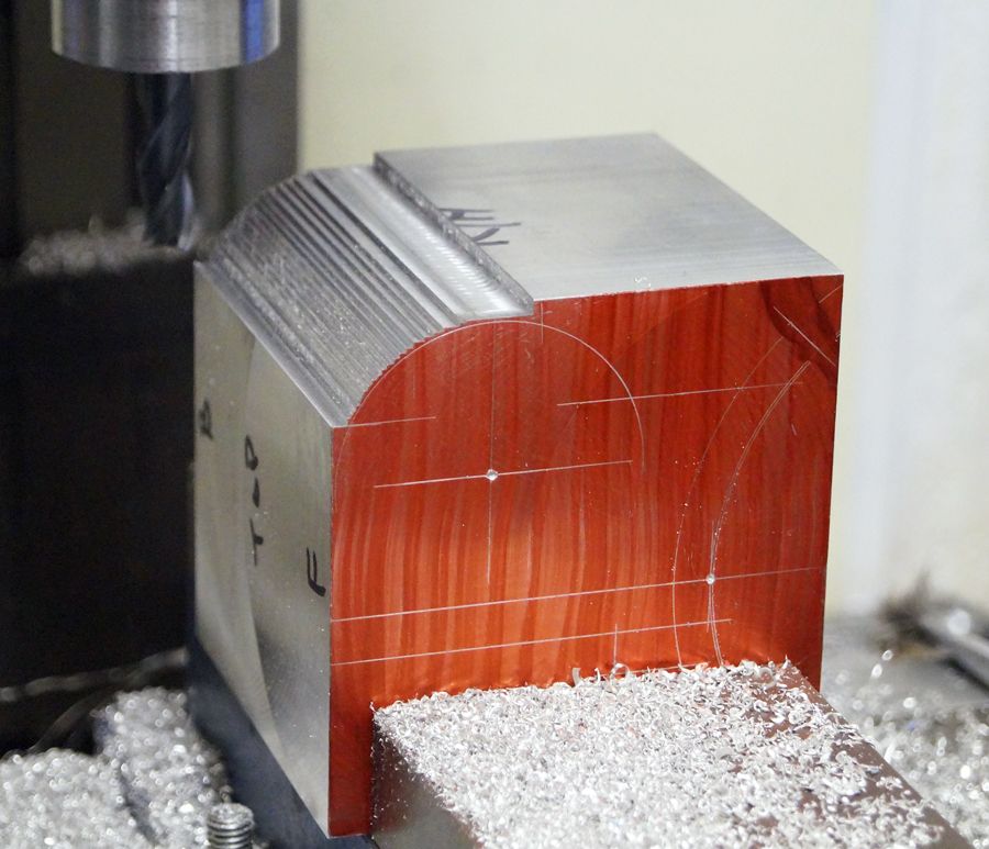

                  #432587
                  Ron Laden
                    @ronladen17547
                    Dont think I will need the rotary table just working around the radius by eye, should blend in with a file ok.

                          p.s. The notch along the length of the left hand saddle is still outside the rad (just) so should be ok when it comes to hand finishing…smiley

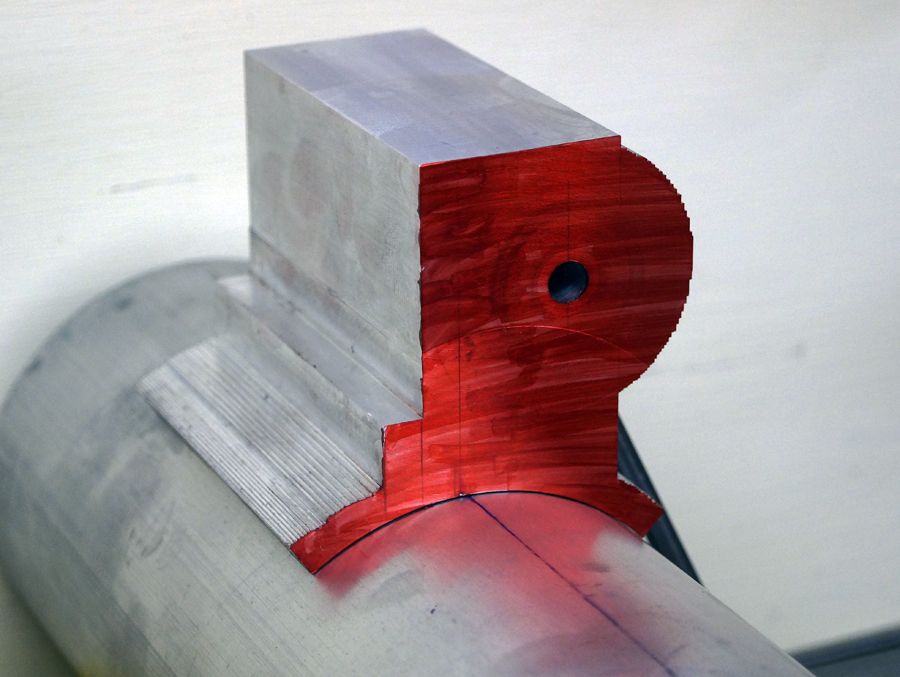

                            Just about there with the one piece cylinder block from bar stock, a couple of angles to mill on the left hand edge of the saddle and then hand finishing. I am glad I had a go at doing this, a few lessons learnt I think and if I had to do another one there are areas which I would do differently. I will be away tomorrow for 3 days so wont get back to the shop until Friday when it will be a case of getting the files out.

                                I have enjoyed making it, though a couple of areas had me a bit challenged but just down to a lack of experience I guess. For the saddle fit to the boiler I have gone with an average of what I measured from the tube, the tube looks fine but its not so true when measured. I havnt checked yet but does the cylinder to boiler have a gasket I,m assuming it does and that will help with the fit.
                                Ron
                                #433305
                                  The minnie has a thin paper gasket, you could also bed yours on Araldite or JBWeld

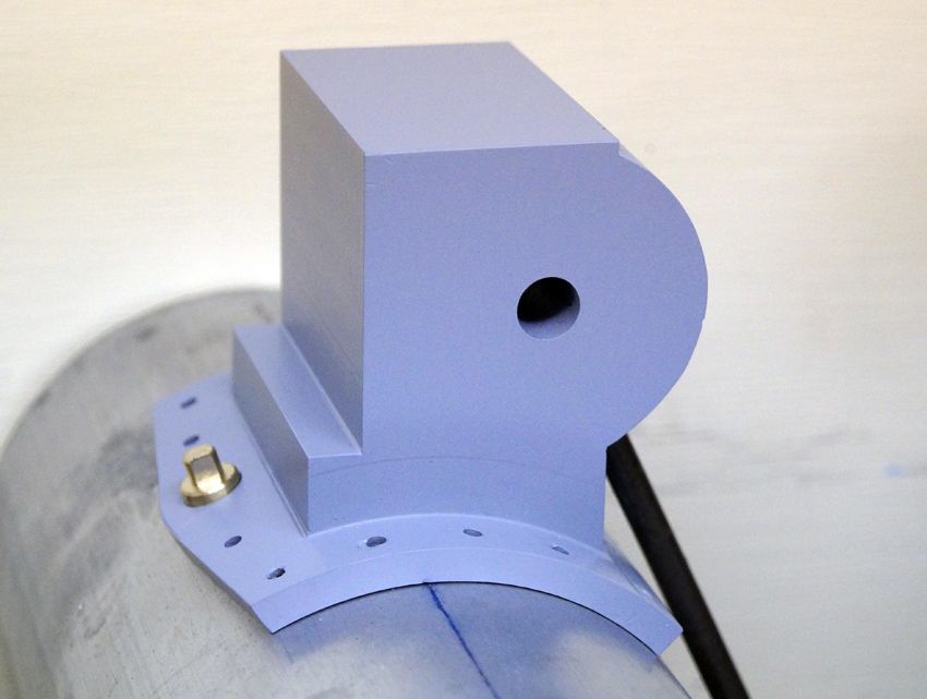

                                    Four hours with the files and emery and its as good as it gets but I,m happy with it, its not perfect in places but thats ok, gives it a bit of a casting look. I have gone with 4BA for the fixing bolts and the mounting holes in the saddle are tapping size ready for spotting through once I know its position on the boiler.

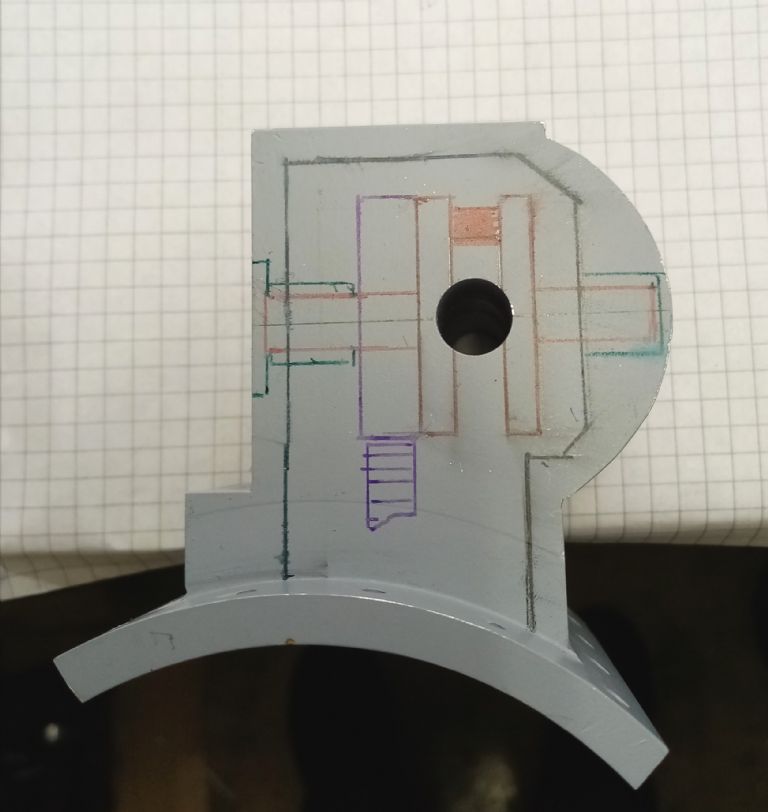

                                                    Having a day off from the 22 so have been giving a bit of thought to the drive on the electric T/E. I was planning on mounting the motor in the firebox and having a 12T gear driving the 80T which in turn drives back through the gears to the cylinder.
                                                    I though it would be great if it could be driven from the cylinder as per the norm but couldn't see how, until I had an idea last night. Now this a bit off the top of my head so feel free to jump in if I am missing something or whatever.
                                                    A picture below of the cylinder with an internal crank drive excuse the sketch on the end but it is just to give an idea. The black outline shows the cavity, the red the crank, the green plain bearings and the purple the toothed belt drive. It would mean the geared motor fitted in the boiler tube with the belt running through a slot in the tube up into the cylinder.
                                                    I must admit it looks a bit small when compared to the actual crank but the motor should be good as should the belt drive.
                                                    Don't know and as mentioned its off the top of my head so any thoughts welcome.
                                                    Edited By Ron Laden on 21/03/2021 11:05:47
                                                    #535213
                                                    Paul Kemp
                                                      @paulkemp46892
                                                      Ron,
                                                      Interesting idea. I am sure it could be achievable but it looks like it would be difficult to assemble. Loadings would be quite high so prone to wear. Personal thoughts is going through the side of the firebox with the gears hidden behind the gear guard would give the simplest and most robust / long lived solution.
