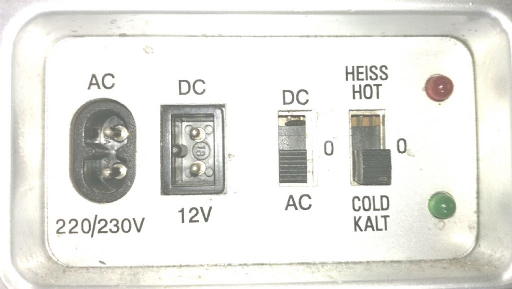

      In the photo there are two plug sockets, one 12v abd one 249v. I dont have a cable for either of them – put them safe somewhere! Is there a generic name for these plugs which would enable me to purchase new ones? Rhe 240v looks just like what we used to use on our casette player back in the dark ages. Thanks. I make steam boilers for a living and this will keep my drinks cool in the workshop so definately on topic!

            The 240v one is a "figure of eight" otherwise known as an IEC C7.

                  Figure 8 240v socket. Need a straight-on pic of the 12vdc socket to ID it properly.

                              Note that the fig8 lead has a little nick out of it between the pins as a polarising key. Some leads don't have this. Of course for AC it doesn't matter so you can modify to fit.

                                    Memory tells me there are two types of this plug, one has cutouts on each side, the other has flat sides. The flat sided one will NOT fit in the socket that needs the cutouts ! Noel.

                                      If you enlarge the photo of the panel posted by Pete Rimmer, above, that shows that this is the Marilyn Monroe shape. I've assumed fizzy's (socket) is the same.
                                      P.S.  The flat-sided one is the shape of the 12V input.

                                        When I lost my 12v lead to my cooler box I used a spare fig8 plug temporarily. I just touched the sides on the belt sander till it slid in the recess & marked one side so I knew which way round to plug it in. I used it a couple of times ok until the errant lead showed up from its hiding place. smiley

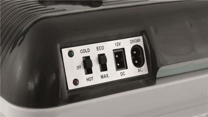

                                            Hi, I think these types of socket are common, below is of one called Wanderer and manufactured by Laurina.
                                            The AC lead won't go in the 12V DC one, unless you do what oldiron did with his lead.
