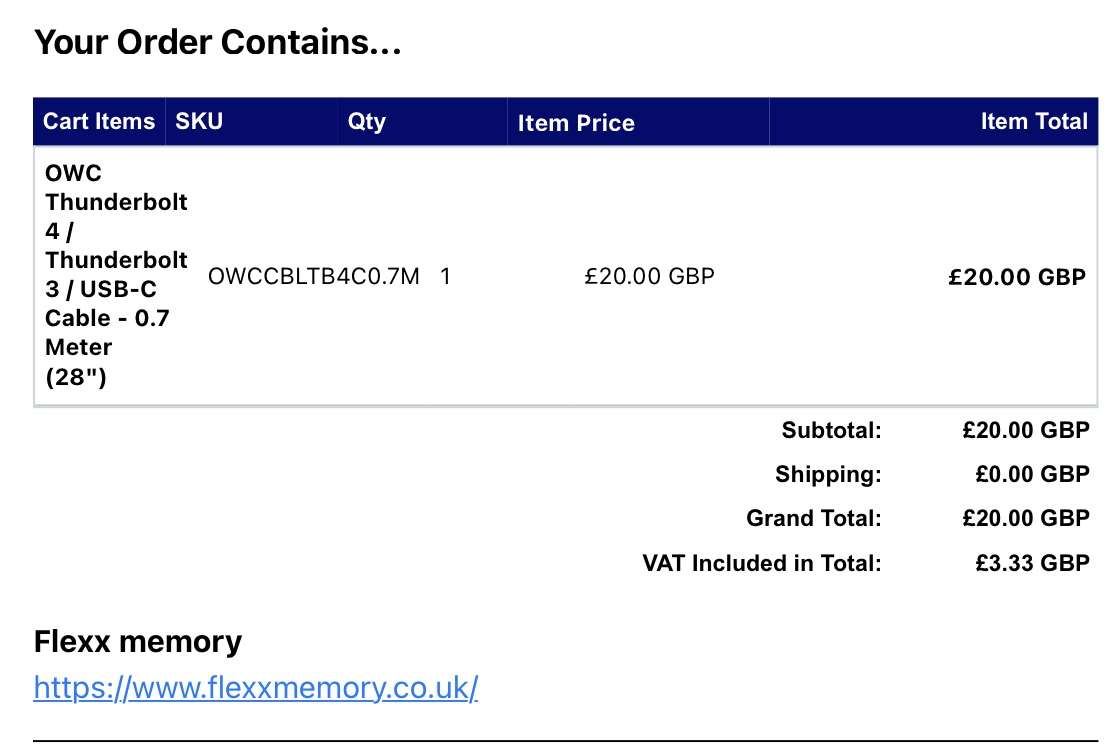

                            On mark smith 20 Said:
                            […] Is there any particuar reason why i cant just buy a female USB C to male cable extension (not sure what type as in 3.1 ,3.2 type C etc…) . The installer , said its not advisable as probably wont work but gave no reason why not. Anyone one knowledgable here that knows about these things.
                            I have looked on the internet and some places say it fine to just use an extension or even a different usb c charging plug/cable  others warning against it .
                            Now that the fundamental advice has been given and accepted, let’s go back to that ^^^ question.
                            Yes, there is a particular reason: Despite all the ‘USB C plugs’ being interchangeable, the cables can be very different in price, construction, and performance:  ‘Thunderbolt’ ports [3 and later]  for example, simply do not work properly with low-spec cables.
                            If the cable in question is only supplying power, then Robert’s advice is entirely sufficient … but when a port as sophisticated as Thunderbolt uses the same plug, there’s a multitude of things that can and do go wrong.
                            Ref. __ https://en.wikipedia.org/wiki/Thunderbolt_(interface)#Thunderbolt_3
                            Edit: __ speaking only as a very satisfied customer: OWC cables from flexx memory are very good indeed [if you need the performance of Thunderbolt]
