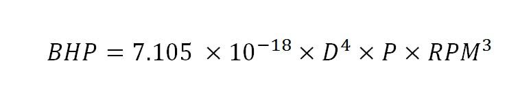

                  Posted by Neil Wyatt on 08/08/2016 14:26:57:
                  I recall reading in an old Aeromodeller that the power figures were got by fitting various different sized props and recording the RPM with an estimate of pitch being used to 'calibrate' each prop
                  This curious equation gives pretty good results:
                  D is prop diameter and P is the pitch, both in inches. It agrees pretty well with some Peter Chinn reviews of various engines. A well as the maximum power Chinn also gives rpm figures for various props and there is some variation between nominally identical diameter and pitch props from different manufacturers. But I think the equation is good enough to give you a warm feeling that your home-made engine is not too dis-similar to a commercial offering smiley
