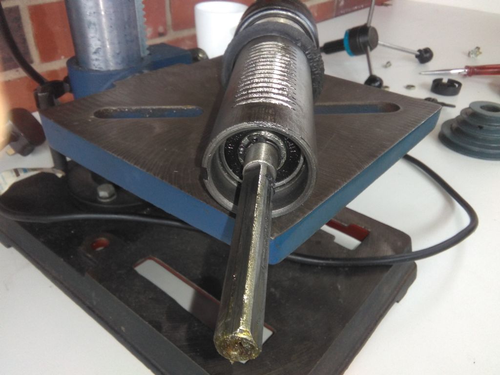

      Neil, I believe I now have drill envey.
      I just checked my original post, glad to see I wasn't actually slagging off all chinese machines, just mine.I guess it's easy to mis-interpret what I actually said.
      So yes my drill is pretty dire, but it has managed to get by, helped by supporting the table from underneath, as it bends slightly even under the weight of a light vice, the noise has been there from day one, not sure exactly where it is coming from but sounds like the bush that the idle wheel is mounted in. Too be honest I was thinking of stripping and renovating it but there is so much play in the quill I doubt it would be worth doing.

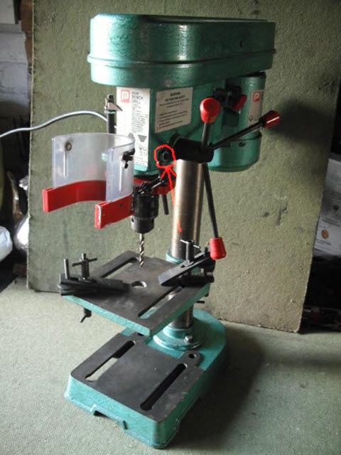

          Here's my drill which I've had for 10 years without problems. The screw and locknut outlined in red, adjust the play on the quill. For heavy duty drilling I support the table with a suitable block of wood. For any thing really accurate, I use my small milling machine. So long as one is aware of the shortcomings of any piece of equipment, one can make allowances when using it. Unfortunately I am not rich enough to be able to afford super accurate toolroom machinery.

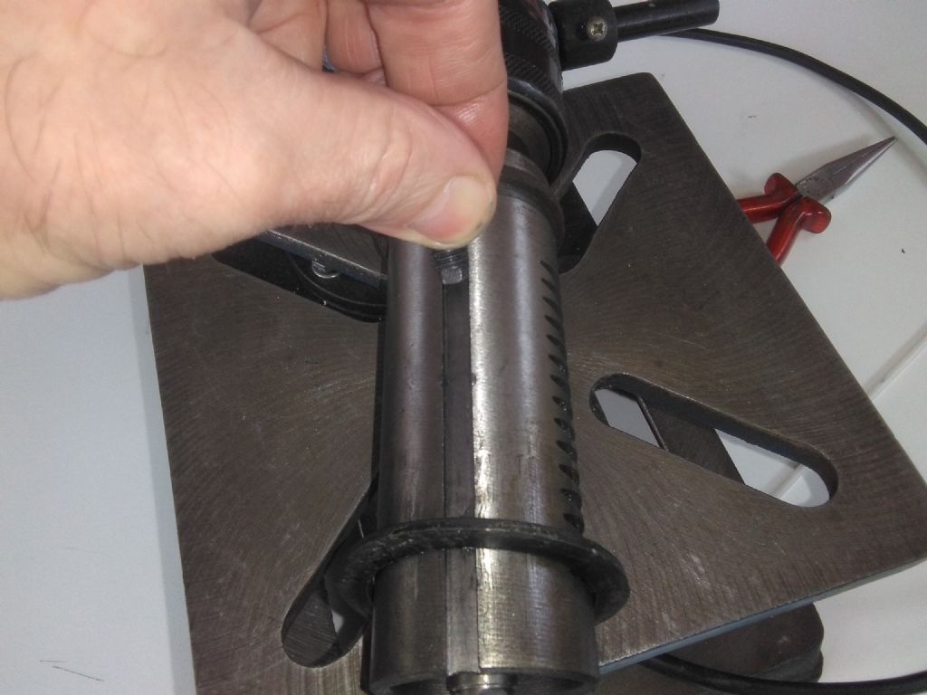

                  OK I gave in, really surprised on two counts, firstly it all came apart very easily, secondly the bearings are actually very smooth and have lots of life left in them.drill bearing.jpg
                  And the reason there was so much lateral play was because the keyway pin has been machined wrong, the pin is oblong and won't engage inside the keyway, In the photo below you can see what I mean and just make out the whitness marks about 1 inch below, where it was binding in the key way, the pin will now be hand ground or filed and re-fitted.
                  Seems like you have all done me a favour as I wouldn't have bothered had it not been for posts, so thank you.

                      I need to rework the quill locating pin as Ian Skeldon 2 has shown above and it will then do me nicely.
