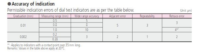

                                For some reason lost in the mists of time I've always believed that the Dial Test Indicator was intended for use as a comparator rather than for taking accurate measurements.
                                I found a Mitutoyo Guide on the web that includes this table, presumably for a quality instrument:
                                I interpret the table to mean that the wide range accuracy of this particular range of DTIs can be out by as much as 0.01mm. Again, happy to learn I'm wrong, but I think this confirms that DTIs aren't the best way of measuring over a distance. In addition, I assume that my cheapo DTI is not as accurate as a Mitutoyo, and is even less satisfactory over a distance.  I would expect a much used quality brand to develop equivalent errors over time due to wear and tear on the mechanism.
                                Consequently I mostly use my DTI for jobs like centring work in a 4 jaw and wouldn't be puzzled by the apparent contradictions in Graham's original post: am I wrong?
