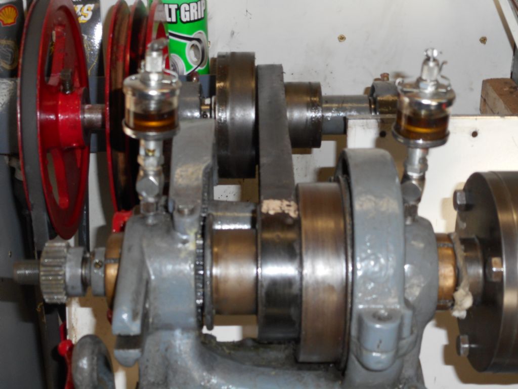

          Hi Bamber here is the picture of my M Type with original mount it may give you some clues. Please look in my albums for some of the mods I think some are essential especially the plug for the bed to stop you fishing tools and parts out of bed casting.
