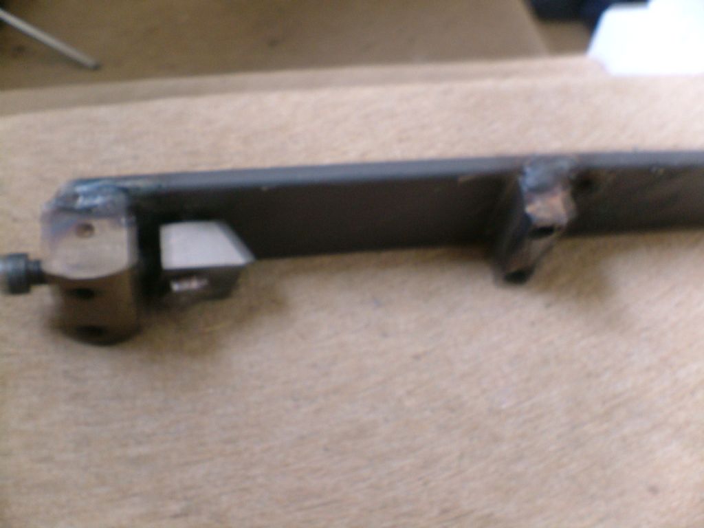

                                      #237851
                                      Hopper
                                        @hopper
                                        My effort at a m-type fixed steady, cut from a piece of 1" plate. Not for the impatient!! It would be smarter to use 1/2" plate and maybe weld on some tabs where the bolt holes are tapped through. The finger bolts are 1/2" (or 9/16"?) UNF grade 8 with bronze tips. It's pretty solid in use.!
                                        And in action, parting a slice off a piece of 2" steel bar
                                        Sorry about the sideways pic. It is right way up in Photobucket but insists on lying down on this page.
                                        I have a Myfrod ML7 steady too but it does not come close to fitting the M type. Would have to hacksaw the bottom half off the casting, make the new bottom half from steel to fit the M and then get the twain welded together by someone with more welding knowhow than I. So I figured it was just as easy to make the whole durn thing from scratch. (That was before performing surgery on 1" plate with drill press and hacksaw and file.)
                                        Edited By Hopper on 07/05/2016 12:46:35

                                            #237915
                                            Ady1
                                              @ady1
                                              The only caveat I would place on Hoppers 1/2" advice is that it may be too thin on the bed and you would need a nice fat base for gripping the lathe bed, an inch minimum IMO
                                              The lathe bed is cast iron and lacks strength under tension (pulling) and you will have some funny forces acting sideways and pulling up the way from the fixed steady and it's ALL acting on the lathe bed ways, so the more metal you have in contact with those ways the safer your bed ways will be from getting cracked when you do a bigger job.
                                              Their original fixed steady may have been deliberately made weedy to protect the lathe.
                                              edit: Nice job there Hopper btw
                                              Edited By Ady1 on 08/05/2016 01:50:28
                                              #237999
                                              Hopper
                                                @hopper
                                                Thanks Addy. I agree on making the base a good 1" wide, or more. On mine, which I made some time ago, I incorporated in the base that second piece that sticks down so the main clamping force from the front bolt is only on the front way. The rear clamp is then nipped up just for good measure. This way, the clamping force is not squeezing the two ways together, which might not be good for the lathe. Although, one of the old designs kicking around from Duplex or someone of that era says that they did not use this feature and it did their lathe no harm over many years of use. But the base was 1" or so wide.
                                                I see my lazy pic has righted itself. Aint technology wunnerful.

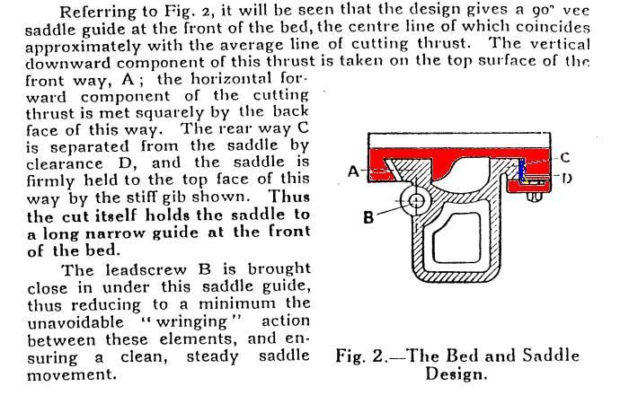

                                                #238023
                                                Ady1
                                                  @ady1
                                                  Hoppers design is the way to go. my lashup is missing the critical central bit for serious work
                                                  If you look at the ways in the manual I have highlighted the drummond system in red
                                                  The left hand side "grips" the left hand way on BOTH sides while the right hand side way section tightens to the underside of the bed
                                                  There is a small clearance at D which I have tried to highlight in blue
                                                  Edited By Ady1 on 09/05/2016 10:10:48
