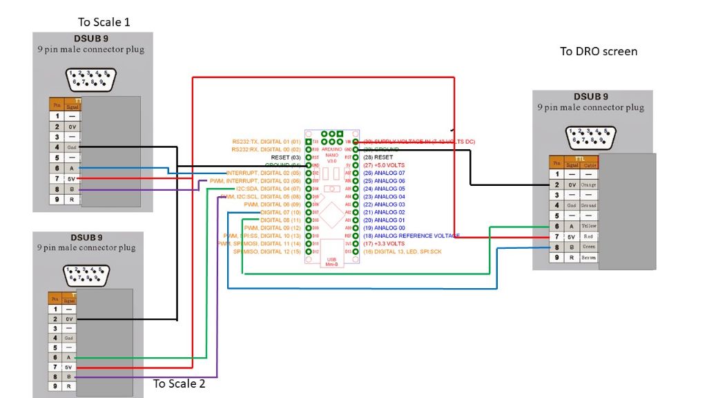

      Hi all,
      I've recently added a Ali-Express DRO to my Archdale 18" Mill. I was facing the problem of only having one Z-Axis and not knowing whether to attach it to the knee or the quill, so I bought a 4th glass scale from the seller and added a scale to both axes.
      The DRO display only has one input for each axis, so I got an arduino nano via ebay along with a small enclosure and some RS232 cables. The two input cables attach to the scales and the output goes to the DRO display. The arduino calculates which scale is moving in which direction, sums them for an absolute position and then outputs that to the display so both the knee and quill can move in opposite directions at the same time and the DRO Z-position will remain correct.
      Component parts came to about a tenner + labour time of assembling it and figuring out the code. It's possible to move the scales fast enough to out-pace the arduino and 'lose' steps, but my scales are 1 micron rather than the usual 5 micron so that's effectively limiting the maximum speed by 1/5th and even at that it's still capable of keeping the position correct up to about 100mm/sec so as long as I keep the quill retract speeds sensible I think it'll be okay.
      The arduino gets its power from the 5V output pin on the DRO which supplies the glass scales, so no batteries / plug is required.
      I'm an absolute amateur when it comes to the arduino stuff so it may be possible for someone to make the code much more elegant / run much faster but this does me for now.

        #406587
        Kealan O’Carroll
          @kealanocarroll32466
          Code here:

            I'm impressed Kevin, good idea and clever implementation.
            Just a thought, the bit twiddling to drive the output makes the logic harder for others to follow and may not be necessary in this application. I suspect the main performance bottleneck is the Nano only having two external interrupt pins slowing the encoder library down. Likely the hardware and library are stopping your code following very fast traverses rather than your high-speed implementation. Might be possible to compute the output slightly faster, but I suspect switching to a processor with 4 external interrupts (like the Mega) would rocket propel the whole thing.
            Have to say I'd be unbearably smug if I'd got that to work – well done you!

                          #407788
                          Kealan O’Carroll
                            Hi chaps,
                            As Les has said, the wiring is in the comments of the code, but Ive put a diagram below.
                            As per Dave's comment you might be better off with an arduino mega or something with 4x interrupt pins if you want it to run faster
                            #517620
                            David Tocher
                              @davidtocher94033
                              I've just completed adding the quill scale to the column scale. It ran without any problems except it required a change in direction. I am using 5 mincron scales and it counts correctly even when I release the quill handle.
                              The pictorial wiring schematic does not correspond with the comments in the sketch and I used the connections in the sketch.
                              Thanks for your contribution.
                              #535998
                              ronald bakker
                                @ronaldbakker48084
                                hi all , new guy here , have bought a three axis dro and have been looking at the idea of the axis combiner to give the the columb and the quill a shared z axis on the dro
                                i cant seem to find the sketch david is talking about and i am slightly worried with how the ground lines are hooked up on the schematic
                                scale one and the plug going intoo the dro has the ground (pin 4) hooked up to the ground tab on the arduino
                                but scale two has the zero (pin 2) hooked to the ground on the ardiuno , is this correct ?
                                have all the stuff needed here to make one but dont want to make a misstake soldering the thing up and after plugging it in release the magic smoke
                                #536013
                                David Tocher
                                  @davidtocher94033
                                  A 'sketch' in Arduino-speak is what I'd call a program. The comments at the start of the program/sketch and the schematic wiring diagram (called in Arduino-speak a 'fritz&#39 contradict each other in a minor way.
                                  I used the screen in the SUBD9 cable from the display unit daisy-chained to the screen of the cables going to the scales, making sure there were no possible loops which can pick up hum.
                                  Provided you don't do anything silly like connecting the 5v to ground I don't think you can do any damage. All the Nano connections to the scales are inputs and, I'd guess, the pins on the display are also inputs and the worse that can happen it won't work!
                                  It's been working fine for a while and I'm very pleased with it. Using DRO on the mill makes things so easy and now being able to raise or lower the quill to change to/from cutter and drill chuck without losing the Z position is great.
                                  Again thanks to Kealan for his efforts.

                                      #536065
                                      David Tocher
                                        @davidtocher94033
                                        Ronald:
                                        I'm not sure which pins you are referencing. There are at least two different SUBD9 pin-outs from/to the scales/display so the connections need to be checked for your setup. The website or manual should give the pinouts but . . . .
                                        My display unit connections on the SUBD9, which are all that I used, are
                                        pin 2 0v
                                        pin 6 A+
                                        pin 7 +5v
                                        pin 8 B+
                                        Pins 6 and 8 are the two quadrature signals and the other pair the power.
                                        There is a PE (protected earth?) connection on pin 4 that is connected to the screen but I don't think it's a good idea to use it for the power because of the risk of earth loops which can cause electrical interference.
                                        I rewired the plug from my quill to match the X, Y and Z plugs so they are all interchangeable. The screen is not connected to 0v wire anywhere external to the display unit but does contact the metal case of my Nano box and the screens of the two Z scale cables.
                                        #536078
                                          Posted by ronald bakker on 25/03/2021 13:17:15:
                                          Posted by David Tocher on 25/03/2021 12:45:24:.
                                          ok so it doesnt matter if i use zero (pin 2) or ground (pin 4) to connect the power out from the dro to the scales and the arduino ?
                                          It might. Although 0V and Gnd are the same on the Arduino, they may not be on the DRO, which is providing the power. Makes sense for the DRO to put power between the 0V and 5V pins, but the Gnd could ba just a cable shield. As shields are often only connected at one end to prevent earth loops, the Gnd pin may not complete the circuit Try it and see – no risk of smoke because the Nano just won't power up if the DRO Gnd pin is floating. Or test it with a multimeter.
                                          Electrical safety earths, signal earths, and RF earths are all a bit different, but as a rule of thumb it's not a good idea to carry power on an earth line. So if a plug has a 0V pin, use it, not Gnd. However, just to keep us on our toes, printed circuit boards often label the 0V line as Gnd, Vss, or other things. The Nano is an example of 0V = Gnd.
                                          #536090
                                          ronald bakker
                                            @ronaldbakker48084
                                            guess i connect the shielding together to prevent radio interference and connect the 0's together and to the zero on the arduino board , that way all the cables are hooked up the same way (to the dro unit) and the power side from the dro side will power the arduino like it does on the schematic so it should work the same way as a single glass scale would
                                            thanks for youre help i apreciate it

                                                  #define ENCODER_OPTIMIZE_INTERRUPTS
                                                  #include
                                                  Encoder scale1(4,2); //Wire first scale A & B quadrature lines to arduino Pins 2 and 4
                                                  The error is that the name of the file to be included is missing. It should probably be:
                                                  #include "Encoder.h"
                                                  In C/C++ the #include statement causes the content of another file to be inserted into the source code. In this case it contains the library code defining the Encoder type, and because the definition is missing, the compiler doesn't know what Encoder scale1(4,2); means.
                                                  Encoder.h may have to be installed using the Arduino IDE's Library Manager. If so, have a read of this.
                                                  #536361
                                                  David Tocher
                                                    @davidtocher94033
                                                    I'm a bit puzzled as to why you need to cut n paste – apart from the missing 'include Encoder.h' it work for me just copying the code given by the author.
                                                    As an aside to the moderator(s); can a section be created for code like this so folk can upload files to a common area? It would allow the file to be downloaded rather than copying a posting. It's easy to miss characters or even the top or tail of the text.
                                                    #536379
                                                    ronald bakker
                                                      @ronaldbakker48084
                                                      youre both right , i can cut and paste i just need to erase wats allready in the sketch at the startup of the program , and indeed i needed to load encoder from the library
                                                      it now compiles without problems , just doesnt load it intoo the arduino , tried all the com ports , one is responding a little quicker in saying it cannot reach the arduino but nothing else is happening
                                                      it cannot read the arduino either , the arduino might be broke (thats my first hunch as i kindah messed with it a little during the soldering )
                                                      so i will buy another one and compile that before i start laying the solder down but if you guys still have ideas i hook it back up and give it a try
                                                      i allready followed the tip of the program and tried the old version (before 2018) no such luck
                                                      could there be a possibility that the arduino is empty and needs to have sumting loaded on it before loading the sketch ?
