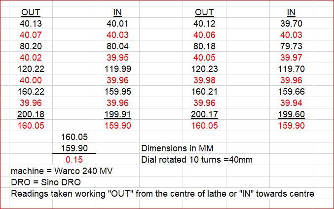

      having a Machine Dro on my mill & being very happy with it I decided to buy a DRO for my lathe. I baulked at the cost so bought a Sino Dro at £299-00.
      Not so nice to read & already I wish I had gone to the same as I had bought before, but too late now.
      So my first task was to machine 5 bronze bushes for my boiler. Each one 12mm with a 13.5 mm shoulder. A simple operation. I expected to take a cut on the bronze , measure it with the micrometer, set the dro at whatever size ( say 14mm) then simply machine to 12mm.
      No such luck. On all 5 bushes, Whatever I tried I never achieved the 13.5mm or the 12mm. Each time I came out under my required size.
      I made sure that I locked the cross slide for the final cuts,So I began to suspect something wrong wth the DRO.
      I decided to wind the cross slide in and out the full width & see what readings I got at 40mm intevals. 40mm being 10 turns of the dial & easier to read zero after each set of 10 turns. I turned in one direction only to avoid backlash
      Below are the readings I obtained. The red figs are the differences. One will see that moving out from the centre the reading differences are different from those going in towards the centre. In only one case do they read 40mm. Also the overall dimension one way is 160.05 & the other way is 159.9. That makes it difficult to decide whether to calibrate the scale ( I think there is a facility to do this)
      So why am I getting these differences? I can accept that I can get a bit of a difference if I do not read the dial perfectly ( Surprised at that though) but is it the screw on my cross slide being out or the scale on the DRO being imperfect?
      is this sort of thing normal with cheap DRO's & can I ever expect to machine anything acurately on my elastic chinese Warco & my cheapo DRO
      Edited By Sam Longley 1 on 25/10/2020 09:03:20

          I'd use a drop clock and check against that,. At least then you establish where the error lies.

            Could you mount one of the scales from the lathe on the mill and compare the two?
            This would eliminate any errors from reading dials or tolerances in the screws.

              However, my immediate reaction to your boring undersize, was spring in the boring tool. Did you take at least one spring pass on arriving at the measurement – because that may be the problem. Sorry if I'm teaching you to suck eggs here but just a thought….

                Chuck up a piece of bar (say25mm) take a small cut and measure the result. Set the DRO to zero and then take a second (small) cut. Measure again and compare the measured size to the DRO size. carry on in this manner (without resetting the zero on the DRO) See how the sizes compare. This will show if the DRO has a problem and eliminates any leadscrew or backlash issues. Remember to lock the cross slide each cut. Watch to see if the DRO changes size before/during/after each cut as this indicates a locking problem.

                  You are working with 2 possibly questionable components [cross slide screw & or DRO], I would use a decent DTI & slip gauges to check things out but you may not have them? You need to use some thing of an accurate size to measure the DRO readings against.

                    1. Bronze is more awkward to cut, steel would be a better test.
                    2. It's better to check movement against a dial gauge not the lathe dials.
                    3. It could be mounting bracket slack or the scale may not be dead parallel to the cross slide travel.
                    4. Does the reading change when you lock the cross slide?

                      Strange! Inconsistent errors. This is where slip gauges are a help
                      1. Carefully check all the mountings fir movement also the x slide screw, thrust bearing and the nut ( unlikely but it’s for elimination while you are at it, check the gibs) check there is no movement on a dti while the x slide is being locked
                      2 clamp a block of known size say a 321 block with a bar of flat clamped to it extend beyond say the headstock end So giving two test faces in the same plane
                      use a dti to set it parallel then feed in to zero on tthe block with the dti then zero the x slide dial n DRO. Check on the clamped bar. After a small movement to clear with the saddle
                      this will check the DRO and the feed screw

                        Zero DRO, grab hold of the toolpost and then as hard as possible push it in, record reading, pull it out, record reading.
                        Seems to me that the screw or nut are loose somewhere?

                            I did try steel when I first fitted the DRO but thought it was just a learning issue.
                            My dial gauge will only give  max 25mm of movement & I would not be able to use the full 25mm, which is not a lot but I will try that- thanks
                            The scale is fitted to the cross slide so must be parallel & no way would it move, I am confident of that !!!
                            I lock the cross slide at the reading I want. it does tend to move whilst doing that, but there again there is always backlash in the cross slide, so one might expect the tiniest movement- or would one? I just make sure it is locked on the DRO reading i want. I also check that it does not move thereafter.
                            What I do not understand is why the measurement reads consistently 159.90  one way & 160.05 the other way.

                              If you ignore the DRO and only use the cross slide dial, do you then get repeatable diameters that match the cut you have applied?

                                    Hi Sam, you are also comparing two sides of your screw/nut combination and there is the possibility of there being slightly more wear in one direction than the other, other factors to consider are the thrust bearing parts of to screw and drag on the dovetail slides can vary in one direction to the other by very slight movement in the gib of even due to wear/bedding in. As has been said, the only way is to check against a good DTI or a known good readout, mounted rigidly.

                                        Generally even cheap DRO's measure accurately (within their design limits). One thing that might cause Sam's symptoms is the scale and head not aligning properly. Although the fit isn't super-critical, if the head presses against the scale at any point as it traverses, the scale bends slightly and readings pop to and fro as it flexes. Make sure the scale and head are fitted to the lathe so the head runs freely.
                                        As fitting DRO scales can be awkward due to obstacles, their alignment can be compromised, and tiny movements show up. Don't ask how I know…

                                              I will say that if the scale is not absolutely parallel to the movement of the slide then there is a (very) strong possibility of an error in your readings.
                                              We had a Dro fitted to a large lathe and the big shafts we were machining were giving problems with errors. On checking the cross-slide scale we found a 0.05mm error on the alignment the DTI from one end to the other. The supplier assured us that that amount would not matter but when the service engineer came along we were able to prove to him that it did. He said that most crossslides were much shorter and any error would not show up.
                                              So very careful alignment is uaually the answer!

                                                  Problem against that is that if I machine a diameter of 13.5mm & set the DRO then machine a step to 12mm ( In stages) the difference should be 1.5mm regardless of the dials. Currently it is not.
                                                  I have , this morning machined some steel pieces as smooth as I can get them, each with a step of a diameter recorded on the DRO. Tomorrow I am taking them round to a pattern making friend & asking him to verify the dimensions with his micrometer. I want to make sure that I am measuring the diameters correctly. . I have also used a dial gauge on the end of the cross slide & that varies with the DRO depending where along the slide I am reading (ie near the centre or well out from the centre) .
                                                  I am confident that the scale is parallel. It is only 150mm long & It showed no error on a dial guage
                                                  Although the lathe is 6 years old it has had little use.
                                                  From your comment above I put the dial guage on my mill table & over 20mm it matches the m machines DRO perfectly on both X & Y dimensions

                                                    It's very easy to force a reading a few thou smaller than it really is.
                                                    So the DRO and dial gauge both agree, do the machine dials also agree?
                                                    It's possible that cross slide screw varies along it's length, or your centre height is not spot on so the tool digs in a little.

                                                      No!! I said that the DRO & dial gauge do not agree. The difference depends on how far i am out from the centre
                                                      To be honest in the end the dials do not matter. They are just a method of checking. If i can measuer a diameter with the micrometer then set the dro to that measurement I would expect to just turn the dial until the DRO gives the reading i want. That way all backlash etc is eliminated. Trouble is it is not happening & it is not happening in a linear fashion so I cannot simply re calibrate the scale & i do not know why.
                                                      I just wondered if others had a similar problem & how they solved it. It may be that they have not actually noticed it or if they have they have not bothered & just adjusted for it as they went.Seems a waste of a DRO if they have though.
