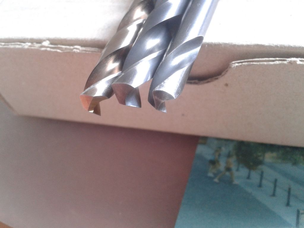

                  Philip Burley
                    @philipburley44197
                    I had this trouble drill bronze , A friend re sharpened my drills and since I have had no problems , Some of the new 2.5 mm drills were very poorly sharpened , but they were cheapo ones
                    regards Phil

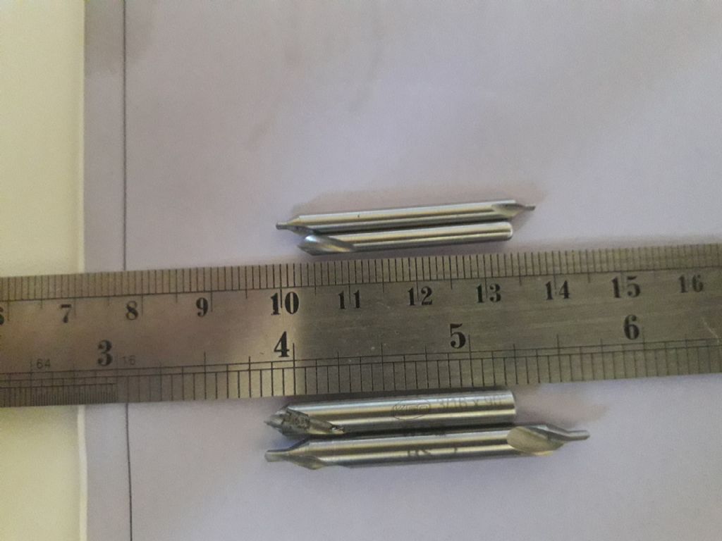

                              #429354
                                I've been using spotting drills for the last 5-6 years and only use my ctr drills for where ctr support is needed of conical holes for pipe fittings. I get away with just two sizes – 1/8" and 3/16" though have just recently bought a 3mm one for the CNC as I only have metric collets for that.
                                The cut across the whole width of the flute hence why thay can be use das a combined CSK or deburr prior to drilling the actual hole and can stop soft metals raising up around a tapped hole. You don't have to go that deep with them, think like a large 90deg ctr punch for starting drills so long as the "flat" end of a jobber drill fits into the cone shaped recess it won't wander.
                                Couple of 1/8" HSS ones here, one of the right is my prefered brand with web thinning that means the "flat" end is very small, both cast about £3. Carbide one I bought recently is even more pointed. It was also half the price of a similar size ctr drill from the same supplier.
                                Not really stocked by ME suppliers though I have suggested it to Ketan a few times but any industrial supplier will have them and all will sell to public,
                                Edited By JasonB on 17/09/2019 14:16:56

                                    Vic
                                      @vic
                                      I agree about the use of spotting drills but do any of you know why they are so long? I’ve been thinking of cutting a couple down to make them even more rigid.

                                        #429366
                                          Posted by Vic on 17/09/2019 15:19:09:
                                          question
                                          Don't think I would be left with much to hold mine by if I shortened them and certainly could not use then when say spot drilling something in a spin indexer. I only use the pointed end of mine so don't by long reach ones. Ctr drills included for comparrison
                                          Edited By JasonB on 17/09/2019 15:27:27

                                            Ian, try some long ones
                                            #429371
                                            Ian P
                                              @ianp
                                              The slocumb bits in your picture both look to be longer than ones I usually see, I have some very long centre drills which are useful occassionally but I have seen some of the larger sizes 3/8" / 10mm or so where the flutes from either ends would run into each other except for the fact that they are rotated 90 degrees. They might be rigid but dont seem designed for gripping in a drill chuck.

                                                  You do need to read the drill lengths, those two spotting drills there would be about 10mm long if you went by the picture in the catalogue.
                                                  Yes long series Ctr drills good for things like valve guide sin the end of valve chests, pairs of bearing housings I have them upto 4" long though easily damaged. Will possibly add a LS spotting drill to an order some time.
