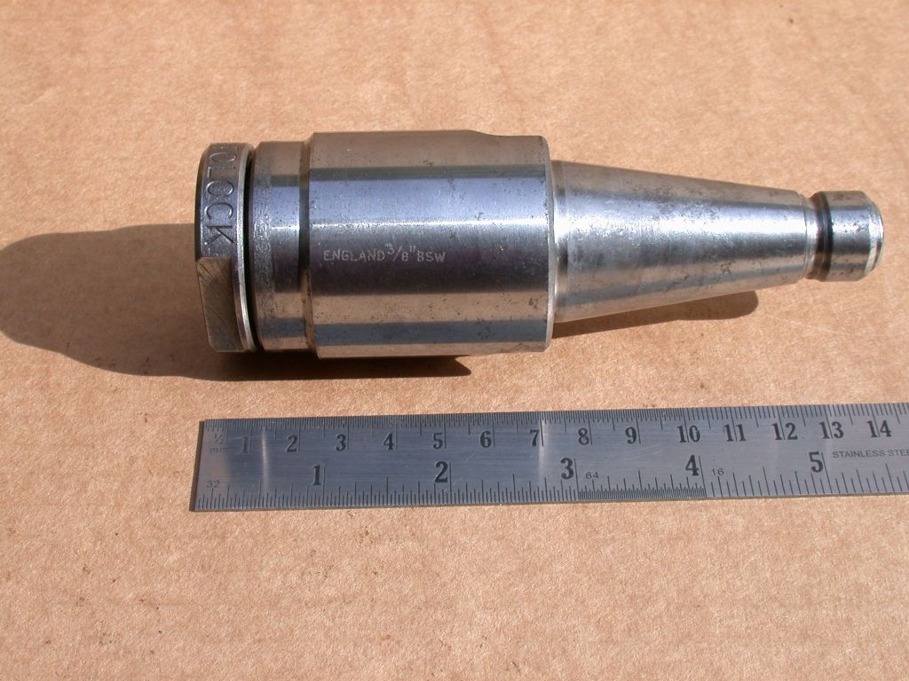

                          The drawbar thread is often etched on the body of genuine Clarkson holders, can be hard to find and read though! If it is metric it usually has a groove machined at the drawbar end

                            "The drawbar thread is often etched on the body of genuine Clarkson holders"
                            Like this one:-

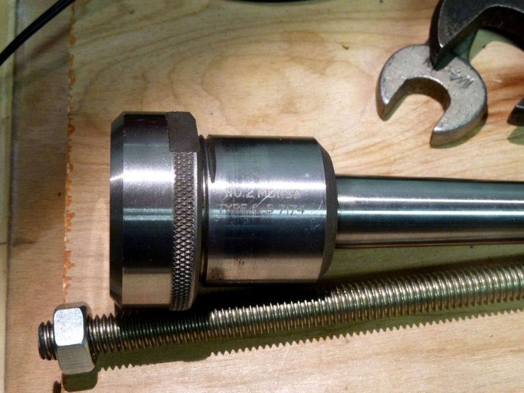

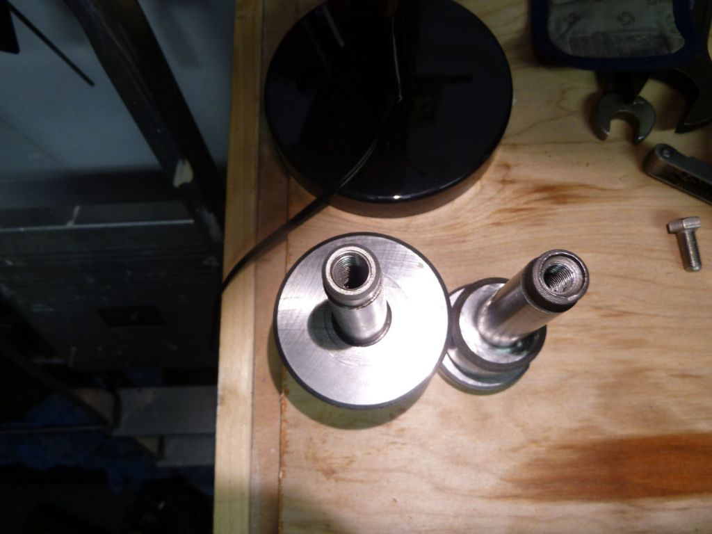

                              Many thanks for the responses to my original enquiry. I’ve managed to get back into the workshop today. I’ve attached a photo of both my 2 MT Clarkson auto lock milling chucks. The one on the left is an “S” type. The “S” type is 3/8 BSW. The “unknown ” has CS 7174 etched on the body. Using a drill bit I’ve measured the “core” of the unknown thread, and arrived at 17/64” (0.2656&rdquo ie a 5/16” thread It is not BSF as I first thought (I couldn’t get a BSW bolt to go more than a thread) . Having looked closely, through a magnifier , I found and picked out the damaged thread. I can now get a BSW tap to go the full length of the thread. I’ve just ordered some 5/16 BSW threaded bar!
                              Tony
