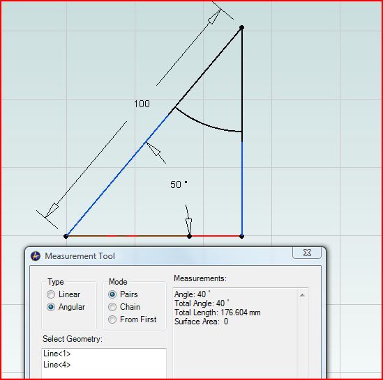

          How much don't they match by? could it be the complementry angle of 40deg that you need?

                It really comes down to the surface you measure from or the angle of the part in relation to the cutter.
                For a triangle with one corner at 90degrees, the other two angles must also add up to 90. If one know one angle in this case your measured 50degrees then the remaining angle is called the complementry angle so 90-50 =40.
                You can see here I have drawn out the triangle, the long hypotinuse is 100mm as per your sin bar and angled at 50deg. The measuring box is measuring the angle between the two black lines and shows 40deg
                It probably comes down to measuring the angle from a horizontal surface but setting it up in the mill with a vertical cutting edge.
                Another time this often crops up is where people try thread cutting and set the topslide to 29.5 deg from the lateh axis when it should be 29.5 degrees from a line at right angle sto it so the angle scale on teh topslide should really show the complementry angle of 60.5deg (90-29.5 = 60.5)

                      Hi Jon it's 50 no mistake but trying to find a dovetail cutter to match is a PITA it needs to be a 30mm cutter also, Jason was right the with complementary thing.

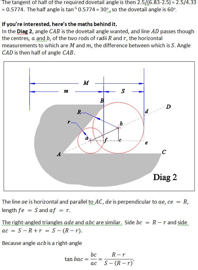

                      Gary Wooding
                        @garywooding25363
                        #273454
                        pgk pgk
                          @pgkpgk17461
                          The math way will be accurate but the lazy person stuffs some milliput (epoxy putty) surrounded by clingfilm into the dovetail and then uses a protractor..

                          Les Jones 1
                            @lesjones1
                            Hi Gary,
                            I've neither seen that method before or thought of it. I will have to remember it for future use. I like it.
                            Les.

                                                  If the actual angle is needed the bars are the best answer but I'd use a mic as there's less chance of it being at an angle giving the wrong answer. That can be a problem with the milliput.
                                                  Might be best to blue it afterwards to check. One way of doing this sort of thing is to use the same cutter for the mating parts. That way the angle will be the same. Or should I say can be.
