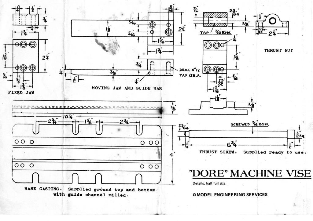

              I think I have one of these kits, which someone else started, in the attic. As far as I remember, only some initial smoothing of flat castings had been done.
              I have found the instructions and drawing in the more comfortable environment of the bookshelves!
              Viz:
              dore machine vice001.jpg I had to put it in the attic when I saw how they had spelled "vice"

                                    To get back to Derek's original request my Dore Westbury vice is as per Robbo's drawing.
                                    In retrospect a proper machine vice would be of far more benefit. As Robbo comments the original design has very low jaws and profile.

                                      These were done as a kit of parts in an era before we had cheap imports and MES were one of the first to cater to the hobby.
                                      A fair bit of thought was put into these vices by Ivan Law given they were made for the Dore Westbury which other than the Tom Senior and the first influx of the very badly made Rong Fu's were the only machines a Model Engineer had access to other than the vertical slide on a lathe. Even the Amolco add ones were very expensive for the day.
                                      They were made low profile to fit the DW mill as most model engineers are only working with small lumps but the nice design was the tongue on the moveable jaw that slid under the fixed jaw to stop lifting.
                                      Even today, size for size not many small vices can match the MES vice for capacity given it's size.

                                            If castings can't be found a version glued'n screwed together from stock sections looks pretty easy to sort out if chomping the base from solid is a bit too much for your mill. Obviously you still need to machine all mating surfaces for accuracy and good fit but it doesn't seem a major chore.
                                            Do it the neat freak way with countersunk socket heads from underneath into blind holes doing the screw bit and who is gonna know without a close look. I'd not be doing with short blind holes. Just run right through and knock the protruding threaded ends off during clean up machining. Probably need to be a bit thicker than the original, maybe 1/4" to 3/8" to get decent thread lengths and screw seats. Which hardly seems a major issue.
                                            Screw in tension of course, pulling from the back, with decent cleanly surfaced and well lubricated thrust washers. Not jut run on the body. Needle roller thrust washers without the needles work well being noticeably smoother than a simple machined step running on the body.
                                            If you do make one from scratch seriously consider making it replaceable jaw style with a stash of soft ones and a couple with Vees in horizontal or vertical planes. But do them when you make it! Soft jaws for my machine vices would be easy to do but I never get round to making a stash and no time mid job so always work-around and second best solution time.
                                            The major issue with the Dore Westbury design compared to many conventional vice designs is that there is no central aperture so drilling through holes is pretty much out. But it's lower profile, very resistant to jaw lift and much wider opening. Yer pays yer money and makes yer choice.

                                                  John Stevenson advocated the benefits of the original vice, but I think John might also accept it's limitations. The very shallow depth of engagement on the shallow jaws is useful for small jobs. But for bigger jobs a bigger proper machine vice is needed.
                                                  The Dore Westbury has a long X axis, but this is negated by the original vice for lots of common operations.
                                                  So you want to do forked ends on an eccentric rod (sorry John for mentioning miniature steam locos). You clamp the rod in the original vice, and there is then insufficient Z movement to do the milling.
                                                  Most cylinder blocks for miniature locos require great ingenuity to mill the port faces and ports using the original vice.
                                                  In most cases a proper machine vice would resolve all these problems.
                                                  I havent found the moving jaw to be particularly 'precision' in operation – but perhaps mine is worn after 35 plus years. I have to add a bit of shim under the moving tongue underneath the static jaw.
                                                  On the bed is a nice slot, and it would have been a nice feature of the vice to have a tongue to engage in same for parallel work without having to DTI up the vice if removed for using angle plates etc.
                                                  My old late friend Albert North had a Dore Westbury which he used extensively for milling on miniature loco parts including 2 5"g Brits, a 5"g 9F, a 5"g Pansy, and a 5"g Firefly, and much else besides. He had a proper machine vice on his. The raised height required on the column caused no problems.

                                                    I was putting it into the context of the time which would be about 1970 working out from when I bought one and the fact my two children were born around this time.
                                                    In 1970 all that was available were worn out 5" and 6" vices from industry. You had to kill or wait for someone to die to get a decent 4" vise.
                                                    Same applied for rotary tables, MES did 3 kits for these and I also bought one as I had no success in getting a small table from anywhere and I did have lots of contacts.
                                                    Would I buy a Dore machine vice or rotary table today ? No it's far cheaper to buy an import. There was a recent thread on here about a RT not being central and the owner was crying in his porridge and saying why for his measly £70 didn't they make them better before they shipped them halfway round the world.
                                                    However anyone care to work out what a modern equivalent of the MES RT kit would cost today ? Far , far more than the complete one shipped from China so treat it as a kit and you have saved a hat full of money
