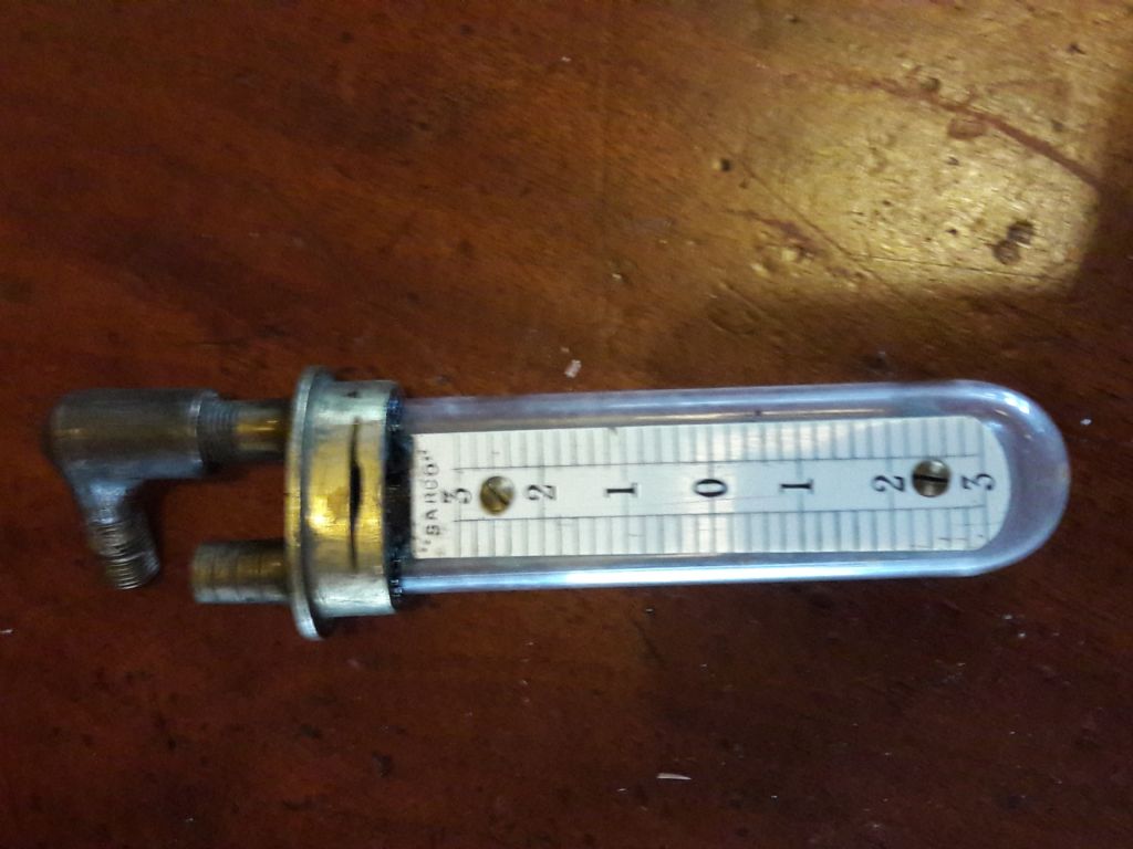

      Not sure if I'm posting this in the right place, but here goes.
      I came across this bit of equipment in my granddads garage and I'm trying to find out what it is.
      It is made of brass, stamped 'Sarco' and contains some sort of measure? I'm thinking it's something to do with a pressure gauge, but could be way off the mark.
      Would be grateful for any help in identifying.
      Thanks in advance.

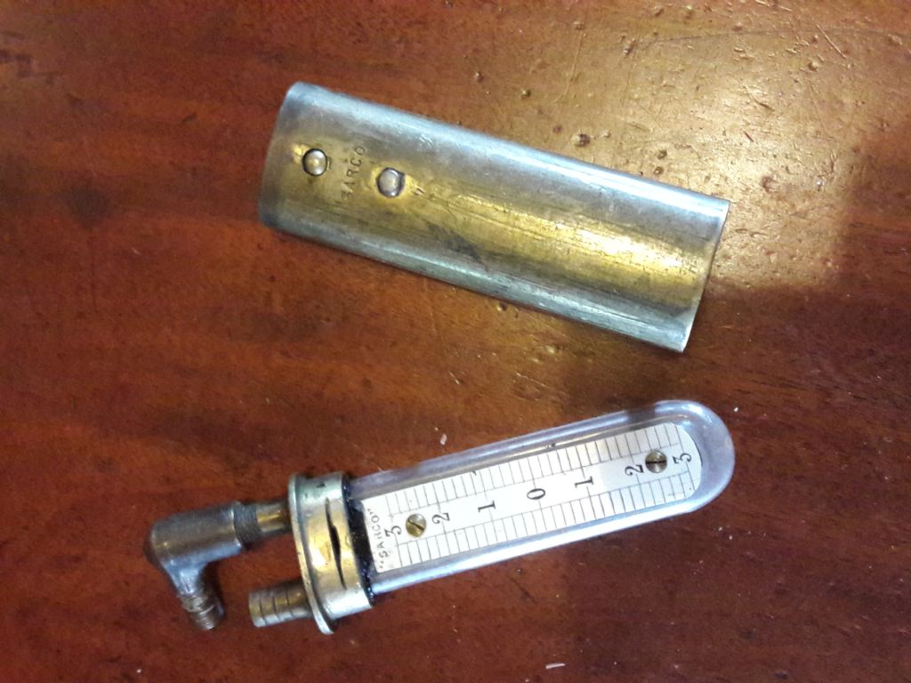

      #33281
      Jon Craig-Tyler
        @joncraig-tyler43864
        Brass ‘Sarco’ tool

          Only guessing but perhaps a manometer to help balance carbs on a car or bike??
          #374967
          mick
            @mick65121
            'U' gauge for testing gas pressure
            #374985
            Martin Connelly
              @martinconnelly55370
              Are the markings 1/2" apart? If so it is for measuring 0-3" water gauge pressure or vacuum. There should be some coloured water in the tube and when both ends of the tube are open to atmosphere the water columns should line up with the 0 on the scale. The presure is read as the difference in height between the two columns. Low pressures like this are still measured with modern gauges that give readings in inches of water. Typical uses would be for measuring air pressure in a venturi or either side of a filter where a high reading would show the filter is clogging up or flow through it is high. If filled with mercury it would work for higher pressures but is more likely that water was used.

              Jon Craig-Tyler
                Thanks for all the info.
                I've tried Spirax Sarco customer services, who were very polite but didn't have any info, unfortunately.
                There's no unit of measurement on the scale and each whole number is sub-divided into 5. There's no liquid present, but would suspect that it would hold water, as doesn't seem to be any mercury residue.
                So is it fair to say the consensus is a pressure gauge?
                Again, thanks for all your help.
                Jon

                Ian S C
                  @iansc
                  A manometre of a similar range is(I think) used for checking the draught of a chimney, you want it to be positive rather than negative.

                  Martin Kyte
                    @martinkyte99762
                    Well it's definitely a pressure gauge. Judging by the presence of two fittings it would suggest the measurement to be differential in nature. If the markings are 1/2 inch apart the the readings will be in inches (probably of water) 1inch would correspond to 0.036 psi. The metal transit case would lead one to think that it was for field use rather than lab or workshop. The pressures involved as Ian has suggested (chimneys) would fit with setting up draughting arrangements so ventilation usage may fit. Coal mines come to my mind but as far as I know they used portable anemometers as the were more interested in flow rates than pressure differences but someone may know better. However due to the very low pressures indicated would lead me to think that either the device was intended to measure balanced pressures. However if it was used in conjunction with a pitot tube already installed in a pipe it could well be used to measure flow rates.
                    That is about the limit of my deductions.

                    #375071
                      It's not for mercury, mercury wets brass.
                      #375122
                        The generic illustration of a u-tube manometer, here: **LINK**
                        http://electricalninstrumentcad.blogspot.com/2015/
                        looks remarkably like the Sarco device.

                              Geoff G
                                @geoffg
                                I think that Nick Clarke, at the top of this topic, has it right. With its very limited range and the connections to either side of the manometer, it is clearly intended to measure the pressure difference between two streams of gas (carb intakes, or whatever. The actual pressure in the system is not relevant, only the variation between the two. The use of water in the u-tube will, of course, give a much more accurate reading (12 times better?) than mercury would, never mind the problems which Neil envisages with the mercury / brass combination.

                                    bricky
                                      @bricky
                                      In the building trade we used something like this to test new drains.A solid drain plug at one end and a plug with a nipple at the other ,attach a rubber tube to the plug and the gauge and a mouthpiece tube to the other nipple and blow and watch the gauge for any fall indicating a leak.
