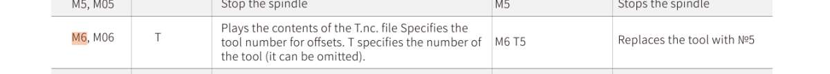

                                                Well, one thing I discovered was that despite my DDCS 3.1 not being capable of ATC, apparently it is…
                                                IMG_1014
                                                I don’t know much about g-code or m-code, I can see how it’s easy to write a script to send a spindle to a mach location to pick up a new tool. Perhaps not so easy to know where to put the tool it’s already holding.
                                                Someone somewhere will have done it.

                                                  I use the following G-code for a tool change:
                                                  Txx G43 Hxx M06
                                                  Txx – The tool number required where xx is 00 to 99. The value 00 is usually reserved for a master tool used to set offsets
                                                  G43 – Tells the program to use a positive tool offset value
                                                  Hxx – Selects the offset for tool xx from the tool table
                                                  M06 – Implements the physical tool change
                                                  On my Tormach, without an ATC, M06 simply gives a message saying change the tool and then hit ‘Cycle Start’. With an ATC M06 will automatically start the ATC sequence.
                                                  The Tormach quick change system only works with R8 tapers.
