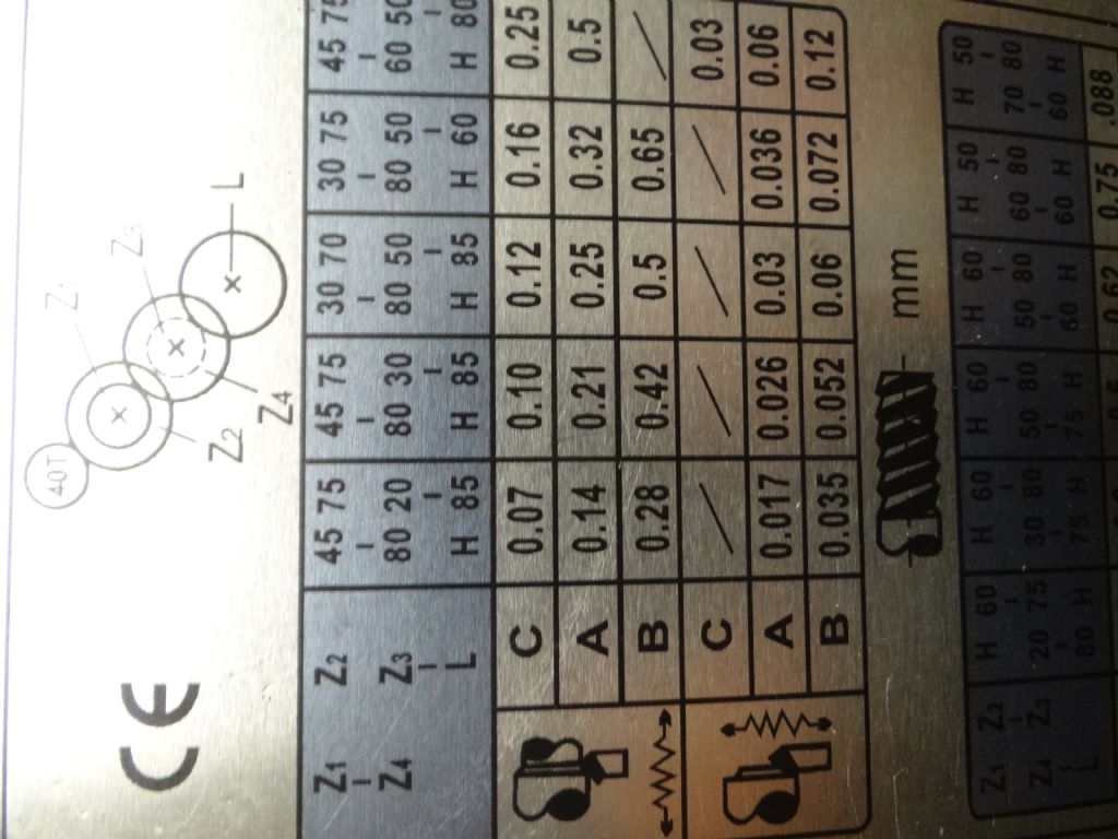

        Looking at the gear chart on my metric WM280 lathe today I noticed that some of the available ratios have been struck out:
        Sorry about the orientation of the photo but the table shows a line instead of a value for five of the possible self-act settings.
        Four possibilities are struck out for gear setting 'C'. By calculation I'd expect these feeds to be 0.008, 0.013, 0.015, and 0.018.
        As the gearbox produces the expected output, and the feeds produce a good finish, why does the table omit them?

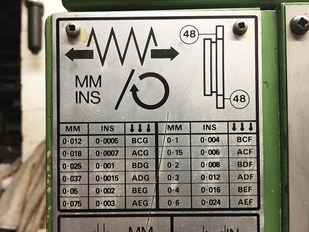

          Hi Dave,
          I have a similar lathe (290) and have noticed the same as you have. The fine feeds work and I can even get finer feeds by using different change gears to those listed. I too have wondered why they are omitted.
          Thor

                      The missing "B" of about 1mm/rev would likely stall the machine so that is why that is struck off, Even Nicks industrial geared machine only goes upto 0.6mm/rev.

                        Posted by JasonB on 10/04/2017 07:36:35:
                        I could change the 48T gears to larger / smaller to get lower or higher feed rates.
                        But the reality is I have never used a higher feed than BDF or a lower one than BDG and that is only for cast iron flywheels for a final cut. I find that when using such a low feed rate it's important that the tool is nice and freshly sharpened so that it still actually cuts and not just rubs it's way through.
                        For general machining it stays around BCF. I don't take deep cuts as I am seldom in a rush.!
                        As a side note to this I was at my mates industrial workshop last week and he asked me while he was busy to machine down a section of 50mm bar down to 30mm over a short length on one of his Colchesters. As I started to get close to 30mm I tried to get a test finishing cut. It was awful.! ……. I asked he what speed and feed rate I needed to do so. He came over and looked at the settings I had and told me that for that style of tool to 'switch on' I needed to be taking a 2 – 3mm depth of cut with a higher feed rate. A different world eh.? laugh
                        As I was close to the 30mm and had by this time not got that much depth to play with a HSS tool was used to finish off.
                        Nick

                                    There is a clue in the title Neil, we are talking feeds. Inparticular cross feeds as there is a 2:1 reduction so whatever the feed shaft is doing you will get half the cross feed for any lengthways feed.
                                    The 280 variants do have 1.0mm pitch as well as coarser metric pitches for THREADING.

                                        Sorry Andrew you are quite right, it is more like 3:1 on my imperial machine but looks to be nearer 8:1 on the OP's chart which is quite strange as the two machines more or less share the same apron parts which is where the reduction is.

                                                      So my Warco280 must be a good machine as it has the separate feed shaft, I'm happy now it has been confirmed to be better quality than a Myforddevil For the most versatile setup then Hardinge have the right idea with a separate variable speed motor on the apron to give you whatever feed you want irrispective of teh spindle revs.
                                                      I'm not sure I would like the metric version with an 8:1 difference in cross feed rates to turning cuts. With my imperial one I generally use the C position for turning and flick the lever into A for facing which gives approx similar rates. To do the same on a metric machine would be out of the question without having to swap over change wheels.
