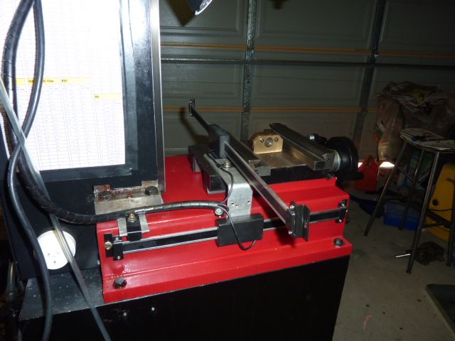

                Hi John,
                I originally fitted cheap digital scales to my mill. One of the scales failed after a couple of months use which was replaced under waranty. It failed again when out of warranty and I paid full price for a replacement. It too gave wrong readings after some use.
                I finally bit the bullet and purchased an Easson ES 14, 3 axis readout and glass scales which has been extremely reliable. Well worth the cost.
                Lots of useful videos on Youtube at: **LINK**

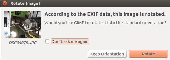

                                              I looked into this recently – it's so annoying.
                                              I don't think the forum provides any way of changing orientation once a picture is in the album.
                                              The problem is to do with how software deals with rotation data provided by the camera. This chap provides an explanation and lots of examples. Rather worryingly, his article concludes "If Google can’t handle images consistently across their own sites, on a browser that they built, what hope do the rest of us have?"
                                              The best way I've found of dealing with it is gimp. When a picture that's mis-rotated by this forum is loaded into gimp, it automatically pops up this dialogue:
                                              Pressing Rotate and then overwriting the jpg fixes it. I usually use gimp to reduce the resolution of pictures before uploading them on the web, so this is no trouble. Unfortunately, gimp is not aimed at the casual user and it's easy to get lost in the works! I shall try and find something easier to use: muzzer's suggestion is promising.
