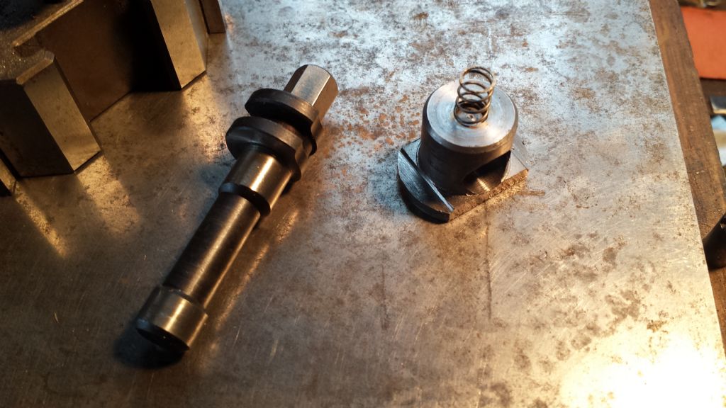

                            #318416
                            Nitai Levi
                              @nitailevi73768
                              OK, some progress… I have no idea why I didn't do this before
                              I switched the two lock pads. Since they are symmetrical I may have also put them upside down without noticing. There is definitely a difference. The "left" (looser) side it less loose and the "back" side is looser than before. The "left" is now better than the "back", but it's not exactly reversed. So wear in the lock pads is definitely part of it, plus either wear in the vees and/or putting upside down had something to do with it.
                              I can make new ones but it's not that fast. I'll check the ones from Rotagrip. The photo looks like the Bison version, which is different and won't work, but it's just the same stock photo for all sizes and models. I'll check with them tomorrow. For £13 it's worth buying instead of making.
                              Thanks again

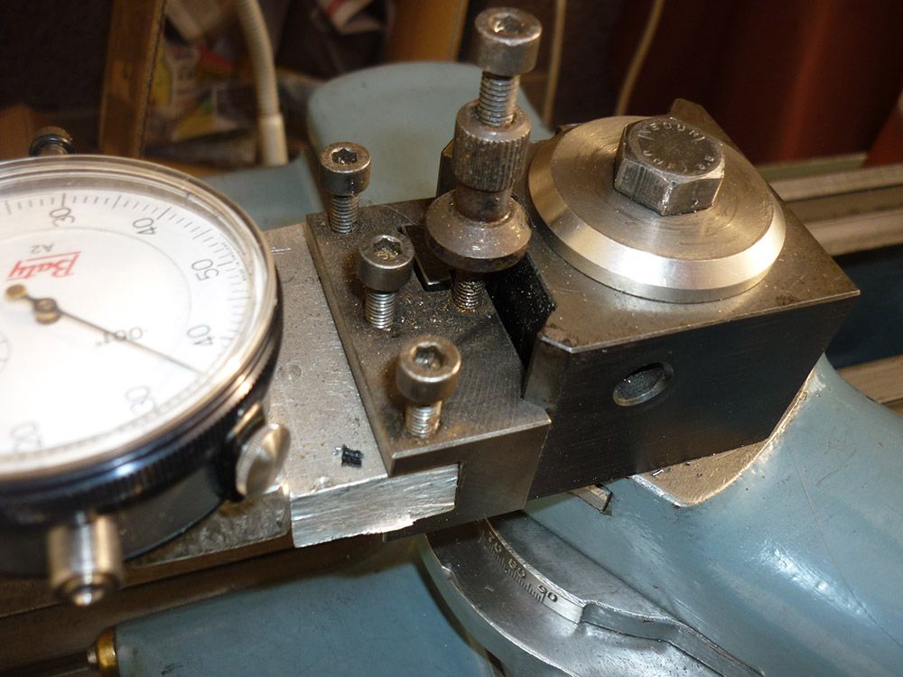

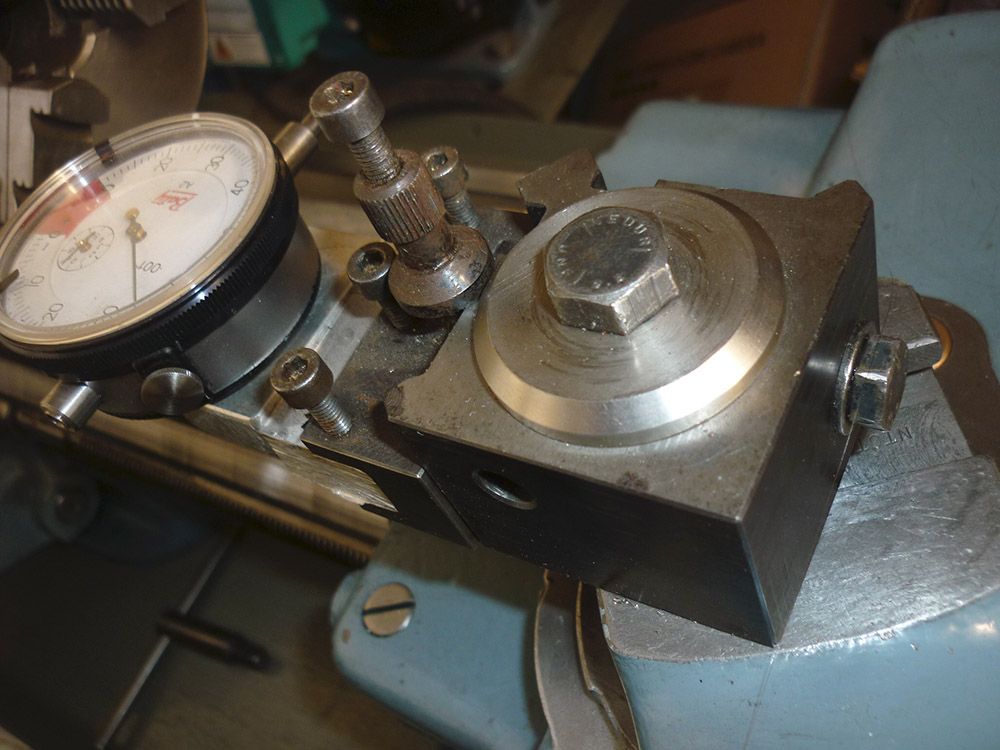

                                Very good discussion. I would add that it might be difficult to establish *fully open* position accurately by observing behavior of cam itself. As they are locking both ways, it is easier to check an angle between 2 *fully closed* positions and divide it by 2 to get value needed for your discussion. For me this angle is a little bit over 180 deg.
                                I have this toolholder, sold to me by Myford Nottingham 15 years ago. The only problem was broken cams (parting tool jam on backgear did the trick). I have recently made more beefy ones, but with all dimensions on the business side left intact. More metal could be left on the other side, because T-slot of holding unit permitted that. As for now they are working brilliant, made of BDMS. The locking bar with eccentric must be hardened however for item to last.

                                      The difference between the two locks and the change from replacing the cams convinced me the problem is likely to be in the cam rod or pad. I ordered the parts, it's not worth it making them myself.
                                      Posted by Clive Foster on 27/09/2017 13:57:22:
                                      However on factory Dickson and industrial quality clones the angular travel of the locking spanner is limited by contact between the locking device and the thick washer / spacer that sits on top of the tool post under the hold down nut.
                                      This created a sneaky disguise for the problem at first.
                                      The original holders felt like they locked i.e. I did feel a solid end to the rotation of the locking rod when tightened, but something felt off, wasn't sure what. I then noticed the top of the locking rods was touching the washer, which made me think it should be smaller. I checked with the washer off and then noticed I could pretty easily rotate the locking rod a full circle repeatedly. There was a difference in resistance throughout its rotation but kept moving. At the end of the movement (when touching the washer) it was just locked enough that it seemed ok but it wasn't really locked.

                                              Just an update. I got a couple of replacement parts from Rotagrip (pads and bolt). They are better, but when the Bison is good, the others (especially the new Chinese ones) are too tight i.e. it's hard to slip them on, it's really borderline.
                                              It varies depending on the side I put the pads, so I use the looser side and this is about an ok compromise for both. Modifying all my tight ones is not realistic since I have a lot of them and I already shimmed the originals.
                                              If I did it over again I would probably get only Dickson and Bison holders and use the new pads on the tight side. Maybe one day I'll do that, remove the shims and sell my Chinese ones. For now I'm using the compromise.
                                              Although you can see the Bison and Dickson holders are better made, in practice it doesn't really make any difference. I only don't like the Chinese parting tool holder, really worse design.
