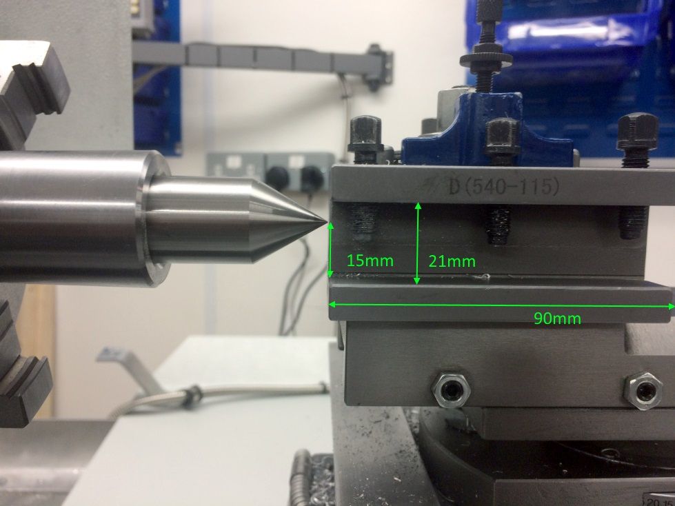

      img_4473.jpgI am interested in the diamond tool holder from eccentric engineering. The image shown is of my lathe. It's a Wabeco D6000 and has 10mm HSS bits.
      Would I be able to use either size in my tool post? The 16mm tool holder is the same length as the TP (90mm) so would be held by all 3 screws. The 12mm tool holder would only be held by 2 or is that ok?
      Also, the 16mm has 8mm tool bits rather than 6, or does that really matter?
      Thanks for looking.
      Edited By Dave Cee on 09/01/2017 20:45:16

          Hello Dave,
          I think you have to go for the 12mm tool holder because you only have a height of 15mm from the bottom of the toolpost to the centre. The 16mm tool holder requires a minimum of 16mm.

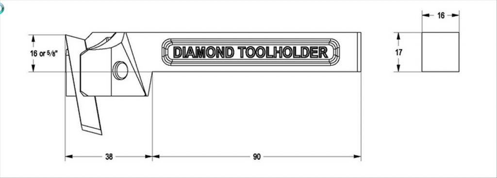

          I use a 12mm holder on my 9" Southbend lathe which is a similar setup to your lathe. The cutter just sticks out a bit more than shown in the drawing below. Still very rigid and works well.
          Paul.

            The size of the tool shank is also the the height of the cutting tip so unless your toolpost can be adjusted below the 15mm indicated on image the 16mm tool will be too high, the size of the insert for home use will probably not matter larger insert is more robust and more expensive, securing the tool with two screws will be fine.

              Thanks Paul and Colin.
              Have to say this is a very active forum, and very helpful!
              I thought it might have to be the 12mm, also, just had an email from Tania @ EE and she only has 1 set of the 12mm in stock so I think I will grab those.
              Thanks ever so much.
              Dave.

                At the risk of swimming against the tide I can't see why you wouldn't go for the 16mm and just drop the toolbit down a tad (1mm or so) in the holder so that it is still bang on centre. Wouldn't work for most carbide insert tooling, but for this particular design I can't see that it would be a problem. Always good to go for the most rigid set-up possible, and 16mm square is a fair bit more chunky than 12mm. That you can hold it with all 3 screws is even better.
                (Disclaimer – I don't actually own one, so if someone knows better and can say that slipping the toolbit down by 1mm will compromise the function at all, I'll happily be corrected…)

                  Bikepete beat me to it. Mill a bit off the bottom of the tool holder

                    i just measured mine. Two are 1/2 inch and one is 15 mm. I also have the left hand one. They all take 1/4 bits. In theory a 16 mm/8 mm might be more rigid if you like to take 3 mm cuts, but in practise, negligible. If you have the bit low down, it can bring the front of the tool bit jaws too close to the work for comfort on some jobs, such as facing. I would strongly recommend the 12 mm.
