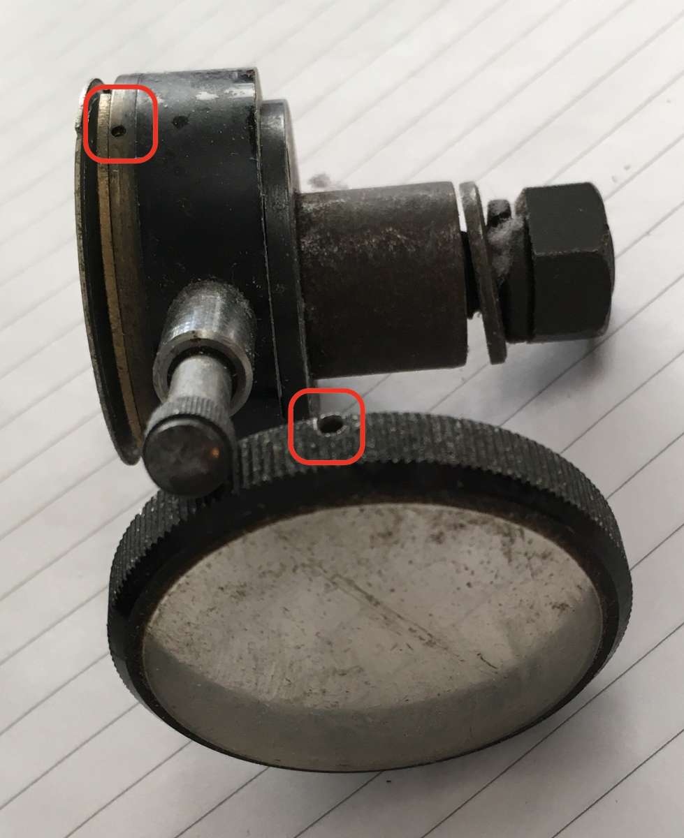

      I wonder if anyone can help me with a problem with my ancient Baty dial gauge? The revolving bezel which zeroes the setting is very stiff and is almost seized; is there any way of removing it to clean it and getting it moving again?

        Some photographs would probably help, Colin
        The decrepit Baty that I have beside me at the moment clearly had a single grubscrew holding the knurled ring … and I presume from the question that yours does not.

          Mine does have a small hole that may have contained a grub screw, but there is no screw in the hole and the bezel does not come off.

            Excuse the state of this one, please Colin
            It should probably be in the bin … but the .0005” resolution mechanism still works nicely, and I’m loathe to throw it away [story of my life]

              Thanks for the picture Michael, it is similar to mine. The good news is that I have found the grub screw! It took a magnifying glass and good light but it is there.

                Colin, I recently refurbed a Baty dial gauge and it had 3 screws accessed via a single hole in the bezel so rotate to each screw and remove. Generally you do not use oil on the mechanism, mine needed a new glass/crystal as well

                  Thanks for the heads up John, I’ll look for !ore screws!

                      Thank you everyone. I removed the bezel and found why it was stiff to turn – the DTI was full of swarf. Anyway, the upshot is that after cleaning it out, I still cannot get the bezel to turn because the aluminium on the dial is worn, as is the body, and I have free-play on the needle which means that it does not stop at the same place each time, so I believe that the poor old thing is toast.
