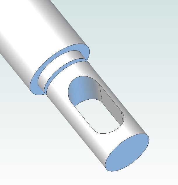

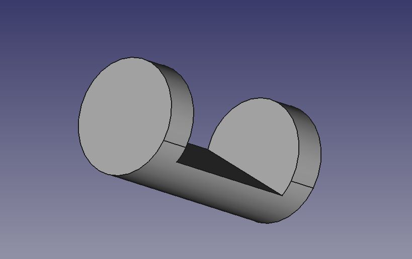

                                  I'm having trouble visualising the object Martyn – is it like this?
                                  If not, a photo of the finished item would help. I promise not to laugh if it's a shameful botch – living in a glasshouse myself I know better than to throw stones!
                                  From the description, and as I've drawn it, this is a difficult object to hold rigid during cuts, and the problem gets much worse as metal is removed.
                                  I suspect that most of your problems are due to the work twisting under heavy cuts resulting in gouging, dig-ins, and a bent workpiece. One solution is to improve the holding AND to reduce the forces on the work by taking lighter cuts at high speed with a small diameter cutter.
                                  Assuming the object is as pictured, I'd firmly clamp a long rod direct on the table, perhaps making a shallow V block to add longitudinal support. Then I'd rough out about a third of the slot with a large slot drill before switching to a smaller slot drill for the next third, and finally finishing off with a small diameter slot-drill shallow cutting at high speed. Only after the slot is cut would I shorten the rod to size.

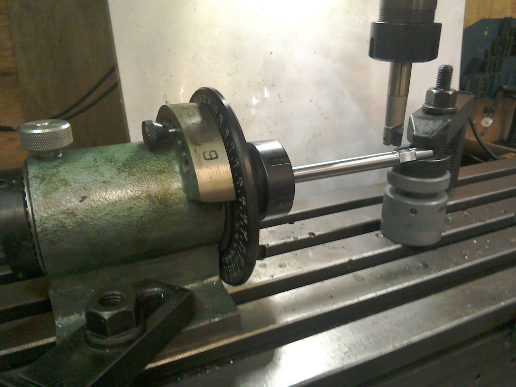

                                      This photo shows a supported and clamped overhanging workpiece which is the way to do what you wanted. A hard collet block held by hard vice jaws gives poor grip as you found. A piece of paper between the block and the moving jaw may have helped. Putting milling cutters in lathe chucks can have similar issues.
                                      The other thing that is a problem is the lack of material at the sides of the slot. If you think of a twist drill as a twisted ribbon you can understand hiw easily it can deflect. In this case as soom as one side is weakened enough the drill will be pushed that way by the forces acting on it. A stiff stub drill or spotting drill would have helped but a 3 or 4 flute milling cutter would be stiffer so better.

                                          I appreciated the drawing. That's not quite it. The bar, 27mm long at the finish remains intact at 14mm diameter. The slot – 9mm wide x 19mm long – goes through it. Thus you can't take out a complete portion as in the drawing but are leaving about 2.5mm on each side which is what makes it tricky. The slot needs to be straight, consistent and in the middle so as not to weaken one side or the other. Nice artwork though!
