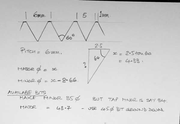

      douglas coates
        @douglascoates40572
        New sums, I checked the current tap which is not exactly 4tpi. I've done a re-calculatiojn as I seem to get strange answers to the 2 diameters. If I set pitch at 6mm but with 1mm flat, the triangle is 5mm, so perpendicular is 4.33. According to that the I/D and O/D differ by 8.66 mm?? I can get a 35mm Forstner for the nut blank, and a 45mm for the vice guide which I can grind down to about 43.7 say. Which bits of this are wrong !!?tap2.jpg
        Edited By douglas coates on 05/05/2016 09:16:31

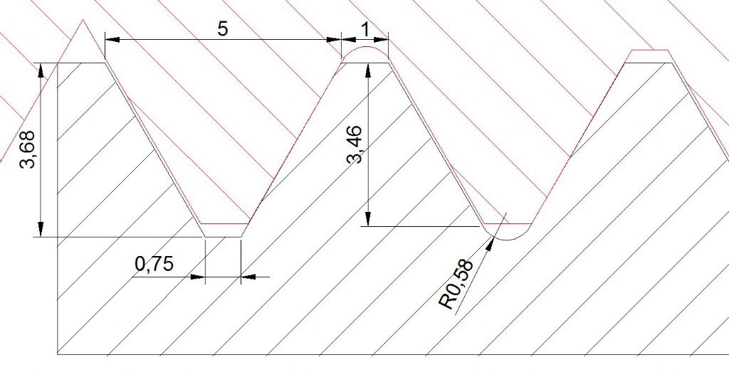

        Martin Connelly
          @martinconnelly55370
          Douglas, your 4.33mm is correct but you will not have a sharp vee at the bottom. It is usual to have a small radius or flat, after all the mating part is going to have flats. If you have a mating thread with a 1mm flat then you would expect the base of the thread to have a flat smaller than this or a radius to give a small clearance between the two parts. A radius of 0.58mm at the bottom of the vee would be one solution and a flat of 0.75mm would be another. these both have the effect of increasing the inside diameter.
          If we have a radius of 0.58mm at the bottom of the vee then the flank height is no longer 4.33mm but becomes 3.46mm and the radius after this goes down a further 0.29mm so your 4.33mm is now 3.75mm.
          If we have a flat of 0.75mm at the base of the vee then the flank height is now 3.68mm.
          See the drawing below for the details.
          Martin

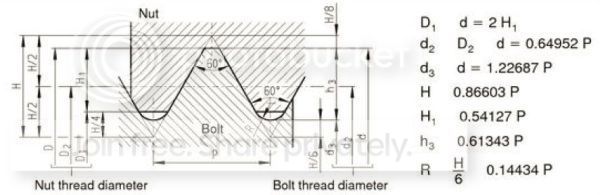

          Hopper
            @hopper
            I think you need to stick with a standard thread form and use the standard dimensions commonly available. For a 60 degree thread, you could use either UNC or Metric forms. Plenty of standard charts on the net and in ME books that will give you the thread depths, diameters etc including or excluding the flats at top and bottoms.
            Eg, metric:
