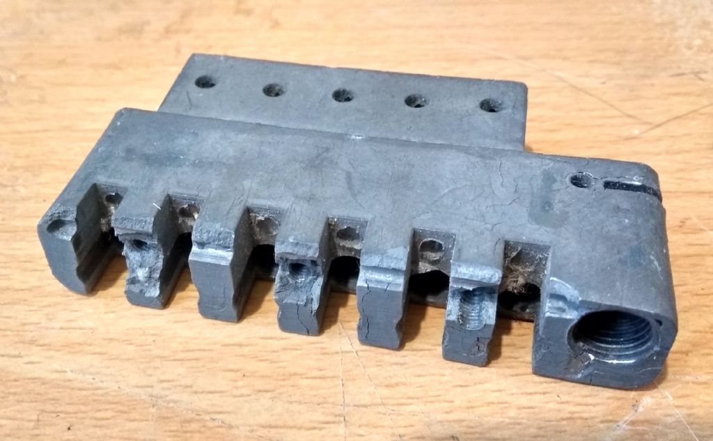

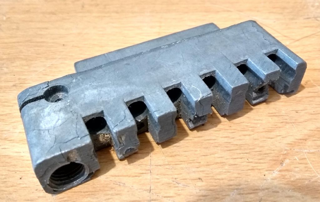

      I'm fitting a new body to a guitar I 'made' in 1993. It's got a Floyd Rose (or more likely a copy) bridge that dates back to about ten years earlier so it must be about thirty five years old.
      It was hard to tune and when I removed it from the guitar the reason appeared obvious – the three fixing screws for the part inside the guitar was loose.
      This does get a fair bit of stress taking the whole string tension, balanced by three springs. Especially when it was on my brother's strat in the days before I got it!
      However, it seems the damage is not as simple as just stress cracks as the whole part is riddled with cracks that make it look like the whole part is swelling from the inside. My guess is it started to gradually swell and split due to tinworm and this then led to the actual breaking of the parts the screws fit into.
      It's a pressure casting but I'm going to machine a replacement from 6062 aluminium alloy.

          A common problem with old diecast alloys – whether zinc based or aluminium based. From memory, it can be caused by a lack of purity in one or more of the alloying elements.
          And you are right – the answer is to start again – fortunately in this case it seems a straightforward part to machine. Or do I mean straight forward, then back again, then sideways, and then endways …

            What Tim says. A lot of old die cast cars from some specific manufacturers have the same problem usually around rivets.

                    It has the delightful name zincpest.

                          It’s a reaction with water. Damp storage or just cold with a fair fair humidity will cause expansion of the cheap MAZAK. I’ve encountered this with north american autoknitter sock knitting machines. Probably why English made versions were fitted with cast iron cylinders and steel parts.

                                        Mazak (Zamak if you're in the US) as used for a lot of zinc die-castings were very prone to crumbling away (Old Hornby Dublo stuff and many pre-war toys sometimes suffered). This was due to minute amounts of lead in the alloy causing grain growth. If the lead is below a certain concentration, there's usually no problem.

                                                Fraid not. It is lead contamination that causes the zinc rot.
