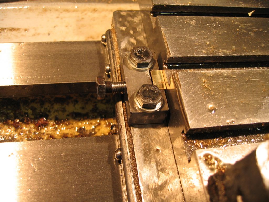

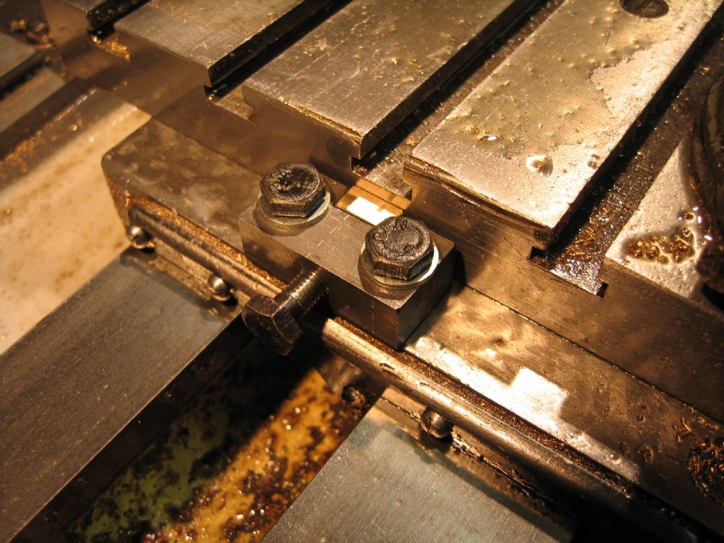

                                      JA
                                        @ja
                                        Jim
                                        I have fitted a George Thomas type lock on both top and cross slides on my current lathe and have nothing to add about his arrangement.
                                        However there is another very simple locking arrangement that can be used on some Myford lathes. The lathe saddle must have two tapped holes on the head stock side of the saddle. These are for mounting a travelling steady but later lathes (or mine at least) only have one hole. The lock is a simple clamp mounted in these two holes. I have attached a couple of photographs that show the arrangement.
                                        I fitted this to my earlier Myford after the suggested arrangement appeared in the MEW in October 2005.
                                        JA
