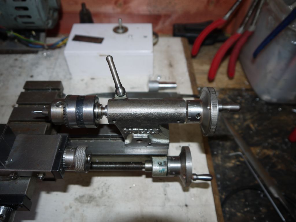

        Still getting to grips with my cowells lathe, so the thing is i have been cleaning the unit up, so i got to the tailstock and realised it seemed to be jammed up ie not retracting and moving when you move the tailstock dial, so on some further messing around and to be honest using some brute force i have managed to completley destroy the threaded bar going through the centre snapped it in half, i think its a reverse type thread on it, my main question is what other tailstock will fit as it seems imposible to get any advice would be very apreciated.
        regards john

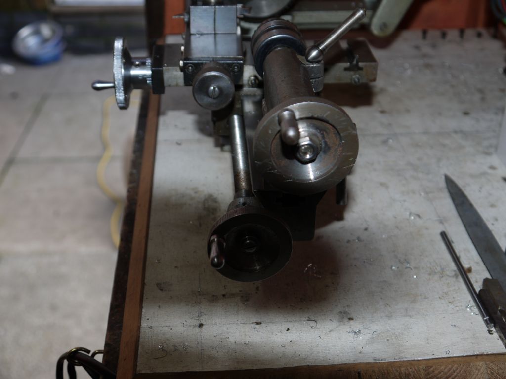

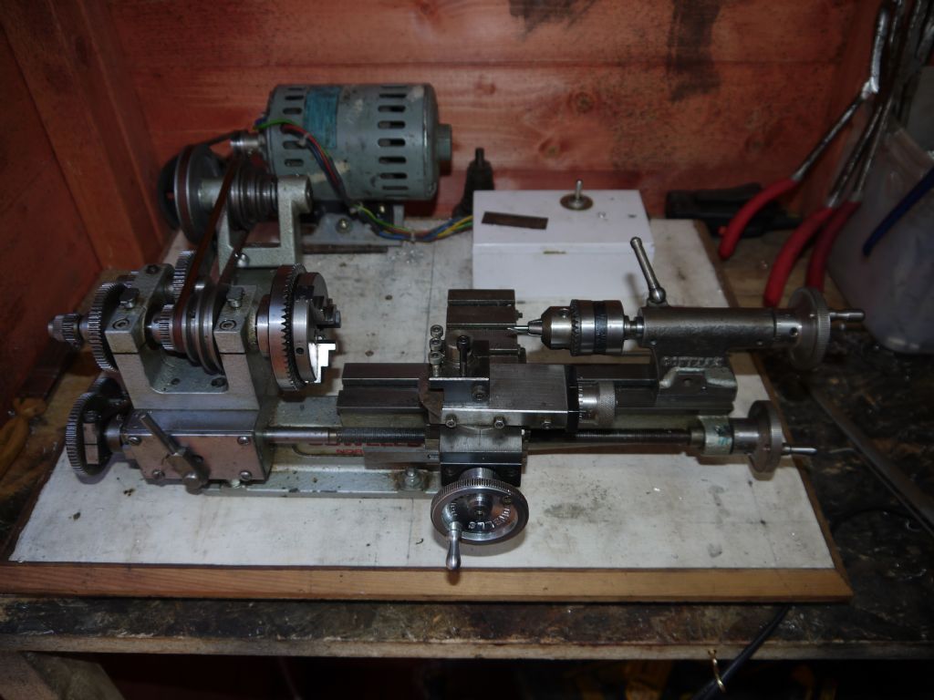

                                                    #317177
                                                    JOHN BURNELL 1
                                                      @johnburnell1
                                                      p1040271.jpgp1040272.jpgp1040273.jpgp1040271.jpgSucces, got my L/H thread stud bar 6mm threaded it through the centre peice of my tailstock secured a nut on the thread fited coller secured that fitted turning handle , works great, tottal cost £5 i have added a few pictures, thanks for all your help and sugestions.
                                                      regards john
