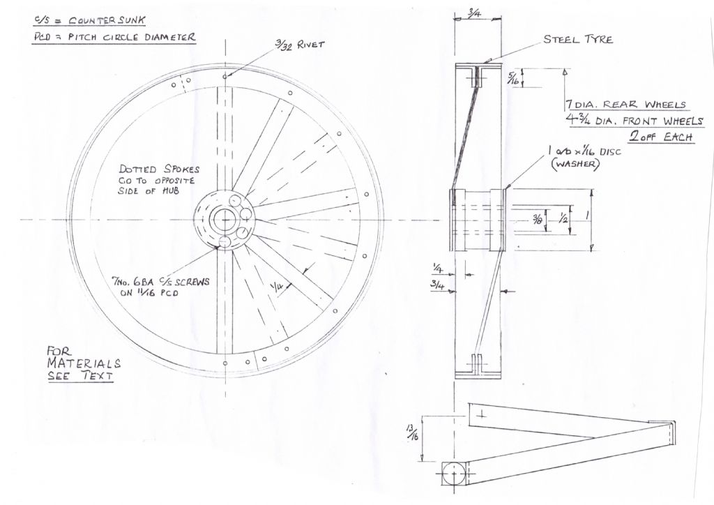

      In the latest issue Tony suggests chain drilling out the wheel rims by stepping out 1/8″ along a scribed circle and then drilling 3mm holes, all well and good so far.
      He than says to open out the holes to 4mm BUT not any that are likely to run into adjacent holes. 4mm into 1/8″ spacing won’t go so the holes will run into each other.
      Is it a typo and should the beginner be stepping out at 3/16″ or just drilling 3mm and sawing these holes.
      It would also help the beginner if he gave a radius for the chaindrilled holes and also the radius the rivits should be drilled at as its not on the drawing
      There is also no mention in the text or on the drawings of what thickness angle the rims are made from if rolled. I would assume it should be 1/16″ rather than the beginner looking for 18swg x 3/8″ angle. Also does not mention that the angle will need cutting down to 3/8×11/32″ approx
      And being nit picky there are too many dotted hidden detail lines on the hub section, it should only show the bore dotted and not the outer spigots carried through. Also why colour one spoke? is it to show it in section if so why not the hub & rim
      Hopefully these items will be sorted as it will confuse beginners that this series is aimed at.

          I have checked the original text and dimensions are correct as published.
          I would suggest marking out at 3/16in. apart might be a better bet.
          I would make the hole pitch circle diameter 1/4in. smaller than the inside of the wheel rim.
          regards david

            And for any beginners that will work out at 6 1/8″ dia which will mean the holes come just inside the Angle leg NOT the rim

              Probably a typo on the chain drilling. Drilling every other hole on 1/8″ spacing out to 4 mm will clear the webs between the holes with minimal chance of drill wander. Or maybe drill every other hole 4 mm in the first place by going round twice. The inexperienced worker can do without slightly misplaced holes running into each other on their first efforts at chain drilling. Not to mention the broken drills!
              Mixing imperial (1/8″) and metric dimensions may be frowned upon but its an excellent way of getting a small clearance / space with limited tools and no need for super accurate measuring gear. Laying divider points onto a good engraved rule is very accurate, especially via a magnifier.

                        Two other points on the hub cross section
                        1. No diameter shown for the reduced central section, assume it should be about 7/8″ Would also look better with radiused internal & external corners as it represents a casting
                        2. The 1/4″ dimension given for the hub flanges is not in proportion to whats drawn, the 1/4″ should have been dimensioned from the outer face of the cover “washer” to the back of the flange.
                        Jason
                        Oh and no idea what the bits in the bottom right are meant to be, hopefully the next installment will enlighten us

                              Like Jason,I have no idea quite what the figure bottom right represents.Also missing from the drawing is the spoke thickness.Is it supposed to be 18g or 16g as implied in the text,or if the angle rims are equal at 5/16,should the spokes be 1/8″ thick?
                              And despite giving the tyre width of 3/4″ twice on the drawing,there is no mention of how thick that should be.
                              Why not put all the dimensions needed to make the wheels on the drawing,especially as the series is aimed for the beginner?
                              Again it poses the question about the standards of some of the drawings published in the magazine,whereas those excellently provided by Ray McMahon and Peter Rich for their respective locomotive designs should be what all contributors should aim for.
                              I hope Mr Webster and the Editor accept my comments in a constructive way,as I think this is a most interesting project.
                              Whether we love or loathe the subject,technical drawing is the language of engineering,whether at full size or in ‘our’ scales.

                                    Bottom right are the spokes.
                                    regards David

                                      I can’t see how that can be the spokes as they are drawn in the wrong plane relative to the angle at the extream right, have a kink in them and a hole drilled their full width??? and also not to the same scale/proporting as the rest of the drawing. Also would be nice to referance the drawings some way eg Fig. No or even just say “back wheel” then we all know what drawing is being refered to.

                                        Two maybe three other items missing from the drawing
                                        1. Tapped holes for hubcaps
                                        2. Position of spacers where the two half circle flanges are rivited together so they don’t get crushed
                                        3. Should there be a tapped hole in the hub to take an oil tube?

                                              Original drawing attached.
                                              We can only publish what we are given.
                                              It appears to have been redrawn correctly.
                                              I will ask the author about spoke thickness and hub dimensions.

                                                  I still do not have a clue what this view reprsents, how it relates to the spokes or what the 13/16″ is for. I just can’t fathom it.

                                                    Hi, no! I can’t fathom out how this view relates to the spokes either. I have studied it several times and joggled about with some of the dimentions to see if the 13/16″ can throw any light on it, but nothing seems to make any sense.

                                                      No, I’m baffled
                                                      I did think it may be some form of drilling jig but couldn’t be bothered to work out if the 13/16 would give the next hole around the rim but as the radius for the rivits is not given you can’t do the trig. Can’t see why there is an angle ring shown at the end where the “spokes” radiate from, also there should be a second size for the smaller front wheels.
                                                      Could also be some form of bending or wheel building jig but again why show the angle rings?
