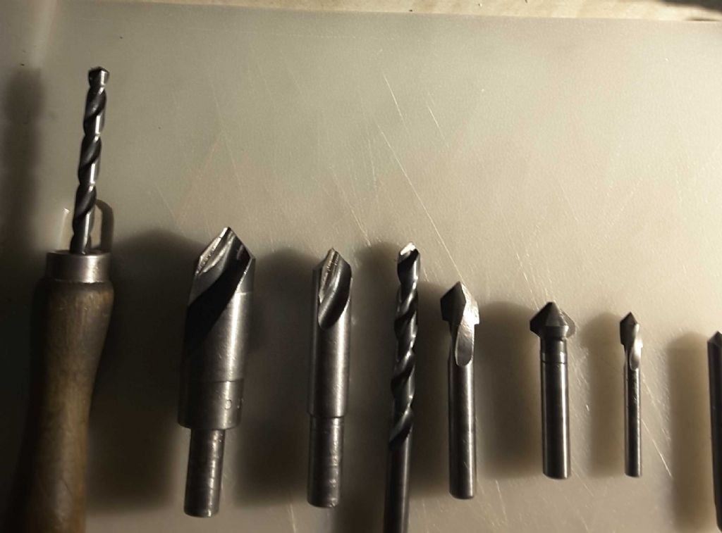

          Hi Peter first welcome to the forum. I have many countersinks mostly made by myself but the best set are ones from Dormer they came in a set and have lasted at least 15 years withoug re-sharpening. It depends what you are countersinking and how deep your pockets are to what you buy I think that you could buy a few sets for the price of mine. Here are a picture of a few of mine some made from old drills etc.20170126_100918a.jpg
