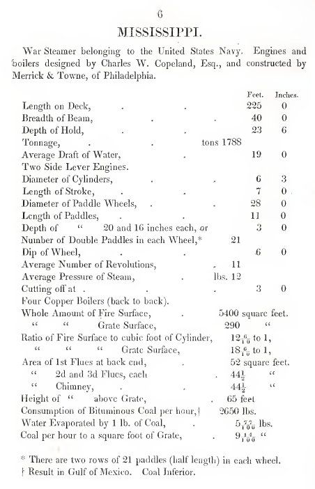

              Here is the information on the Mississippi steam ship.
              This data mentions 12 psi, which is even lower than I stated above.
              Constructed around 1840, using a copper boiler I think.
              Boilers in 1840 were apparently rather crude from a standpoint of withstanding very much pressure.

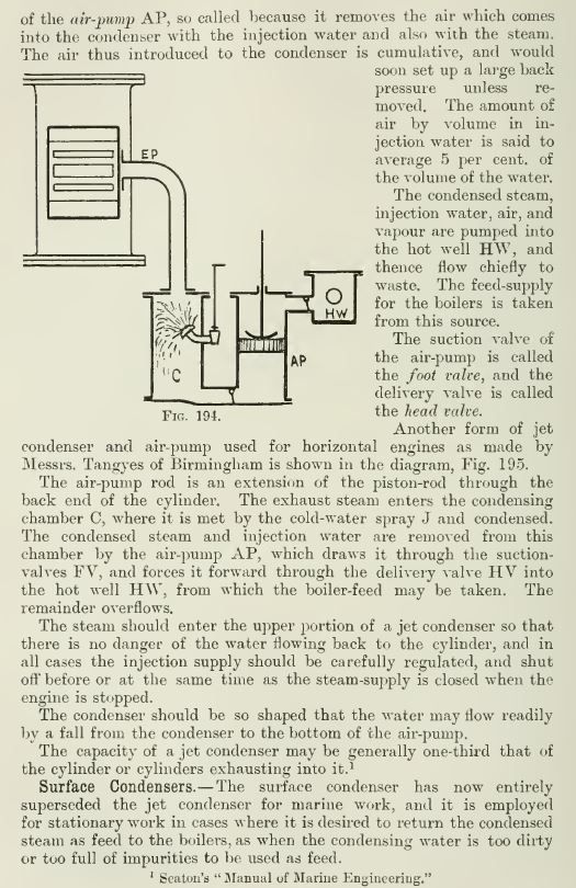

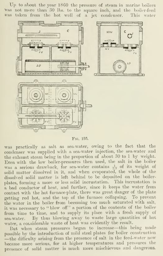

                Here are a few items I found in some old books.
                The Mississippi condensers were jet condenser type.
