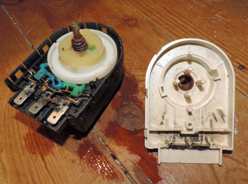

      Today our combi boiler has started blowing the internal fuses.
      They go almost straight away if it is in radiator + hot water mode, but in hot water mode I was able to run a bath before the fuse blew.
      I'm wondering if this is most likely to be the pump or something else?
      When I have daylight I will check the pump head and that the pump rotor isn't jammed, but any suggestions what else it could be (and how to test)?

          Need a bit more info, boiler make/model etc.
          However generally speaking blown fuses are usually down to pump, or water leaking into diverter head.

                    Check whether the condensate tube inside the boiler is not leaking and finding it's way into the electrics.This cost me a new boiler.
                    Frank

                      Take the diverter stepper motor head off, Black plastic thing with a 3 wire plug attached ( Pull out the metal clip and it will come off) look for signs of water ingress from the brass diverter body and stainless pin that the motor acts on…………if its dry, come back to me. If its wet you need a diverter rebuild kit and probably a new stepper motor.

                          Fired it up and I see steam coming from that 3-wire plug…
                          Looks like you are spot on!
                          The stepper appears to work though, will it be OK to clean the contacts and dry it out?
                          Is the diverter rebuild within the realms of a DIY job? Will the system need draining down?
                          I see there's a sensor of some sort fitted to the bottom right that's weeping as well.
                          Not what I wanted a week before Christmas…

                              I have found a motor and cartridge set.
                              I assume that I just have to:
                              Isolate mains and water.
                              Drain out using valve on right of boiler + hot taps.
                              Unscrew the valve cartridge from top of diverter.
                              Fit new cartridge + motor.
                              Close drain and refill
                              Good to go???
                              #386177

                                Hi Neil It is worth cleaning the pump rotor on the Grundfoss as well as the new spiral rotor collects debris and slows flow. I recently had to clean my pump. You just remove the four screws holding the pump to the housing unplug the cable and look at the spiral fins mine were full of bits of material. flow in the system was restored.

                                Alan Waddington 2
                                  @alanwaddington2
                                  Posted by Neil Wyatt on 17/12/2018 21:07:48:
                                  Good to go???
                                  Pretty much it…….Make a boiler engineer out of you yet Neil cheeky
