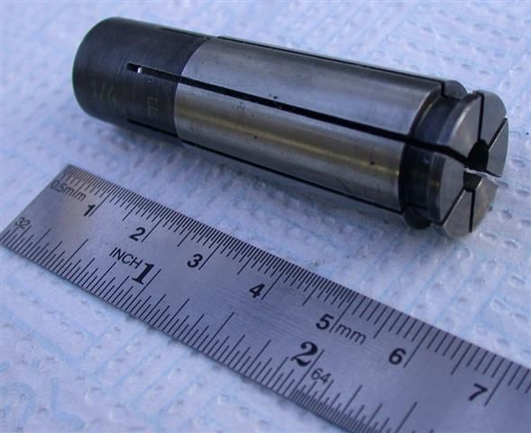

            David
            They sound like Myford collets and with the threaded "nose cone" – called a "nose piece" or collet closer – will only fit Myford machines as the spindle nose thread has to match the Myford thread inside the collet closer.
            Myford collets are 2¼" long and 0.58" dia at the thin end. For ease of reference one is shown here

              David,
              I was thinking along the same lines as Robbo … but there is one important caveat
              Any resemblance to ER Collets is quite superficial: Yes, both have a groove for the closing ring BUT the Myford ones are fixed size, and do not have the range of an ER.

                Thanks folks. The photos from Robo prove my thoughts that they are Myford only collets. I think starting again with ER 32 and a collet holder for the Mini Lathe is my best choice. My next thoiught being do I go for metric or imperial?.

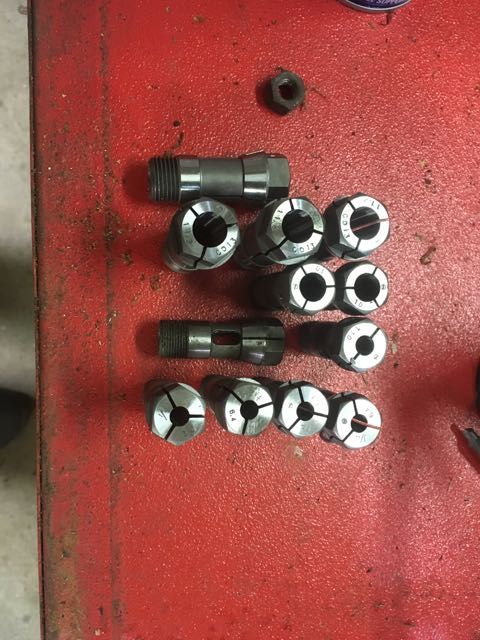

                                    I don't mean to steal this thread but wonder if anyone can identify these collets I picked up for $5.00?
                                    Hard to see in the photo but they are threaded on the outside of the end and do not have an internal thread.
                                    #290820
                                      Peter,
                                      Your slightly fuzzy photo appears to show them marked CD13
                                      … So try here: **LINK**
                                      http://www.miyakawa.com/en/products_e/multiple_head/collet_drill.htm
                                      Nice find at that price !!

                                        Thanks Michael. I'm sure that's what they are. Now I don't know if I should buy the rest so I can use them or try to make a few $$$ by selling them. Once again, love this site!
