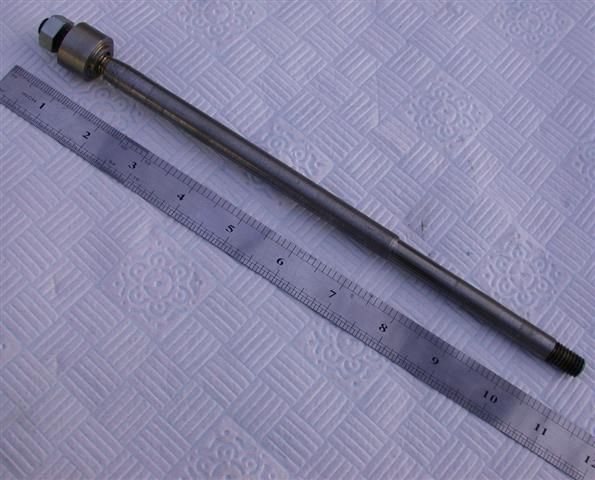

      With the lathe, all of its tooling came with it including some collets I have never seen. I "think" they are British in origin therefore my question here. They fit a #2 MT sleeve that fits the headstock and have a fine threaded end to pull them tight into the sleeve. I don't have the collet closing tube and that is what I would like to make.

          Myfords "own" collets had a special front end, with a rebate machined around the edge, this fitted into a collet closing nut which screwed onto the end of the spindle, so the collet was pushed into the taper rather than drawn into it from the other end. This left the hole in the spindle clear so thin bar could pass through it, allowing longer workpieces to be accommodated.
          If your collets have an internal thread at the back end, then they are not "Myford Pattern", but more likely ordinary MT2 draw collets. Myford collets didn't need the internal thread of course.
          Check the front end, if it is plain then not Myford, just an ordinary draw collet, which will of course work in the Myford spindle taper but will need a drawbar to pull it in from the left-hand end.
          The collet internal thread in UK would likely be 3/8" Whitworth if Imperial or M10 if Metric.
          Briefly, the drawbar needs to be about 11" long, with 5/8" length threaded at one end to screw into the collet, and 1½" threaded at the other for a tightening nut plus a loose collar (about 3/4" – 1"  to centralise it in the end of the spindle.

              and the drawbar I used for plain collets on the Super 7, as described above – quickly made from a bit of tube with a piece of threaded rod brazed into each end and a collar turned from round bar. Not pretty but worked well.
