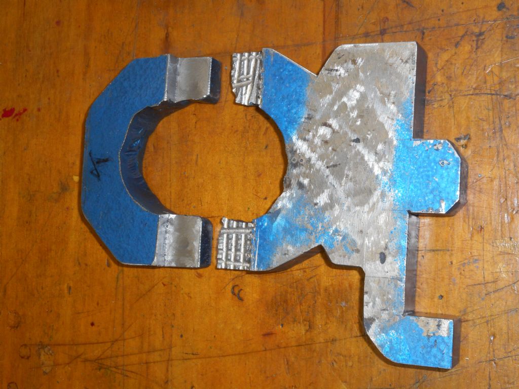

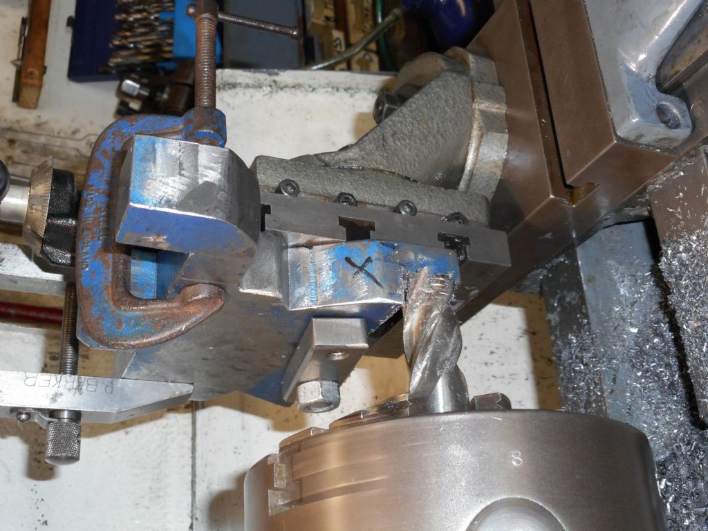

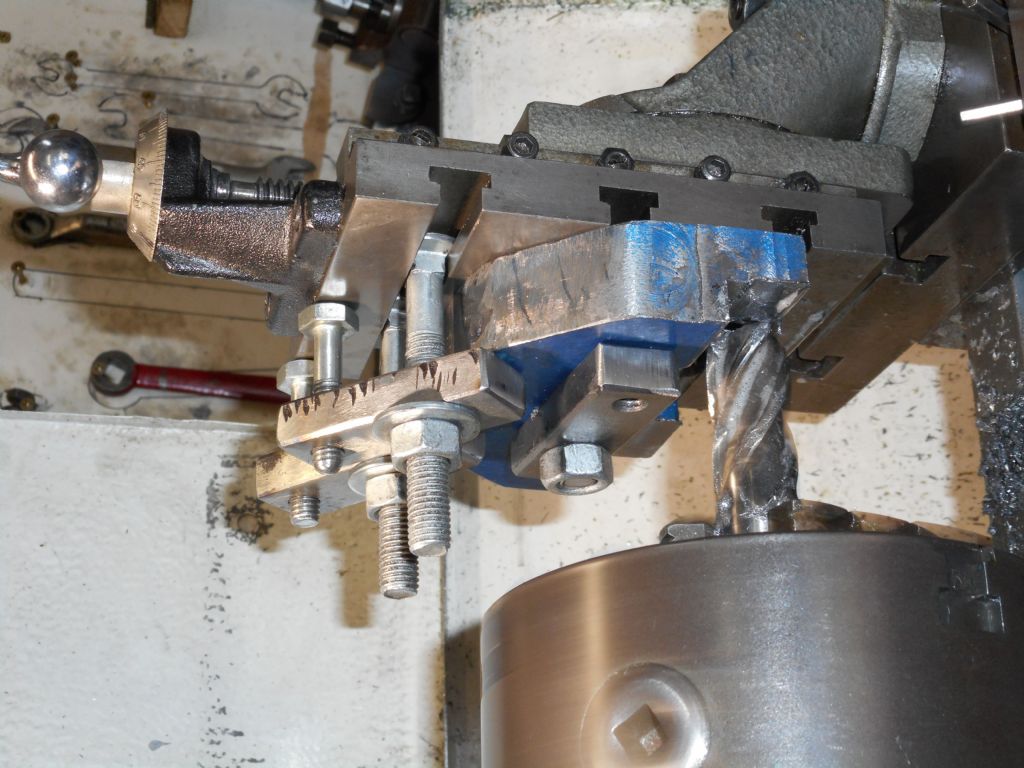

      Dunno what all the fuss is about. 1" steel plate. 22mm cutter, cutting on both side and end of cutter. 3 jaw chuck.
      End result:
      Sorry about the sideways pics. I'm better at using 1930s technology than 21st C stuff! Maybe mods can fix?
      Edited By Hopper on 26/03/2019 11:51:58
      Edited By Hopper on 26/03/2019 12:13:41

        So if you don't have a 4-jaw at the moment it is probably fair to assume that you also don't have a vertical slide in which case you will want a cutter that can sweep the 20mm thickness in one pass so the work is not disturbed.
        I would also go with a flycutter as was mentioned above, cheaper than a 4 flute end mill over 20mm diameter and easily sharpened. One with a straight shank will do fine and it won't be bothered if held in a 3-jaw.
        Just clamp the work to teh cross slide on some packing to get it roughly on ctr height and skim one side. Rotate work 90degrees and clock in the face you have just machined so it is true then machine the second side, repeat until all 4 are done.

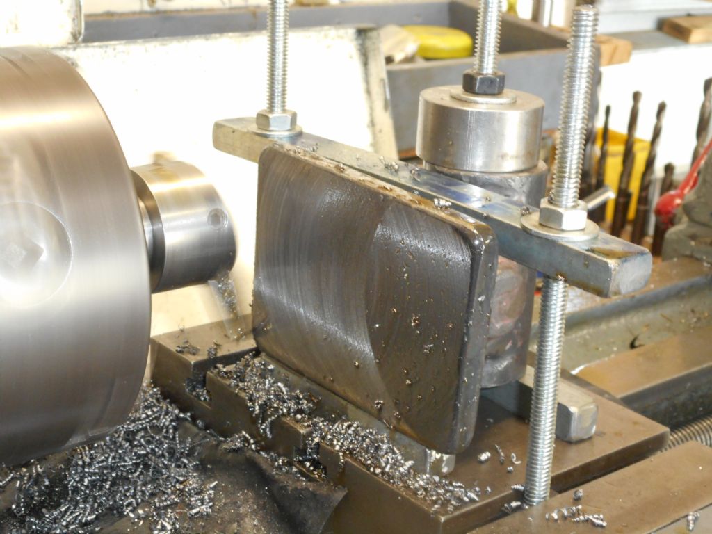

        Hopper
          @hopper
          Yes, flycutter can do just about anything as far as facing work goes. (And boring at a pinch smiley . That poor little lathe had no idea what it was in for when it left the factory in 1937. )
          dscn0976.jpg.

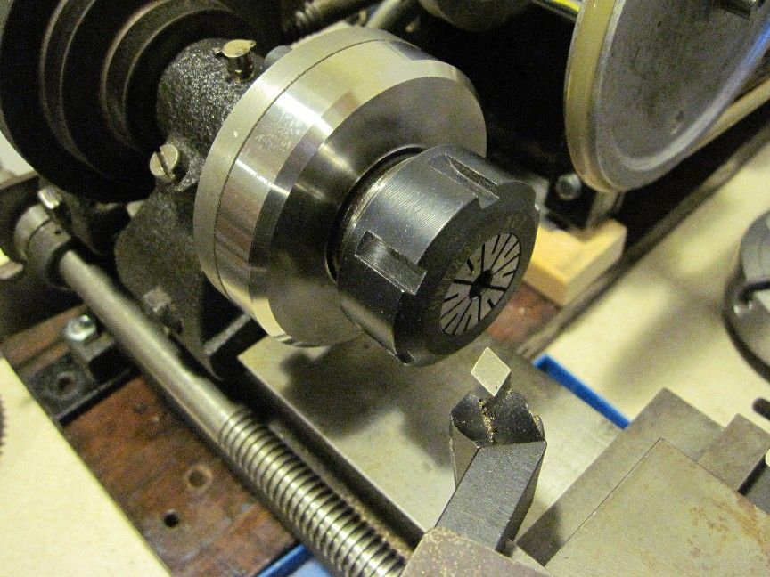

                  What is the preferred type of collet chuck for a Myford type threaded spindle? One that fits in the internal taper with drawbar? A "nose" that screws on the end of the spindle? Or the type that bolts on to a small faceplate and can be adjusted to get the collet holder running dead true?

                          Both mine are the ER32 backplate type.
                          Several reasons really. At the time they were quite a bit cheaper than the 'screwed nose' type (which wasn't available for the EW anyway), I already had 'spare' backplates and finally I thought it might be useful to be able to adjust for any potential small runout (having heard various tales of problems in that area). So they were fitted with slightly 'loose' registers and clocked true. I used to check them from time to time but they don't seem to have moved, so don't tend to these days.
                          I probably use the EW ER chuck more often, as it's very useful for small boiler fittings (I have a range of tapped/threaded fittings – master/slave style). Also when tapping, it holds work far better than my 3-jaw scroll chuck. In the S7 I do use the ER to hold milling cutters but again it is very handy for work holding – I'm just making a small mandrel (to hold some cylinders I'm machining for a friend) and it will have replaceable 'slides' to grip different size cylinders – as I have others to do eventually. So a bit like on the EW – I can make an accessory and then re-use it and still have it run pretty true. And of course – all these bits can be moved to my other ER stuff if required.
                          OK sorry – I'm rambling (again). Hopper – the backplate type works for me.
                          Regards,
                          IanT
                          P.S.  I also have a MT2 ER32 chuck for use on my mills but don't use it on the lathes – harder to remove and no through headstock work possible.
