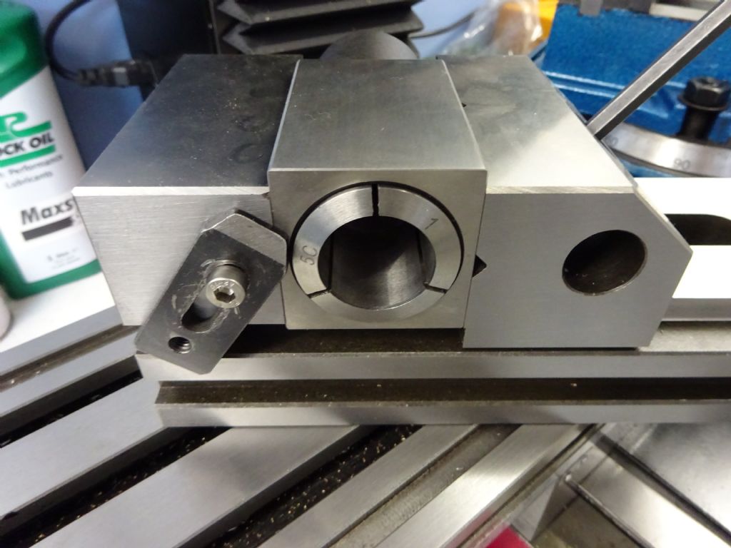

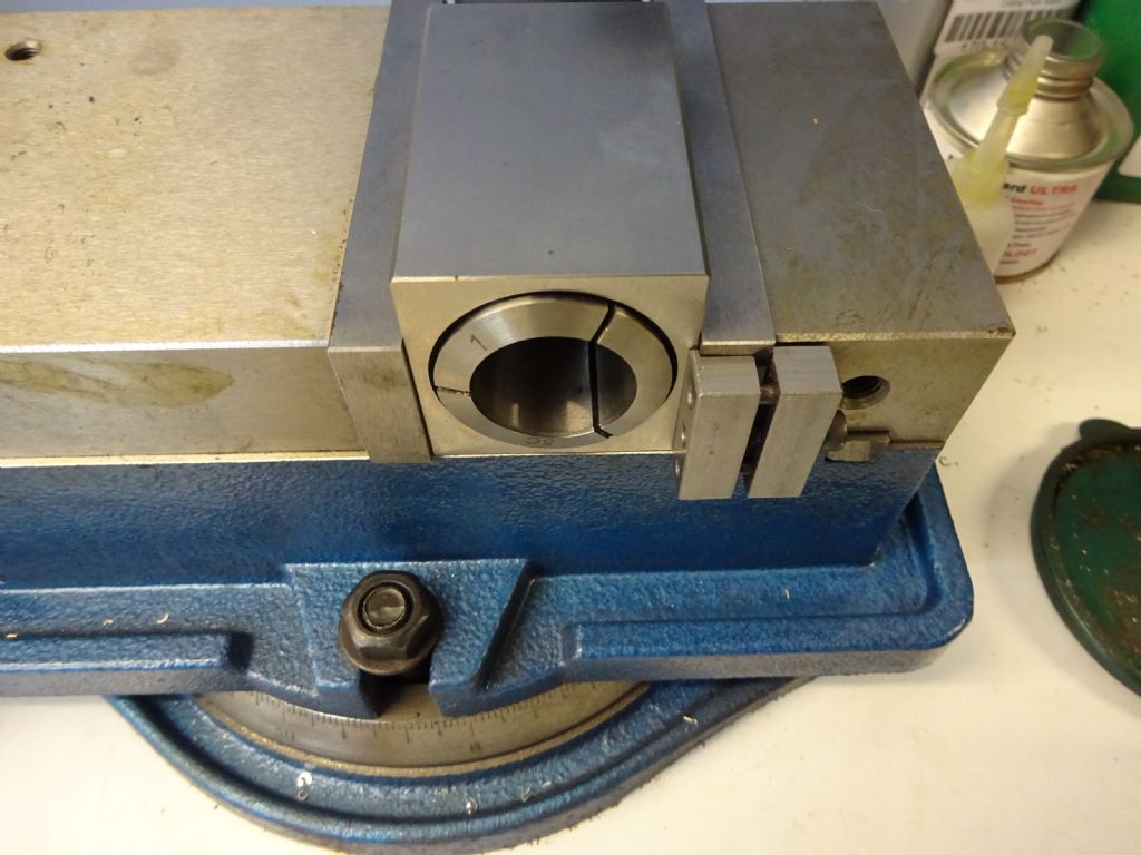

                Clive, don't you have any vice stops
                As for a spin indexer I use the Stevenson one with it's 5C to ER32 converter and special nut. Or you can just put a standard 5C to ER32 converter into any 5C tooling

                    Jason
                    The VJ400 vices I use don't really suit simple vice stops. Also jaw overhang from the sides of the base is 3/4" or so which is perhaps more than ideal when you need to get the block re-seated really flat. Something like your bottom picture would work OK but I just don't use the collet blocks enough. A flat magnet about 2 x 1 x 3/16 inches does similar duties well enough when needed.
                    Usual chicken and egg. If I needed such something suitably engineered would get done PDQ. But the need hasn't really been there. Better use of the effort to make mounting the spindexer quick and easy. Having a 5C mount three jaw makes it much more useful too.

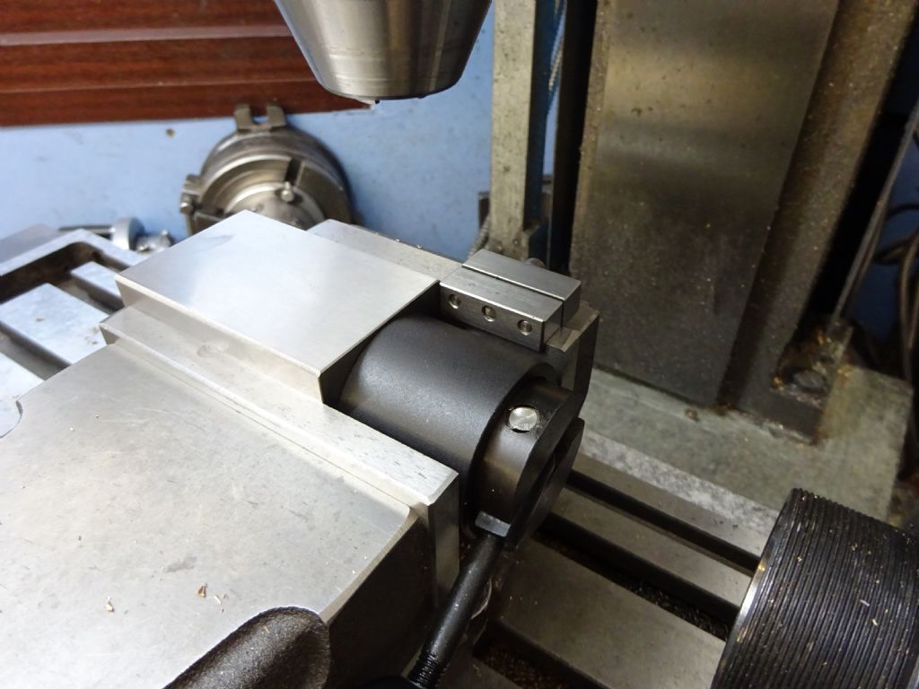

                              I machined the bottom, sides and faces of my spin indexer quite soon after I got it and added thrust bearings as well. Didn't bother with the covers or o rings as I don't have a grinder that I use it on. I also didn't swap the ends round. Like Clive I have a 5C mount chuck to use with it as well. To do the first operation I set the bore up to the spindle axis and made sure the front face was square to the spindle rotation and machined the base using the front face as the datum. You can see one of the thrust bearings in this picture from 2017.

                                I machined the sides of the base and cut clamping slots on mine. I did this relative to the bore of the spindexer as suggested on one of the engineering sites by “Bogstandard”. I didn’t touch the base as it seemed to be ok. I have seen a video of a guy machining the base without any reference to the bore at all so who knows how accurate it is when set up on his mill?
