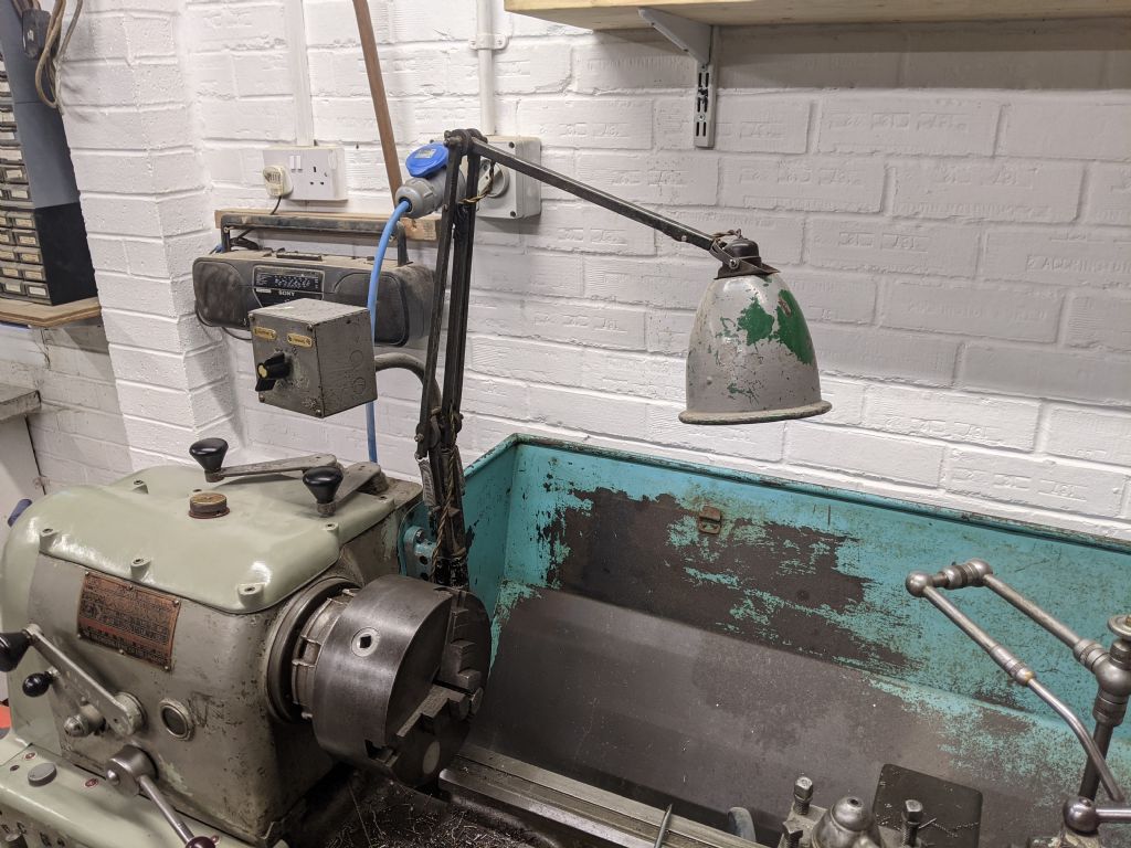

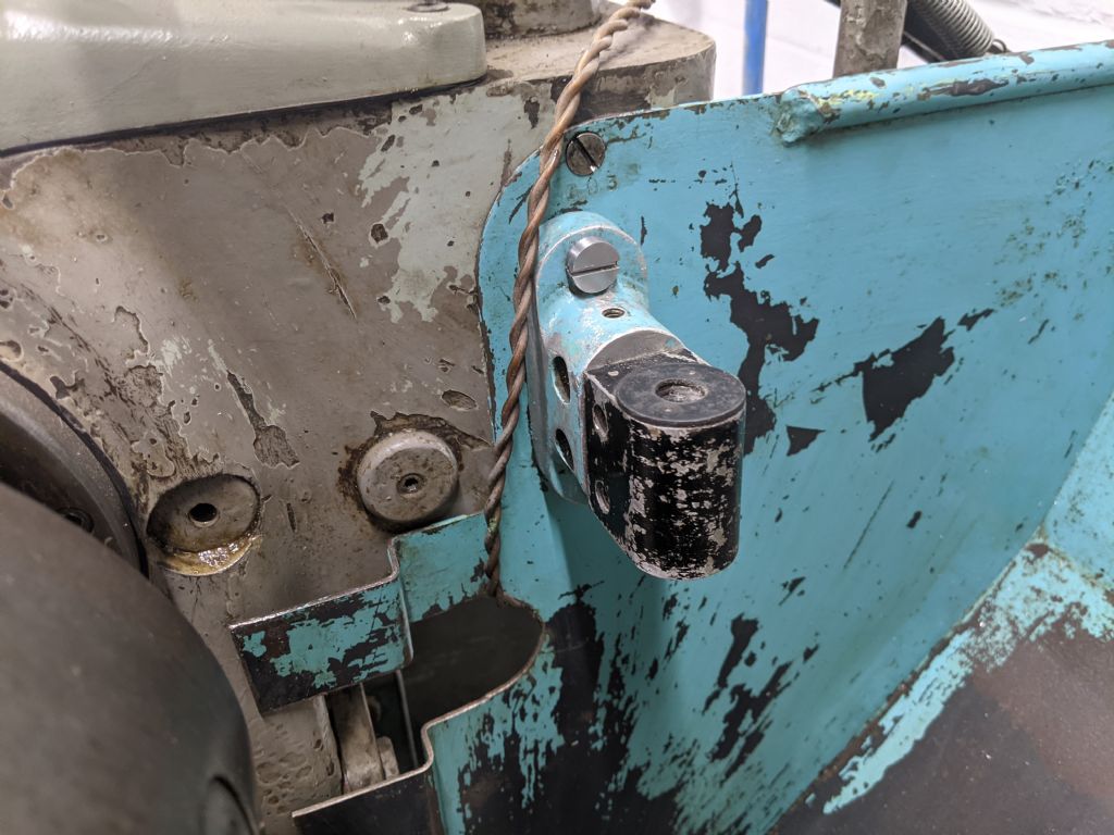

          Anyway, I got the light mount mounted today, so the lathe is almost in one piece!
          It seems to be in just the right position for me, so I'm very happy. I need to find some more turning to do now…

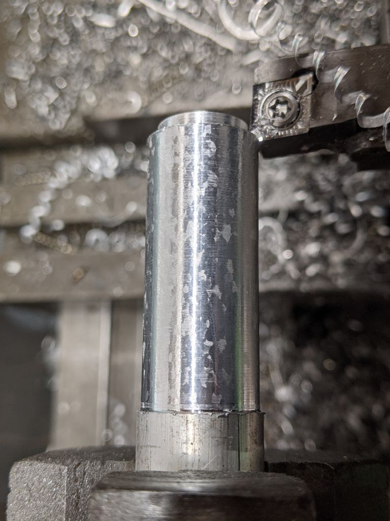

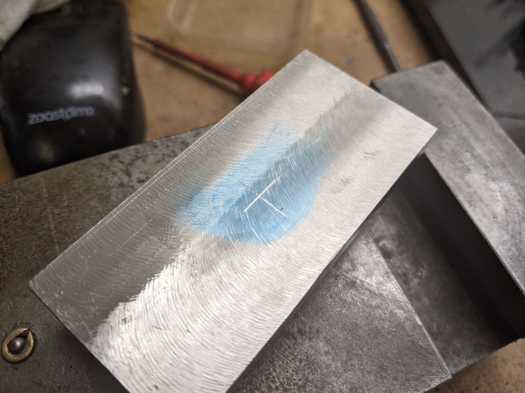

              Speaking of which, I did a bit more turning today, just a little aluminium for a project I'm working on (some incense burners made from wood, but need metal inserts to hold the incense)
              Anyway, when I was turning I did a finishing cut with my cutter and it produced a lovely surface finish, as do most cuts on aluminium. However, I saw imperfections in the surface finish. Having studied metallic structures at university I really should know what this is. However the steel samples I've looked at only showed their structure under microscope after being polished and etched.
              So, just out of interest my question is, are these lighter and darker spots in the aluminium impurities, spots of different hardness, or grain boundaries?
              Also, I took off the side cover after the lathe had been running for some time. I had noticed that the oil level had gone down a little so I thought I'd check to see if I could see the leak location. Pretty hard to miss, It was significantly dripping, even for an English machine, it's excessive. I think It needs sorting asap! Time to take it to pieces again!!!!!
              Back to University on Thursday, with assignments due and exams looming, I suspect a full lathe teardown will have to wait. But I should still be able to tighten the bolts to see if that stops it. Otherwise, it'll be the oil seals again! In which case I will have to order leather ones instead of the double lip rubber ones I used.

                Me thinks those are oxidized aluminium. Was the raw stock stored in a sealed container of sorts?
                  It was just some 20mm diameter. I didn't think oxidization would have penetrated that deep? That was immediately after a cut of around 1mm from the diameter. The raw stock is just kept on a shelf in the garage. I've not seen it on the other aluminium I've been turning. But I don't know what type this aluminium is, I was given it when I went to Scarborough.

                    Not a metallurgist, but crystalline boundaries produced during the extrusion process?
                    Localised heating produced by the carbide tool?
                    I e Does the same happen with shallower cuts, or with HSS?

                          Howard, I'm not sure was much heat in the cut, it wasn't a massive cut. I didn't get time to try shallow cuts or any turning today, the car was in the garage.

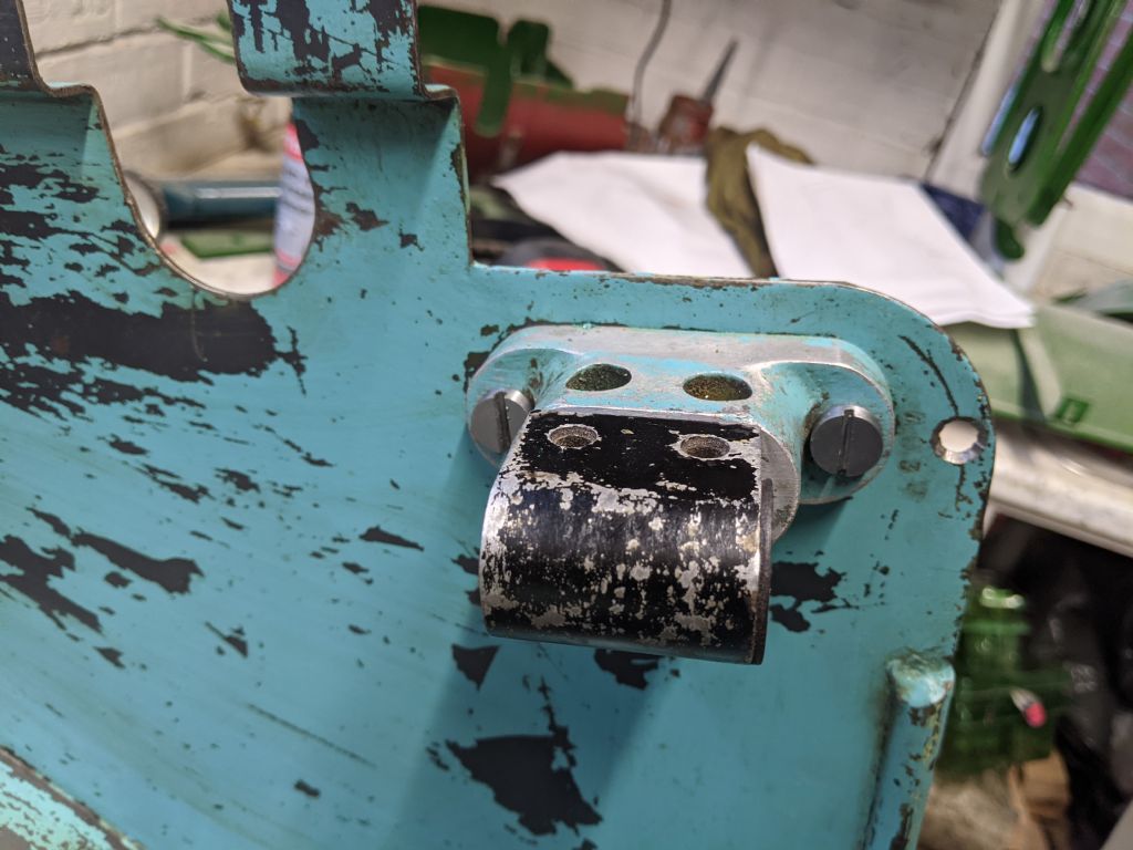

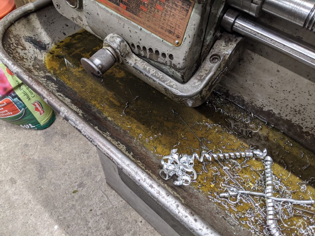

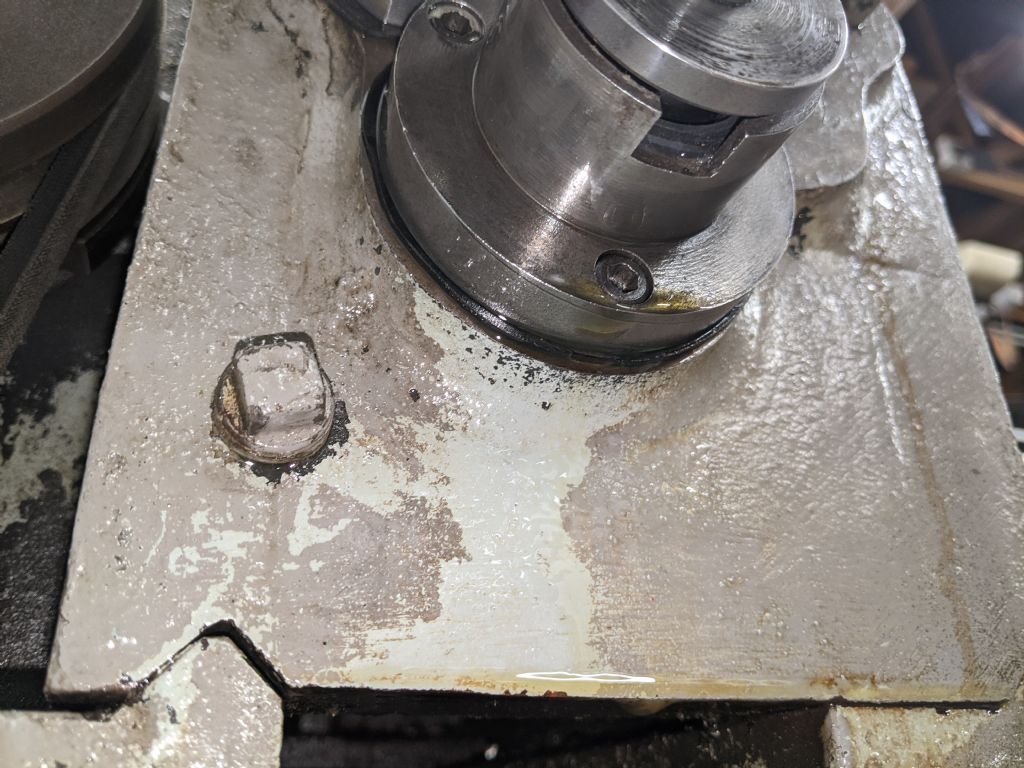

                          As for today's progress, I've attempted to tame the leak.
                          This was the leak when I got home
                          And this was the leak today. Much more oil
                          I suspect the bolts and things have shrunk slightly due to the colder temperature in the garage. Alongside using the lathe heating up the oil will increase its viscosity so it'll leak faster.
                          Luckily I have been doing some wood turning, so it was very easy to mop up the oil. I haven't used this method before, I was surprised how well it worked with nice dry shavings. Very minimal mess!
                          All clean once again. Much easier to see future leaks!
                          So once it was all cleaned I went to where I suspected the leak was coming from
                          The bolts holding these gaskets tight were not fully tightened as snugly as they should be. So I have just tightened them up a little more. Still not overly tight, but I think they're good now
                          I checked to see if the oil seal in there had leaked as well, but it seemed dry when I stuck my finger in the slot. Very surprising. It looks like I've made it work.
                          Anyway I'll turn some more tomorrow. Last day at home so I need to make the most of it. I'll do a little turning playing with the surface finish on that bar, I'll go deeper too and see if its still there. And hopefully warming the lathe up will tell me if it leaks or not! If not, new gaskets need to be made

                            At what depth do these disappear? It can oxidize quite quickly especially in the absence of oxygen.

                                  Sorry, the correct word would be "corrode" in the absence of oxygen. Oxygen is the only thing protecting alu. Take it away and you have many problems. Richard, if I remember lives next to the coast so he most probably is seeing inter-granular corrosion.

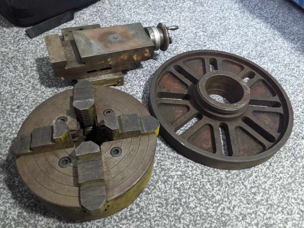

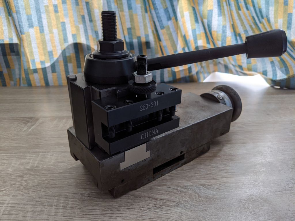

                                        I seem to have acquired a few new toys. I saw these pop up in Grimsby and the seller offered to deliver them to Hull for a very reasonable price. Not extremely cheap, but I'm very happy.
                                        Now I won't have to cut up my 4-way tool post in order to attach a QCTP. Hopefully, there will be a fun build making the T bar to go in the slot and making the mounting post(depending on if the QCTP comes with one) I'm considering this one. Alongside this being a nice upgrade for the lathe, my topslide is quite worn and is easy to turn at one end, and very difficult to turn at the other, so this should be an all-around improvement. I'll take the best parts from each and put them together.
                                        Arc QCTP
                                        I didn't really need the 8 Inch 4 jaw, but it's not often I see them come up, and for the price, it was worth it. The faceplate may come in handy at some point as well. Plus it'll be fun to clean and paint them both.

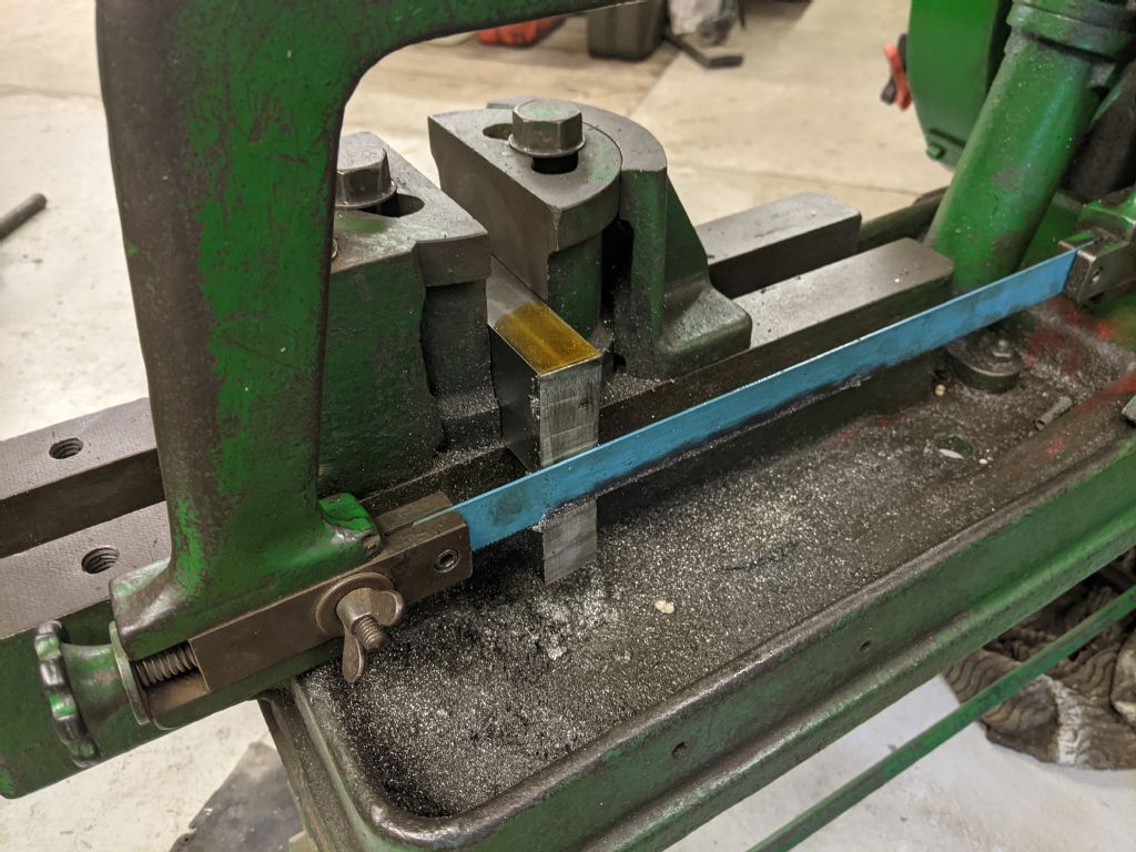

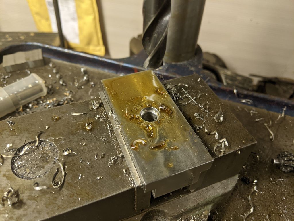

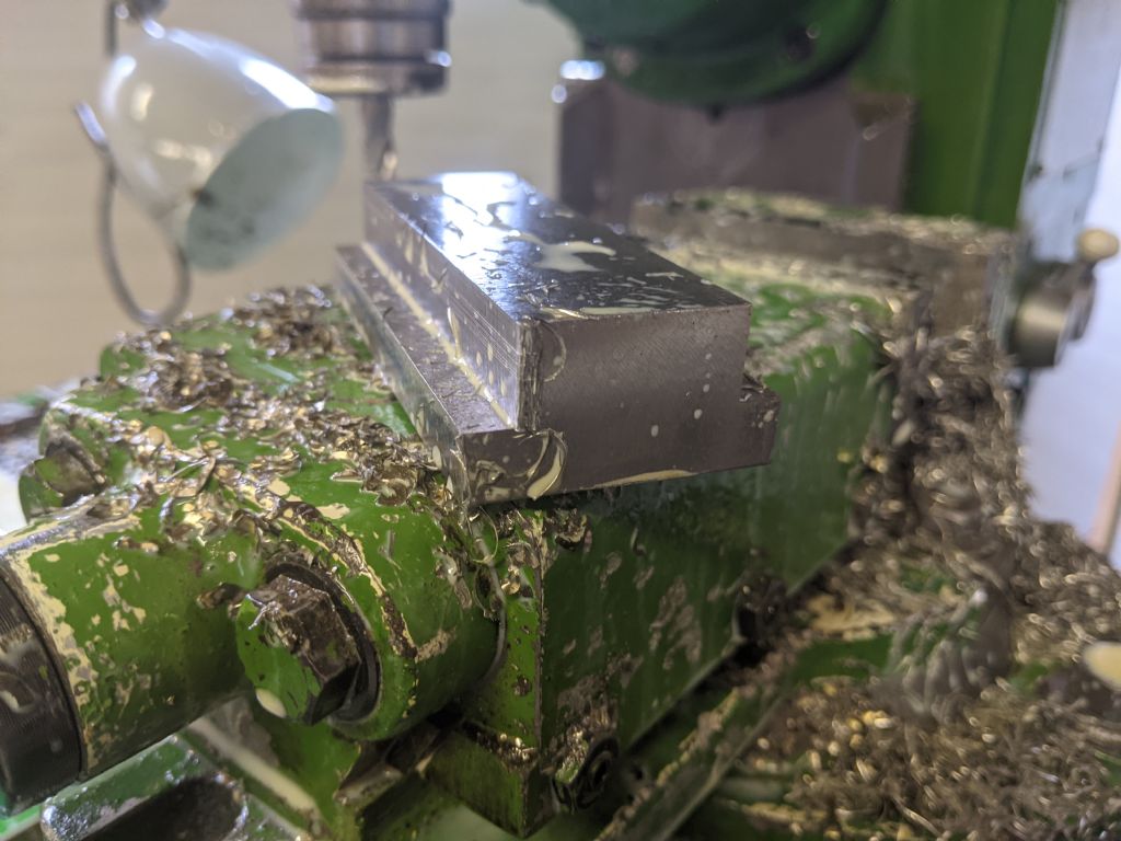

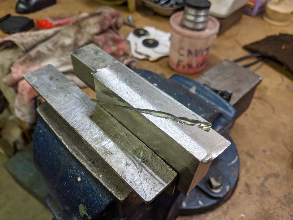

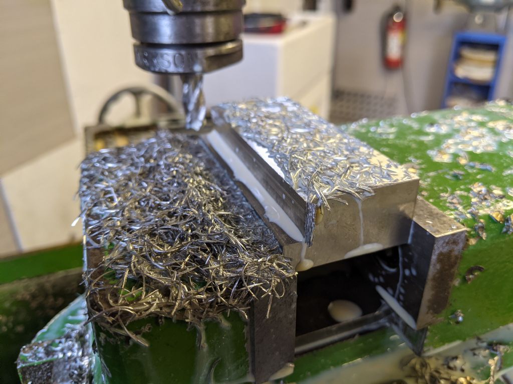

                                              Quick update

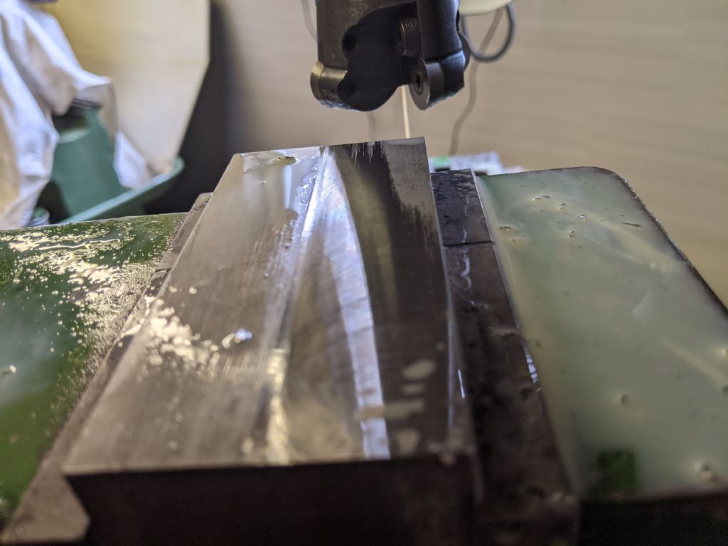

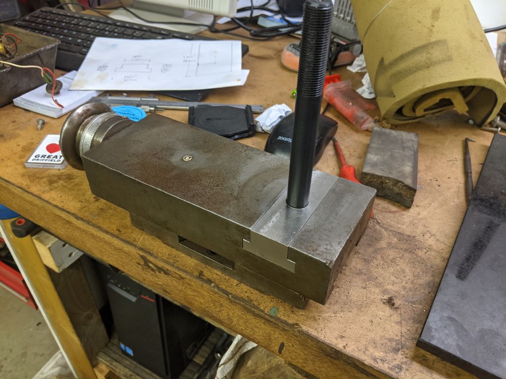

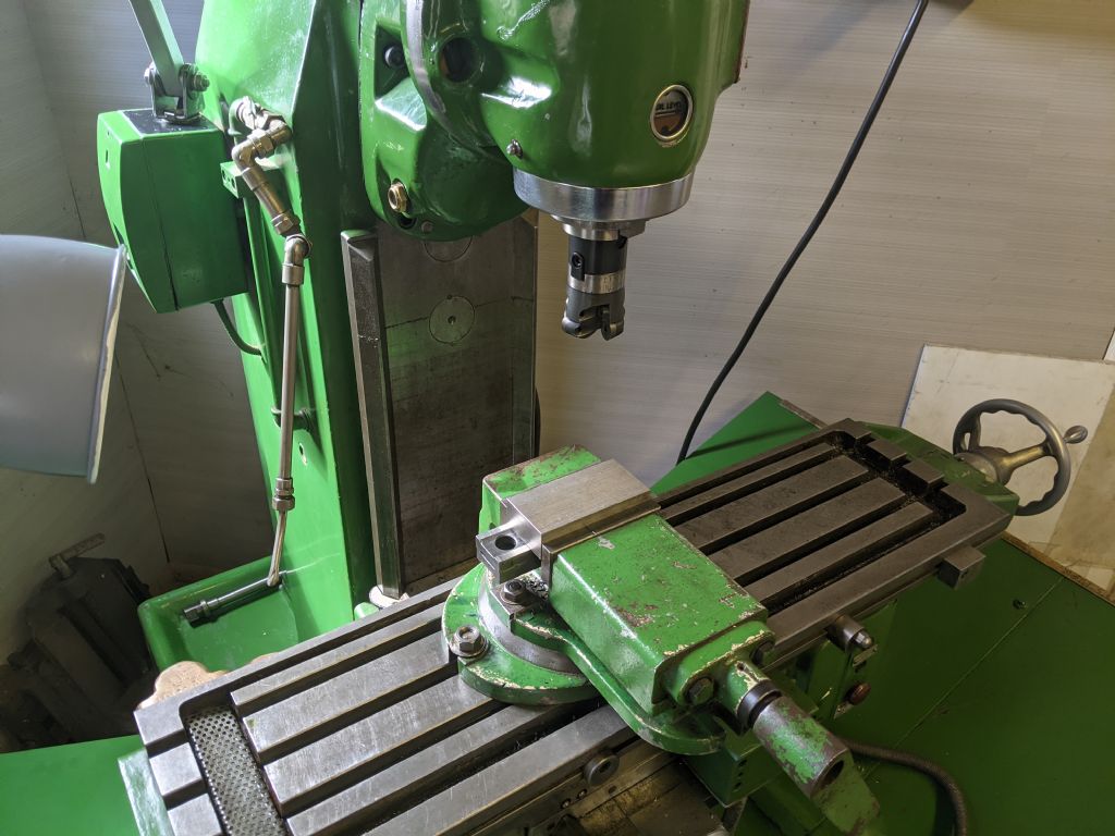

                                              I no longer have access to a milling machine at home, so I enlisted the help of Phil to machine me a 304 stainless steel t-nut for the top slide so I can mount the new tool post.
                                              I did initially go to the university engineering workshop to ask for their help but they were not interested as it was hard steel and they wouldn't let me in to do it either.
                                              So, Phil helped me out greatly. Big thanks to Phil for all of his help
                                              304 is a pretty tough steel, especially for an unexperienced person like me, but we made the best of it. We started using a face mill to make the block square, then we took it to size.
                                              Cleaning it up gave quite a nice finish. Although I did get some chatter later on.
                                              The end dimension had 10mm to come off, so it was much quicker to cut it off with Phils very nice mechanical hacksaw.
                                              Some faces had 1mm or two to come off, so It took me quite a while when taking 0.2mm cuts. The steel got some very nasty burrs too, if that's the right word when they're so large! I presume that'd due to the steel being hard and due to my milling direction.
                                              Then I cautiously moved onto using a hss endmill to cut in the slots. After 30 passes of 0.2mm cuts we has a 6mm recess for one side, then the other side was done.
                                              The hss worked surprisingly well. I had bought a carbide endmill to use, but it wouldn't fit in any of Phils chucks.

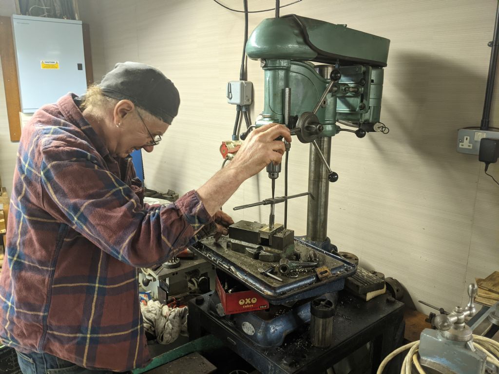

                                              Now to size, it was time to deburr and drill the hole
                                              The drill size was stepped up very gradually as the metal is tough and we didn't want to work harden it at all.
                                              Then we got the 5/8ths sae tap to go in the hole and lead it in using the drill press to ensure it was square
                                              The tapping was slow but worked well with lots of lubrication. But it all went smoothly from that point. A very nice fit for a novice like me! Room for improvement in the future, but I'm happy.
                                              Tool post fitted. I can't decide if I'll turn down the extra thread on the end. It doesn't add any value, but who knows if I'll need it in the future.
                                              Next step is to get back home from university and disassembly everything to clean and get parts from both top slides to pick the best of each. Then onto some turning!
                                              Thanks again to Phil for his time and help, if you want to see more there will be some footage of the milling on his Youtube channel.
