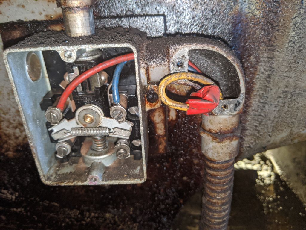

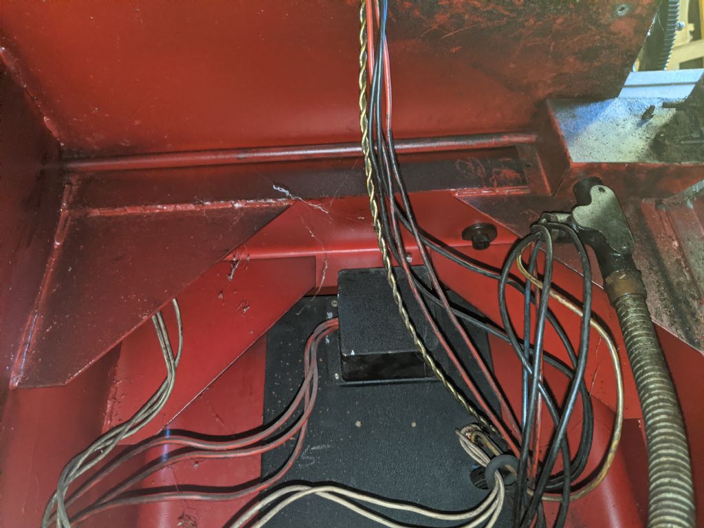

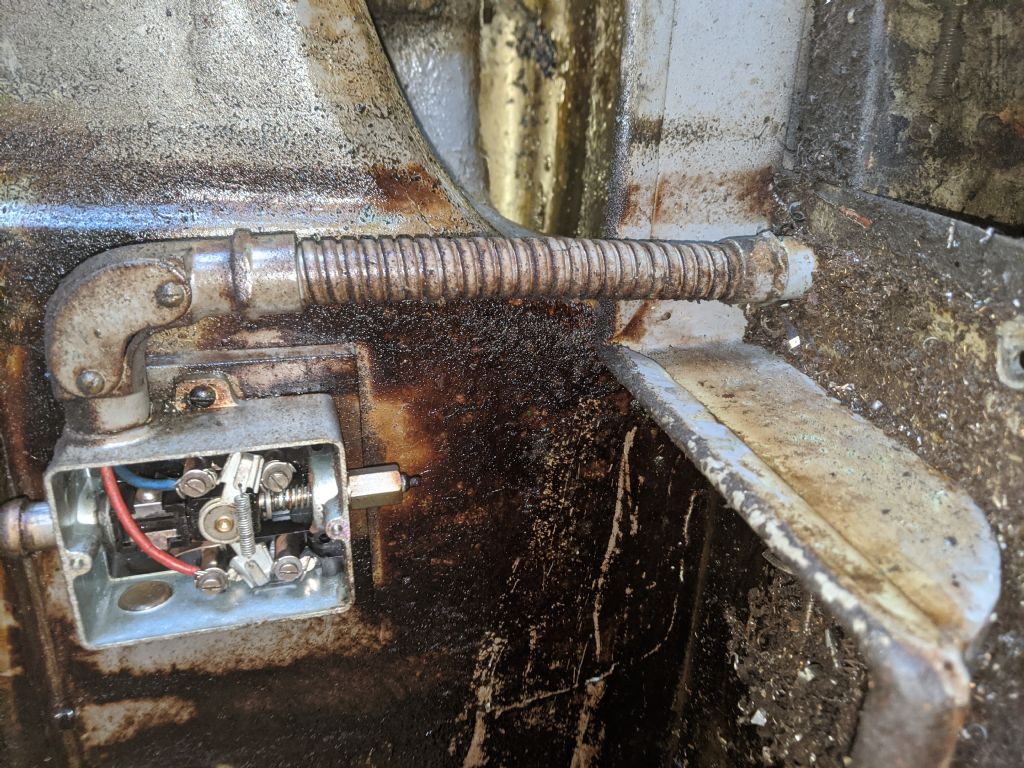

            Richard Kirkman 1
              @richardkirkman1
              Posted by Phil Whitley on 13/12/2019 21:01:48:
              we need some sound on the videos!!
              Phil
              The videos should all have sound, not sure why you're not getting any. There should be a speaker at the bottom left you can click on
              I had the motor out before and it seemed to be spinning fine, but I didn't leave it to run for long.
              I also took the brake to pieces and its working fine.

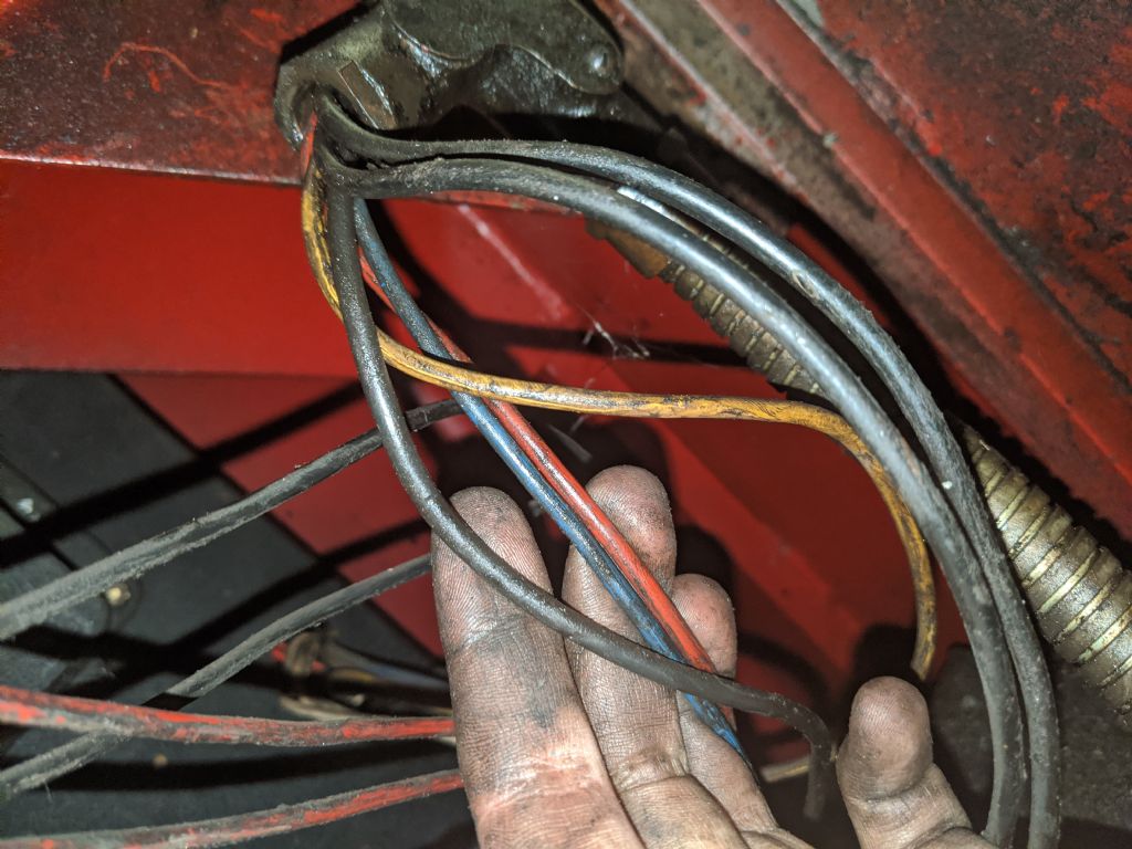

              All the safety switches have definitely been cut out of the circuit as it shouldn't run with the end cover off, but it does. There's no logical reason that they would have been taken out though, so you may be right. I still think the contactor is broken and is just being used to transfer the power, with no no-volt release. The contactor is always in contact with the circuit, it never stops being attached, so perhaps the spring went and they decided to cut it all out.
              The same yellow wire from yours is disconnected at both ends on mine
              I know someone who's tearing down a colchester student so even though the lathe is working for now, i'll see if i can get her to sell me the control panel and components from her lathe. So I can just replace the whole thing.
              This is a video of the motor by itself and you should have audio, it runs okay, not the smoothest, but decent enough. Perhaps a little rattley, but nothing serious. I'll run it tomorrow by itself and have a play around

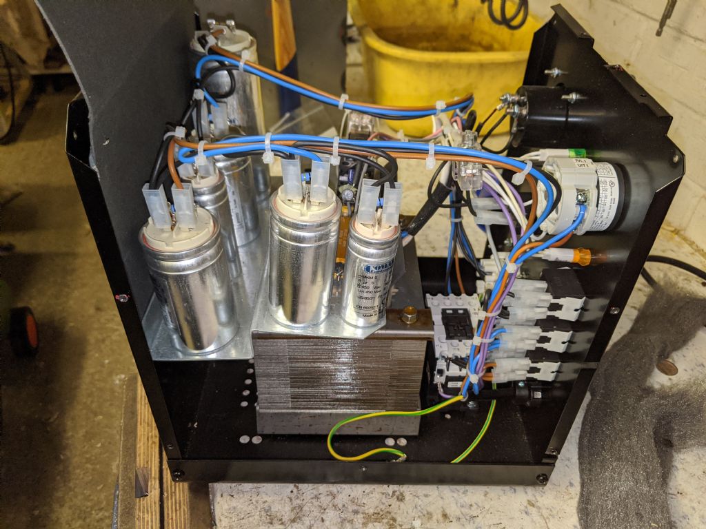

                          Taken the top off the converter, I can't see anything wrong particularly. I've had issues with capacitors before so I could probably notice. My multimeter doesn't measure farads since it's just a cheap one, so I can't test the capacitance of each with that method.
                          It's definitely an old converter though, it's last safety test was in 2017.
                          I have the receipt and I have a video of it making the clunking noise. So machine Mart should just take it back with no quarrels. But it depends what people would recommend me to do next
                          Thanks

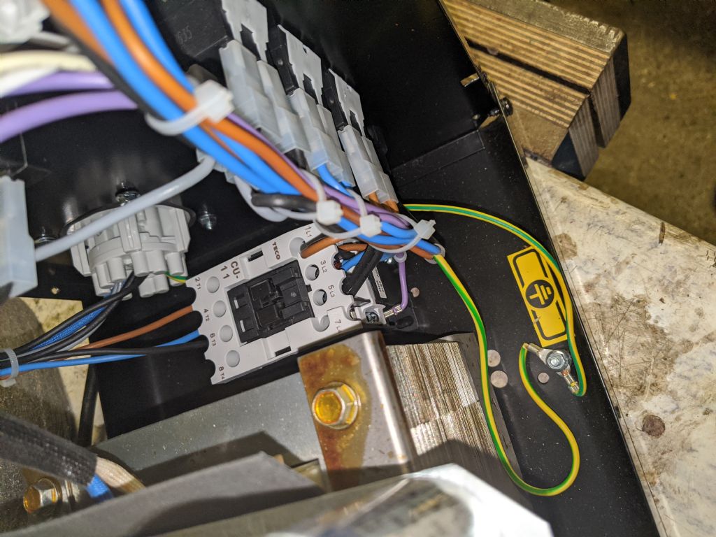

                            hi Richard, have you checked that all the screws on the phase convertors contacter are tight? that is it in the last picture. you could start the lathe with the cover off the phase covertor to see if you can see anything arcing, but check all the screw connections are tight first. if the machine mart warranty covers it, I would suggest it is faulty, because the motor seems to run smooth and quiet as soon as the convertor stops rattling, and I don't think you could overload a 3hp convertor with a 1.5hp motor unless there is a poor connection through the lathe contactor, and the convertor is not consistently " seeing" all three motor windings. also check the terminals are tight on the convertor outlet socket.
                            phil
                            #441647

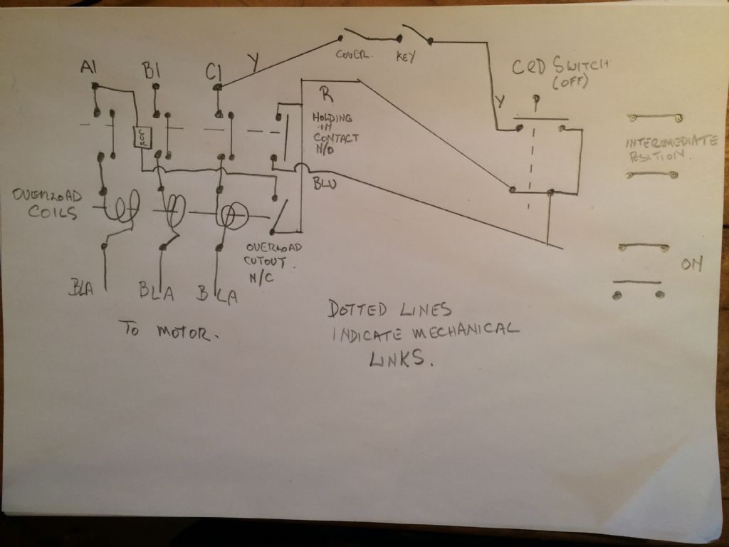

                              wiring diagram corrected and made readable! this is the one for your lathe as it should be. I have taken this from the manual you downloaded to my computer, cleaned and corrected it! N/O =normally open contact. N/C=Normally closed contact.
                              #441658
                              Richard Kirkman 1
                                @richardkirkman1
                                Posted by Phil Whitley on 14/12/2019 18:46:29:
                                Thanks Phil thats absolutely fantastic
                                The contactor in the converter is all secure and fine with the wiring. I'll try starting the lathe with the components visible tomorrow morning and get back to you

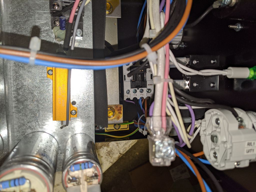

                                Richard Kirkman 1
                                  @richardkirkman1
                                  Just back in from the garage, It's very cold in there!

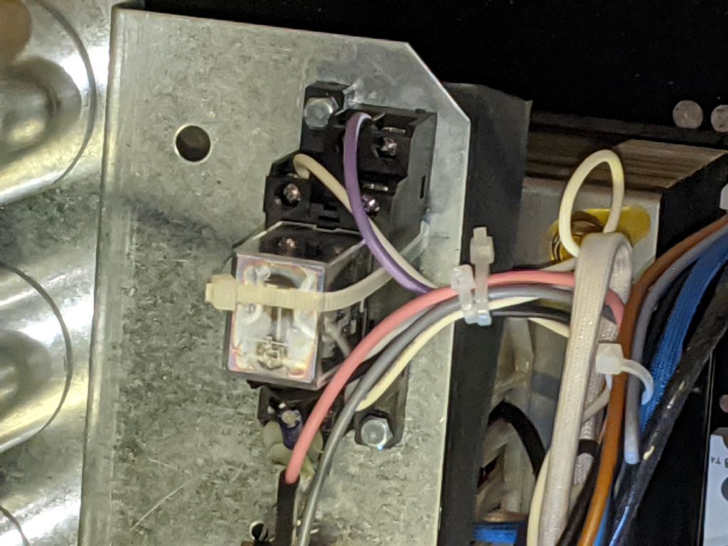

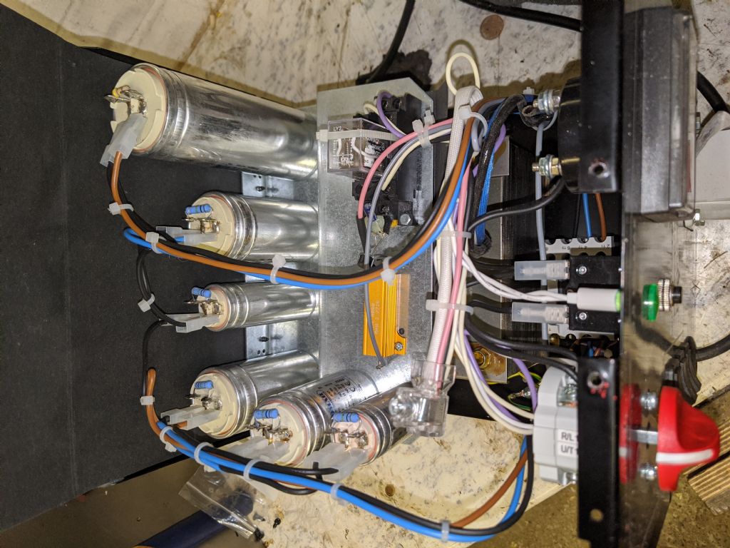

                                  I've taken the top off and run the lathe. The noise seems to be coming from a small component
                                  I've tried to get a few videos of it, you can see some little paddles working and arcing occasionally.
                                  Mal, the man who said he ran his pc40 on his student for years, messaged me back and said that his pc 40 made these noises too when it was on its last legs. So, i'm going to take this back to machine mart and order a pc60 which he says runs everything. Should also future proof it in case i ever get any more 3 phase machinery
                                  I'll be interested to see if machine mart has any quarrels with me taking it back

                                            Excellent! my feeling is that the small contactor in the plastic box, which I assume is single phase side, switches in the main contactor on the base of the unit, which is on the three phase side, it could be that servicing all the contacts in both relays would cure the problem, but not your job if it is under warranty. Also if there is some sort of overload protection in the unit, and I am sure there will be, that also could be faulty, and breaking down partially when there is load on the convertor. Having no experience with this type of phase convertor, I now realise I should have asked you to turn it on without the lathe connected, to see if it still rattled, which would condemn it as definitely faulty! No matter, we await the next thrilling installment with baited breath, and it distracts me from the triple shower and bathroom pump problem I also have on the go!
                                            On a different tack, it could be that a fault on the lathe or the lathe wiring is causing intermittent loading on the phase convertor, and thus causing it to trip off and then restart, possible, but not probable. is the lathe contactor pulling in when you operate the lever on the lathe?, it could be that one of the contacts is not making properly. the lathe contactor must be working to an extent, because the C&D switch only completes the circuit to the coil in the contactor, and then the coil pulls the contacts in the contactor together to connect all three phases simultaeneously to the motor. Unfortunately, you cant observe this with the lid off, as removing the panel from the lathe disconnects the supply! Did you make a new contact to replace the one you found in the bottom of the box?

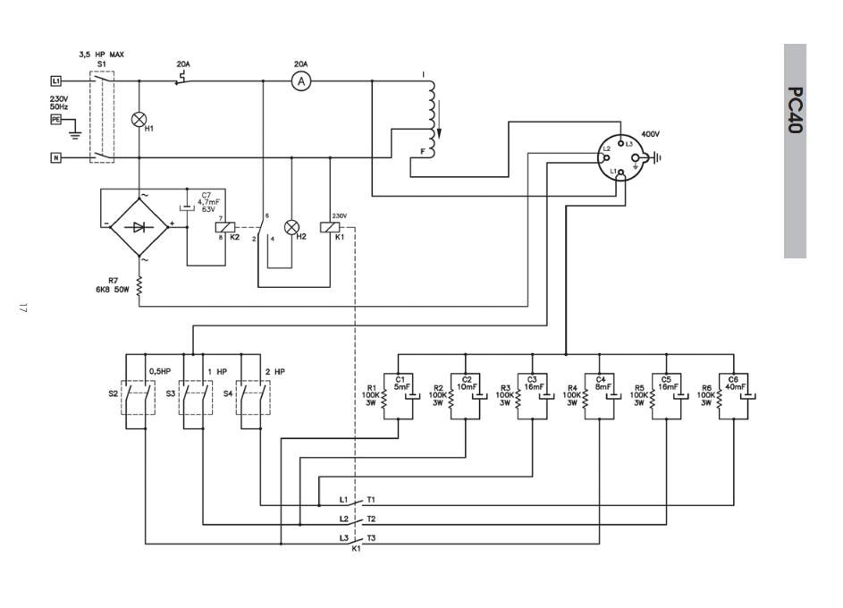

                                                  I wouldn't assume the PC40 is necessarily faulty, or that replacing it with with a new PC60 will result in success!
                                                  Richard mentioned his lathe dates to 1955 and I'd have guessed earlier. The electrics appear to be original, 64 years old, and the lathe has not been kept dry. Furthermore someone has messed with the wiring, presumably in an attempt to get it going. To that I'd add the possibility that the drive train is gummed with old oil, or that new oil is stiff because of the cold weather. Maybe this adds up to more than the PC40 can cope with.
                                                  The other issue is the sort of device the PC40 is – static converters have distinct limitations! This type of converter isn't recommended for heavy or intermittent loads. From the manual:
                                                  The circuit shows the device briefly bodges an approximation of 3-phase with capacitors as a way of starting the motor. It doesn't output continuous 3-phase like a rotary converter or a VFD. The motor cannot develop full power.
                                                  Although the necessary capacitance is broadly related to the motor's output power, it's not that simple. The switches marked 1HP, 2HP and 3HP don't set power output, rather they add or subtract capacitors as necessary to match the motor to get enough phase-shift on the 3rd winding to start the motor. Page 8 of the manual shows 7 switch combinations for 0.5 to 3.5HP; the user should experiment for best starting.
                                                  Once the motor is rotating, I believe relay K1 disconnects the capacitors and leaves the motor running on two windings only. This considerably reduces the power output of the motor compared with what it would do with real 3-phase. I suggest the relay chatter is due to the PC40 thinking the motor has started and then detecting the motor is stalling, thus kicking again by reconnecting the capacitors. It's hovering on the brink of a successful start.
                                                  Note that the capacitors are only used during starting. Using this circuit for frequent stop-start work, as on a lathe or mill will shorten their working lives.
                                                  As the device is distinctly limited, they aren't suitable for all motors, or operating style. The manual says:
                                                  Thank you for purchasing this CLARKE Single to 3 Phase Converter. i.e. to run 3-phase asynchronous motors ONLY, from a 230V single phase supply.Please note that this device, because of its characteristics is for use primarily with constantly running motors. It is not desirable for use with stop start operations.
                                                  and
                                                  For some applications of small motors, or motors of unusual magnetic characteristics, it may be necessary to provide a pilot motor to obtain a balance of phases. Generally the pilot motor should be a 2 pole (2800 rpm) motor and as a general guide should be at least twice as big as the motor to be driven.
                                                  Why is the motor stalling? The PC40 must have done it's job as a starter, but maybe its autotransformer can't deliver enough amps to keep the motor turning. (A PC60 has a bigger transformer.) Or equally likely, it's because the lathe is stiff! Could be the motor would run OK on a warm day with clean bearings, but December in a clogged state is just too much. (Measuring my WM280 in a different context showed just turning its spindle, gears and leadscrew takes about 200W)
                                                  Longer term, I think a VFD would be a better solution than a PC60,. Apart from a VFD producing genuine 3-phase and getting the best out of the motor, a PC60 needs a 32A single phase supply!

                                                      the K1 relay switches the starting capacitors out of circuit, the running capacitors, set by the switch bank stay in. if you look at the above posts you will see the motor running both out of the lathe, and in it, turning the gearbox and chuck and in both cases, when the rattling of the contactor stops, the motor shhots up to full speed, and runs normally. From the circuit diagram above, when the motor starts, there is a voltage fed from L2 via a resistor to the rectifier which pulls K2 into the start position, and causes K1 to bring the extra capacitors into circuit. When the current falls as the motor gains speed the limiting resistor stops passing enough current to operate the rectifier, and K2 drops K1 and the extra capacitors out of circuit. In the above videos of the inside of the PC40 when operating
