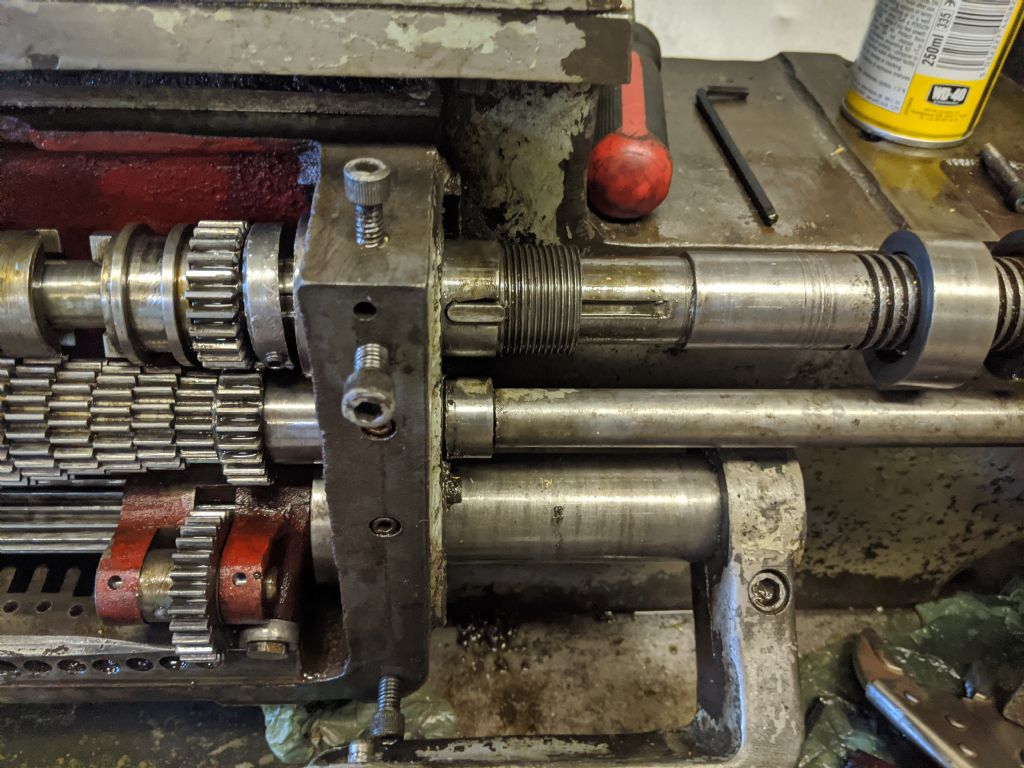

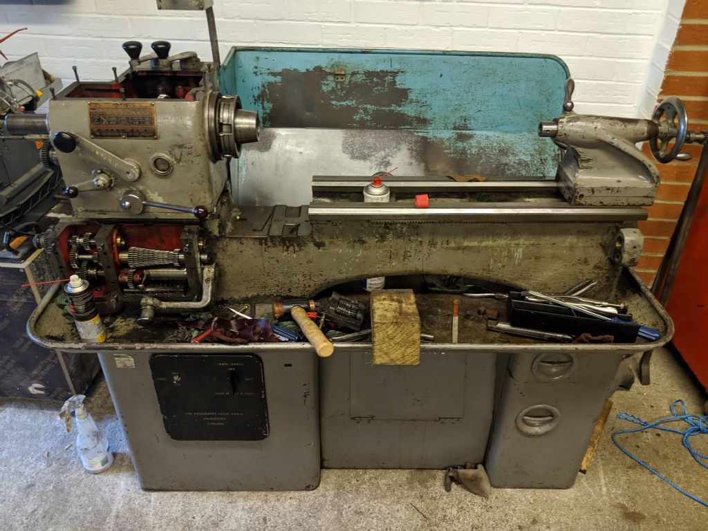

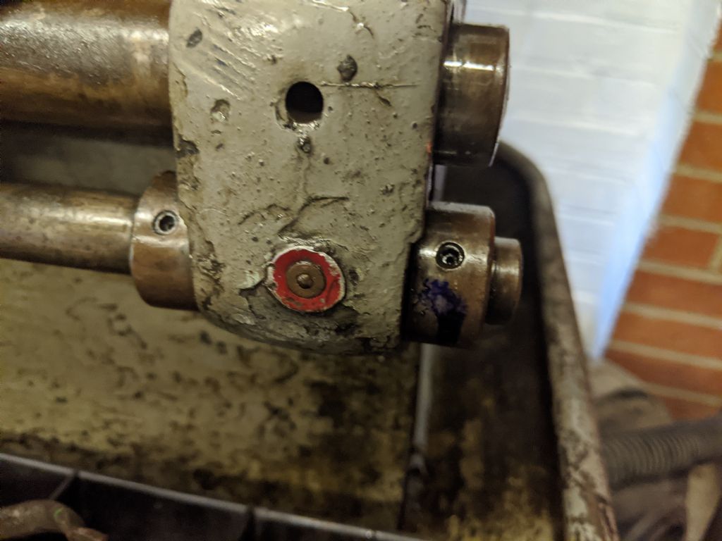

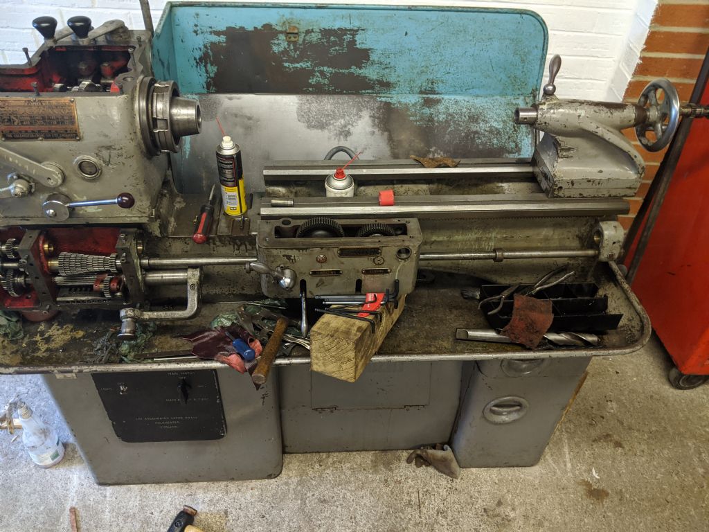

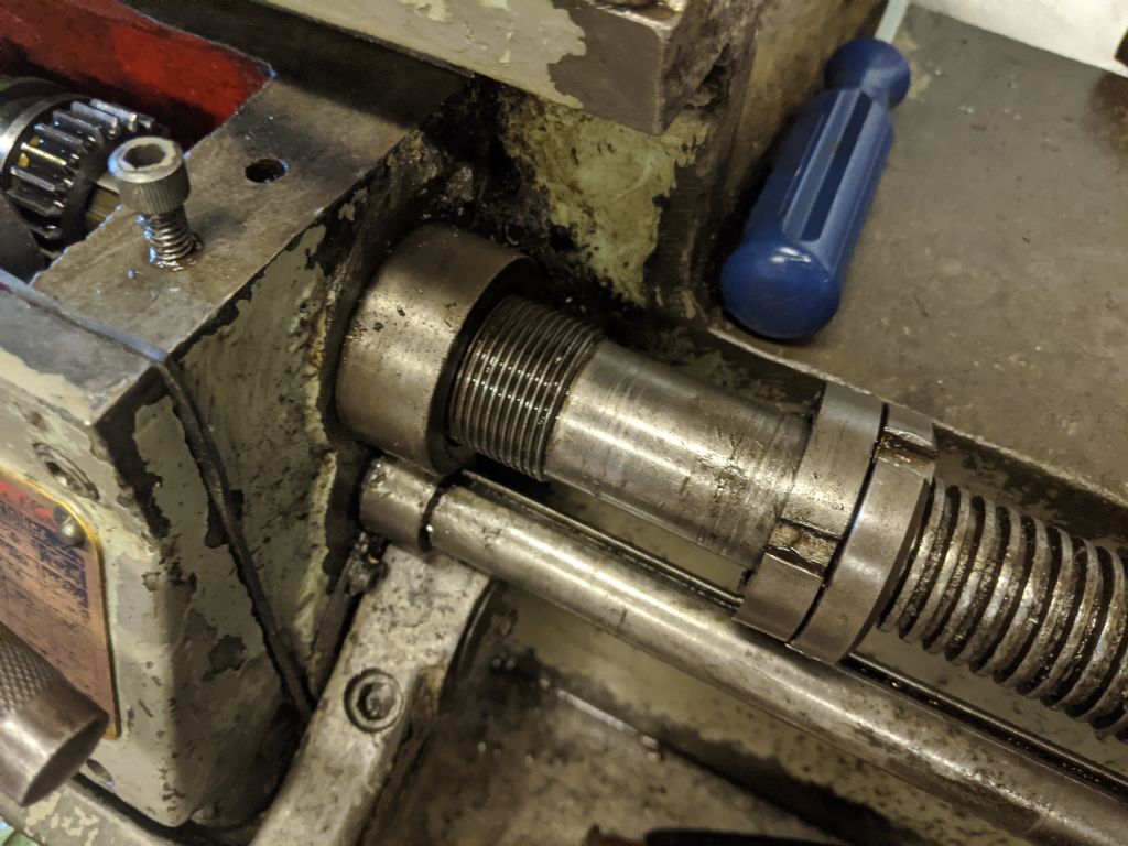

          A little bit of progress today, although now I'm stuck

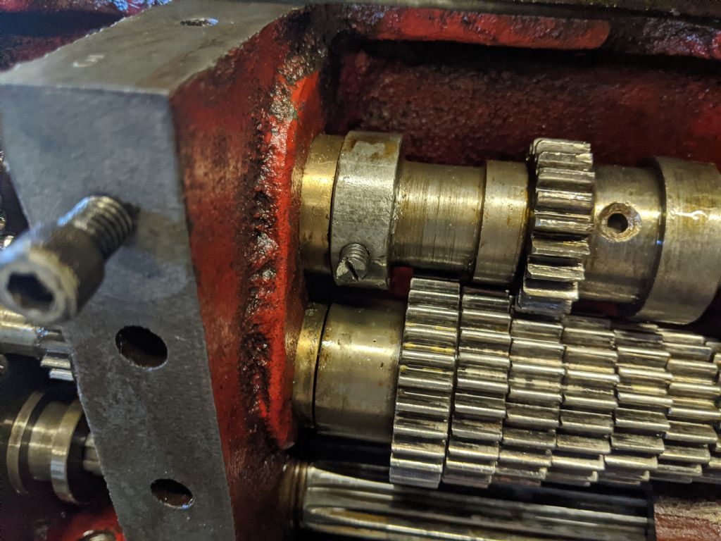

          Getting the leadscrew out proved a bit more difficult. There's a step that Herman missed in his post so I didn't think to undo a screw and it left me just scratching my head for a while. Until I'd had a cup of tea and thought about it properly
          So the first step was to undo the collars. They came off quite easily, although I will clean the thread out and make sure they fit better when they go back on, as they were stiff in certain places and slacker in others.
          Then my inner collar had a set screw instead of having slots like Hermans. I put a bolt in and used that to turn it a bit. The marks were already on the collar, so someone must have been in here before me. That's not to say I didn't leave some more…
          Nothing I can't clean up before reassembly
          At that point I went to the end and looked at the set screws down there. Thinking about this further, the grub screw only holds in the bushing, so shouldn't effect the leadscrews removal.
          While I was down there I also removed the grub screws from the collars on the feed shaft. But, the outer one's set screw is stuck and the Allen key just spins. No good, but at least its the outside one rather than the inside one. The inside one came loose very easily
          At that point I thought the leadscrew should have been free to move along a bit, but it would not move far. So I took a look at the shaft and thought that it was a bit dirty so I cleaned all the muck off. I plan to sand down the leadscrew for 370 hours to remove all the imperfections and then polish it until I can hang it in the bathroom and use it as a very small cylindrical mirror, as that's how all functional lathe parts should look! Bling must make it work better!
          Anyway, joking aside, then I sat around for a while and had a break. I came back with a fresh perspective and tried to remove the screw in this gear first, resulting in the leadscrew coming out a bit, then i could unscrew the collar some more, then get the leadscrew out further and so on until the leadscrew was free!

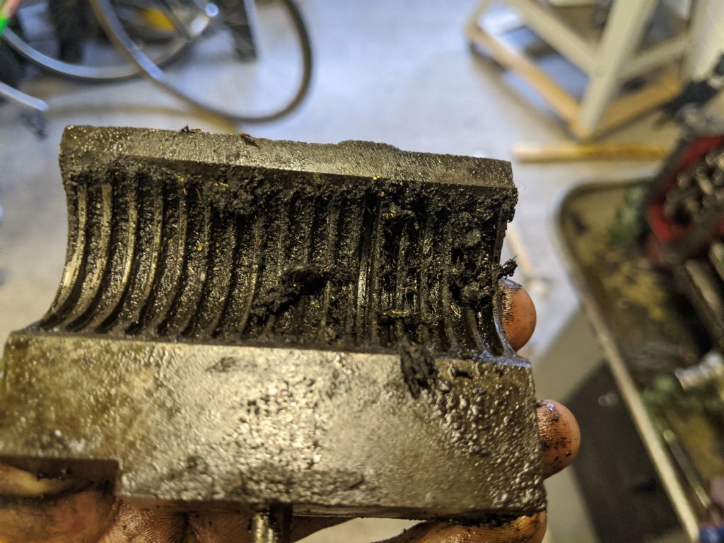

          Having the leadscrew out allowed the half nut to drop out, since the shaft is shorter and broken. The feed shaft needs to come out to allow it to be reinstalled once fixed. The break lines up perfectly when its aligned
          Definitely worthwhile taking it out, especially for a clean. Probably 2mm thick gunk at the bottom. Not good

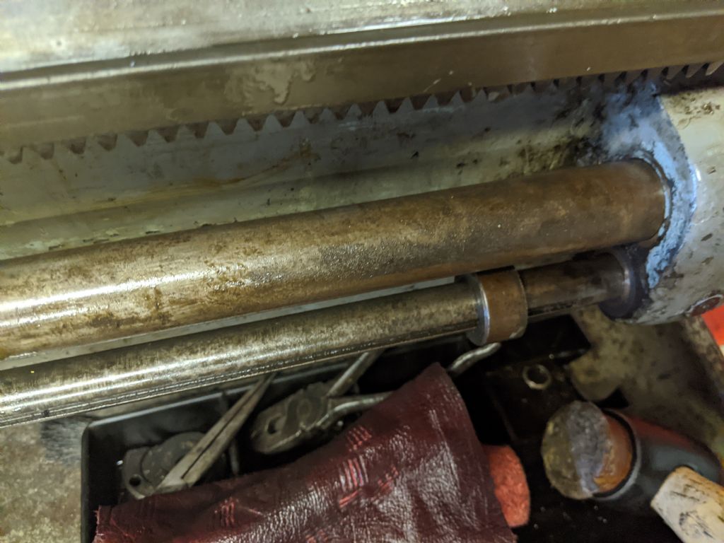

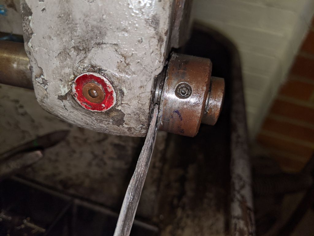

          Anyway so now I'm stuck. I cannot get the feed shaft out. It should just slide out. It will move about 2mm and then it just stops. It definitely feels spring-loaded like Hermans should have been, but I gave it a very good tug and I can't get it to budge. Any ideas? I've checked for pins and things like the later models have, but I haven't found anything.
          However, I did find something coincidental. At the back of the gearbox, since the gears have been removed, I can now see that it says 5 AUG. Which may refer to the 5th of august, which happens to be my birthday. It probably doesn't mean that really, I can't imagine they'd date all their parts like that. In which case, what does the 5 AUG mean?

              Try and do what I did with the feedshaft: "So I put the external end collar back onto the feedshaft, but left enough room between it and the support to allow me to insert an aluminium bar in the gap. Applying a bit of leverage made the feedshaft move to the right."
              Your feedshaft clutch look exactly the same as mine did, so it will be stuck badly. You can also add a strap around the shaft with a rolling hitch knot and pull the shaft to the right with a pulley or block and tackle.
              On the apron, clean the selector handle. I think that it will be filthy and will not move freely and that allowed the half nut to only engage partially and snap under rotation. Also look at the wormbox holes and check if these are not oval as mine was.

                I don't have any aluminium bar lying around, so I may try the rolling hitch, to begin with.
                I cannot remove the end collar right now since the grub screw is ruined. I will try again if all else fails.

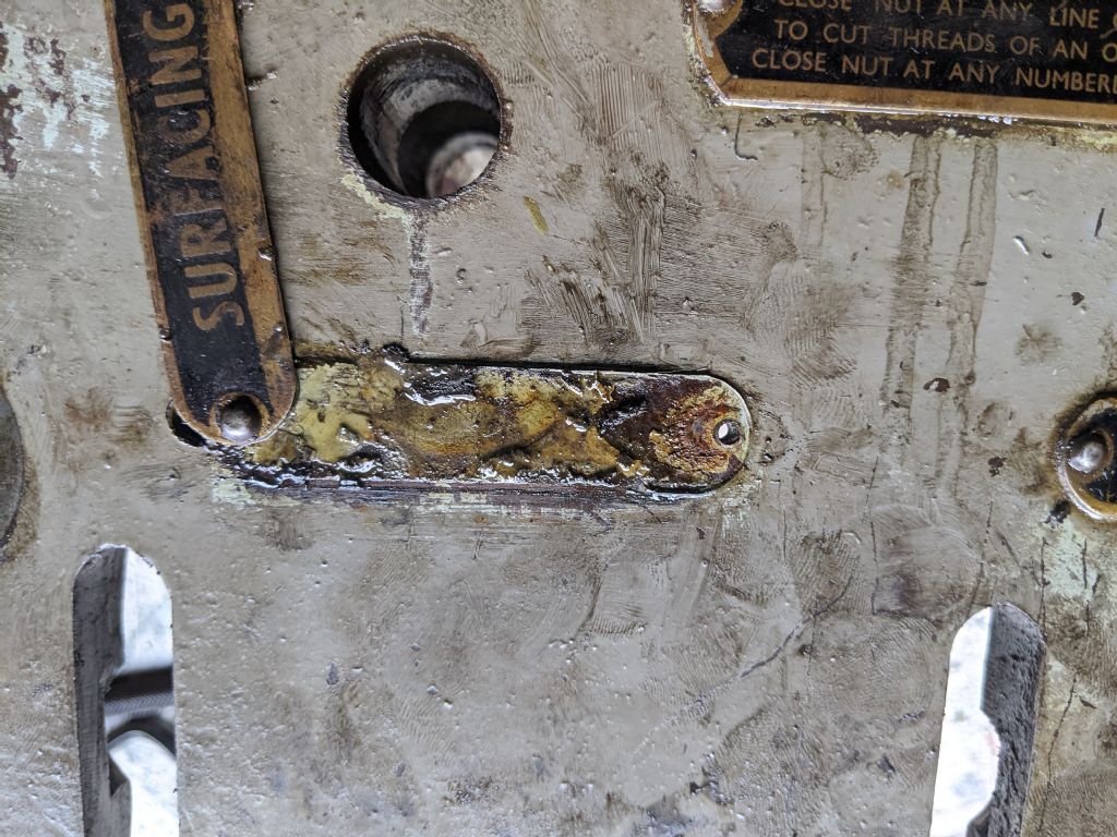

                The apron is all going to receive a thorough clean once it is off. I had given it a clean before, but never with full access. Yes, completely it definitely has snapped under rotation, but I did get the full movement of the handle before, just bad engagement and disengagement due to the shaft not being long enough to run in the slot vertically.
                I'll check for oval, but even if it is there I don't think I have the time to deal with it right now. But I do want this lathe to last me a life time, so perhaps one day I'll do it.

                #489137
                Richard Kirkman 1
                  @richardkirkman1

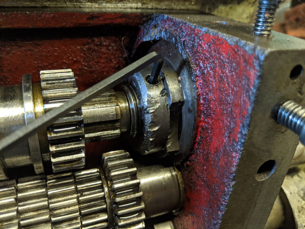

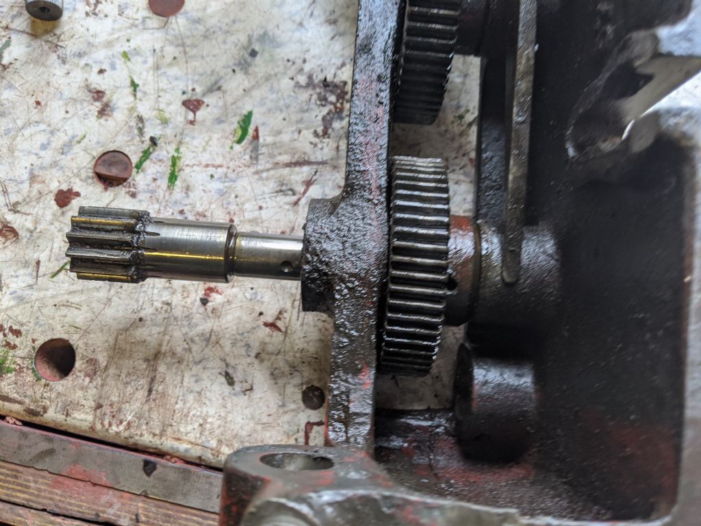

                  Result!
                  After an hour of fiddling, one good pry and it just popped out.
                  However, I started off by trying the knot method. This worked better than expected and it did hold the shaft, but even with me pulling it, there wasn't enough force to get it out
                  I did find a small bit of aluminium, but it was only 1-2mm thick, so didn't do much
                  I spent a while struggling and thinking what to do, pulling on the shaft occasionally, to no avail
                  Then suddenly I had a fantastic idea that I don't regret in the slightest. Not ideal, but i decided to get a nice screwdriver and stick it in the end collar and give it a gentle pry. And there was a quick pop and it came out. I didn't have to apply much force at all. I was quite surprised. I had tried with a smaller screwdriver but I wasn't applying much force at all as I am aware of the damage they can do. Luckily it worked out this time.
                  Then I carefully held a bit of leather around the collar as I pulled the shaft out, for one of the balls to still land in the chip tray. I have them both, so no loss yet.

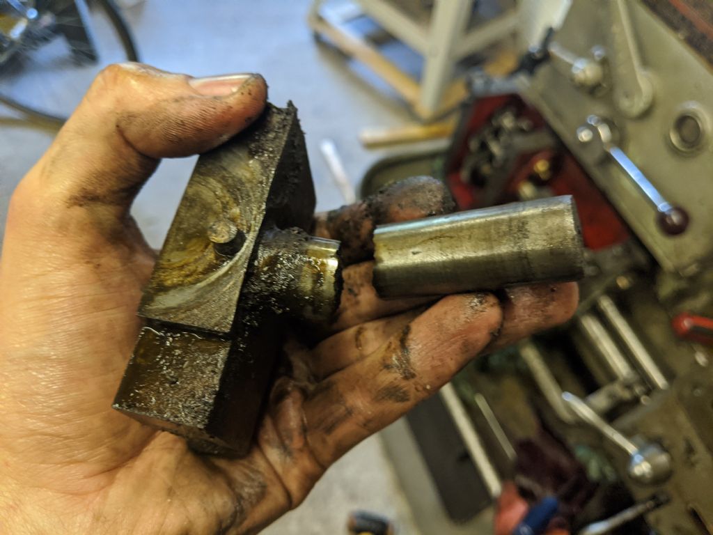

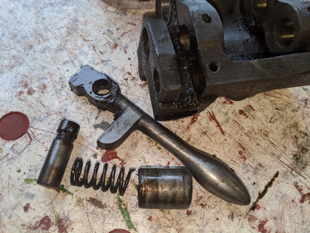

                  I was interested to see that there isn't just a spring in there. Well there is, but it's not just a spring, looked different. Not quite sure. I don't want to mess with it as it worked before.
                  Took a bit of effort, but it slid out eventually
                  And now I have a very bare lathe. I could put it back together and have a lathe without feeds
                  Whatever this bit is called, is very dirty
                  In fact the whole thing is dirty. I will be cleaning for a long time
                  As for the holes, they are not as oval as yours Herman, but they are ovaled by less than 0.5mm, so I think that's good enough for my use. Maybe by the time i'm 50 I'll re do them. But Hopefully this lathe will have an easy life with me.
                  More gunk under, followed by more gunk
                  Anyway, time to get on. Apologies for the screwdriver sin, but it couldn't be helped and it got the job done!

                      the two balls and spring are an overload clutch designed to let the shaft slip if the feed gets jammed, there should be, or at least there is on mine, a screwed plug that goes in the end of the shaft which adjusts the tension on the clutch.  actually I think there should be three balls, one pops partway out of each of the two holes, and the third one is between the spring, and the other two. now you have the lead and feed shafts off, good time to degrease the front of the bed, and get some paint on it!!
                      Phil

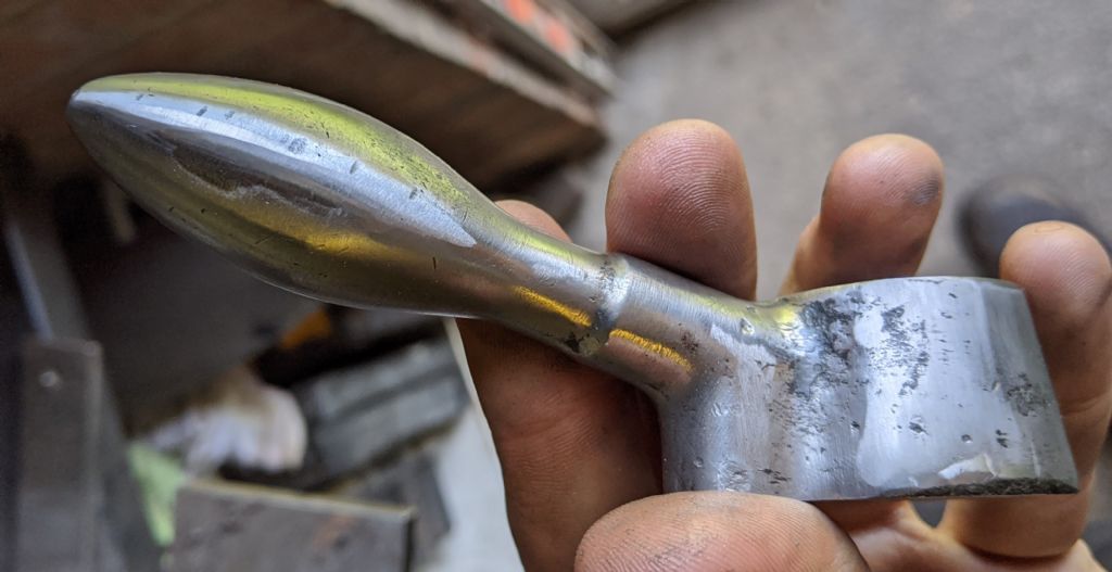

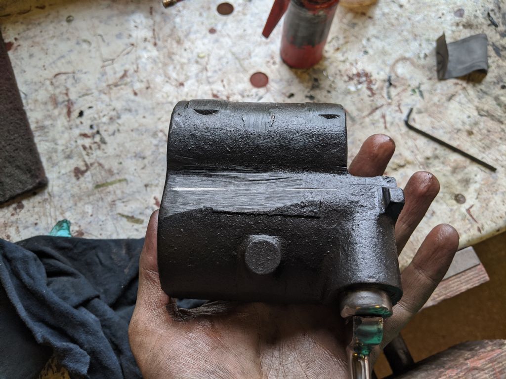

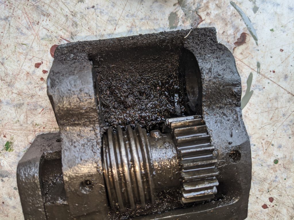

                          Very long post ahead. But with good progress so I'll dive in

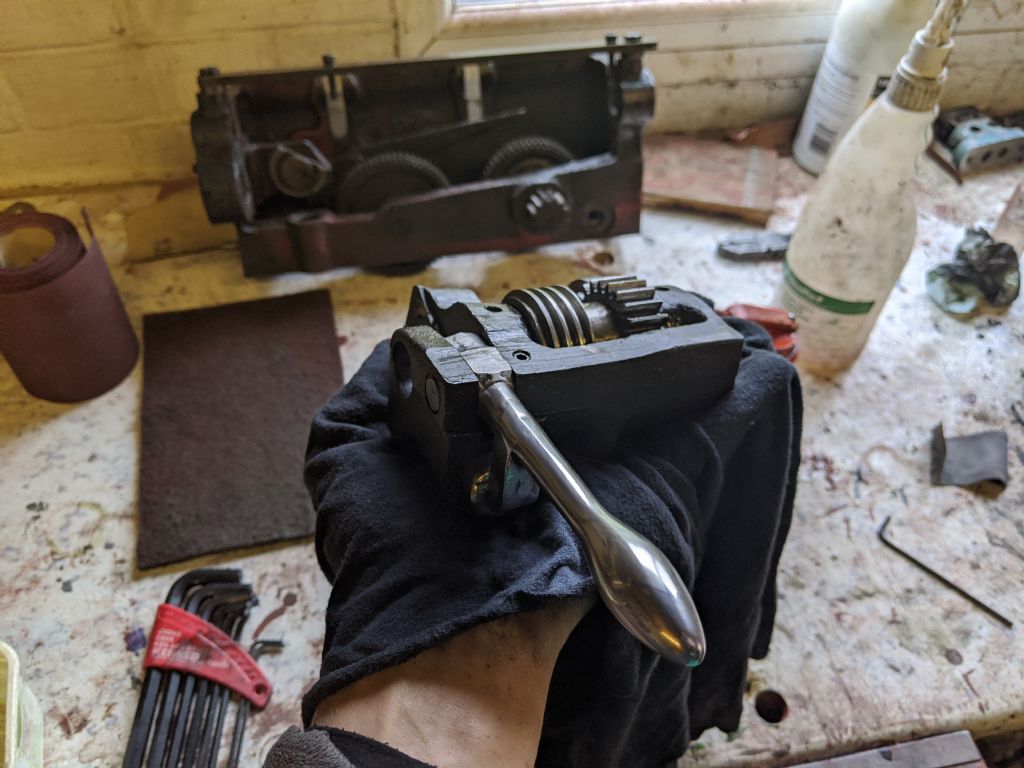

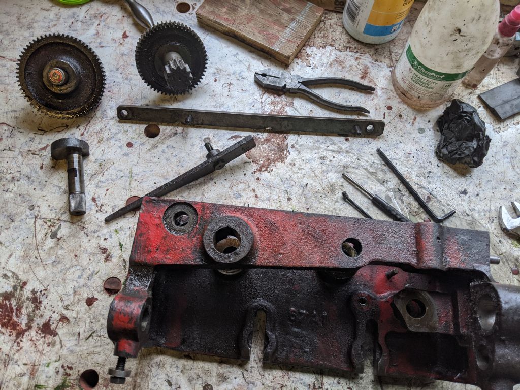

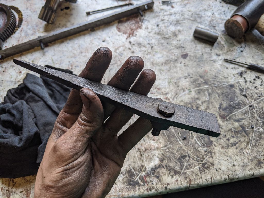

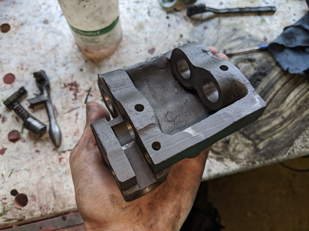

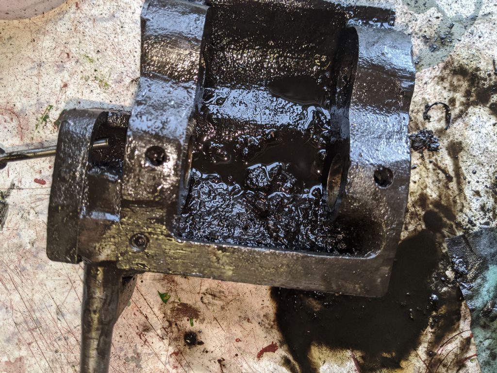

                          Started off by taking the Wormbox(thanks Herman) to pieces. I was a little scared by the spring, but it wasn't as strong as I thought it would be. So good news.
                          Absolutely filthy
                          Cleaned up the body

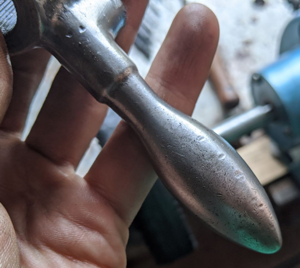

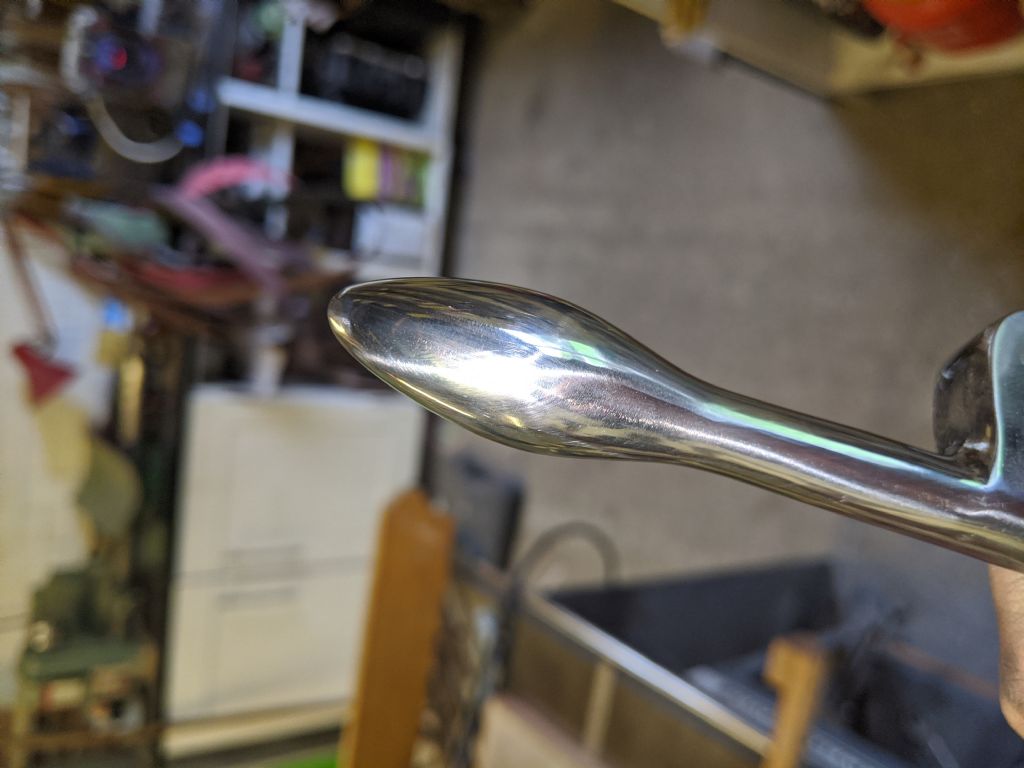

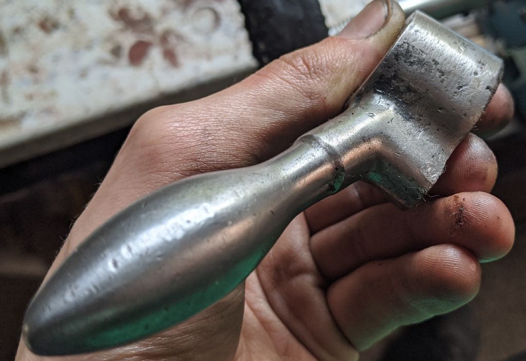

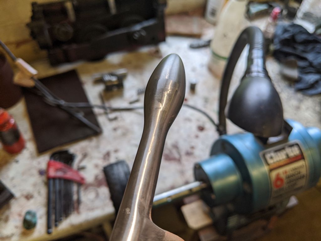

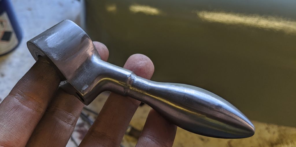

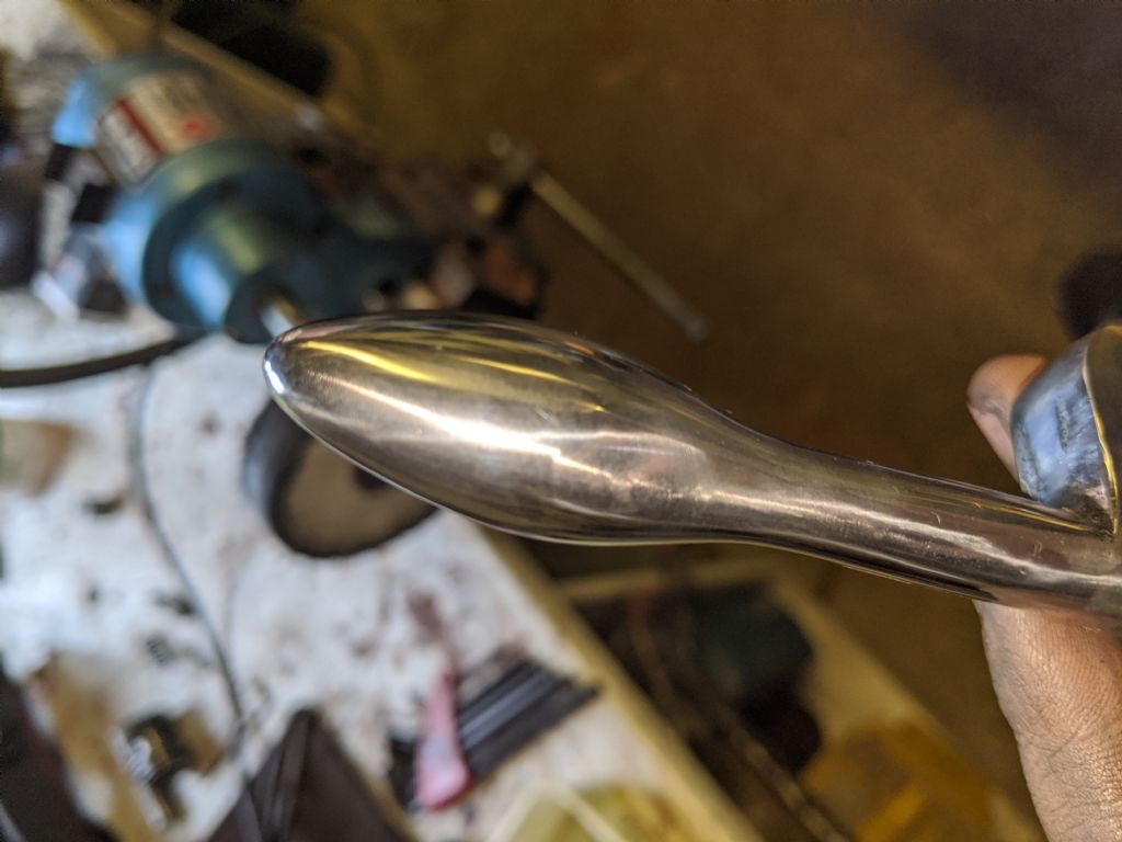

                          I decided that the lever at the bottom was very dinged up and not very nice to hold. And its about time I did some BLING. Got to show Herman how it's really done…
                          So I started off using a 600 grit belt on my belt sander, but using the unsupported belt section so it was slack and conformed to the shape. I used this to remove all the dings, then blended lots of surfaces.
                          Then I went to my standard green compound on a standard buffing kit wheel as a prepolish. This left a buffed surface, but not a nice shiny mirror surface like true bling should be
                          So I moved onto my proper buffing kit, starting with a Green 439T compound with a white close stitched polishing mop. If anyone wants a good source of polishing and bits, I find The Polishing Shop To be extremely useful for all my abrasive needs
                          From there I moved to a Blue P164 Compound with a Loose G quality mop
                          And finally, to finish it off, I went to a P175 compound with a Loose WDR quality mop.
                          So you tell me Herman. Do I BLING? laugh
                          It took me possibly 20 mins, so not too bad, and I'm very happy with how it turned out. I may be tempted to do a few more handles.
                          So I stuck it all back together. I spun the little spun plug 90 degrees so that its using the less worn area now. It's now very clean, and I oiled everything
                          Then onto the rest, lots more cleaning. I have made more progress, but I'll finish the update later

                            Good blinging!! I am impressed!
                            I think that spring is broken and will not offer the correct stiffness, therefore locking force.

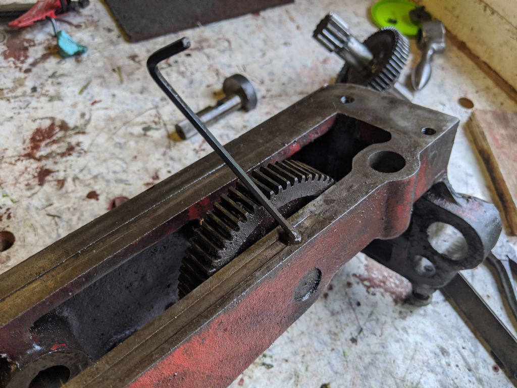

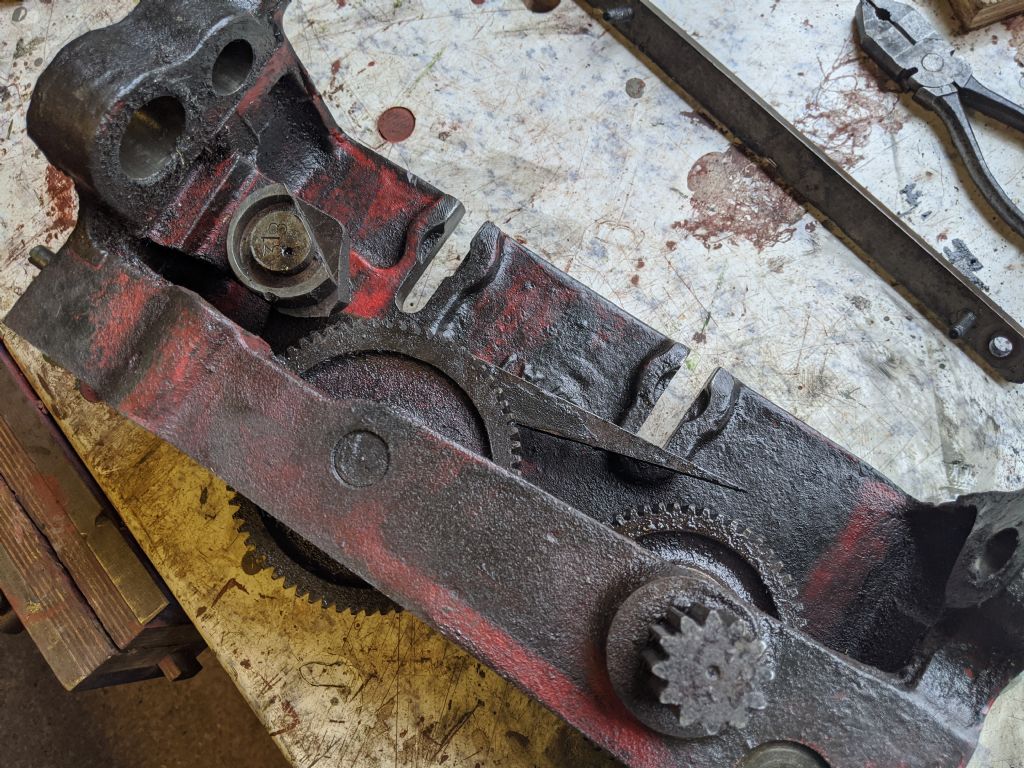

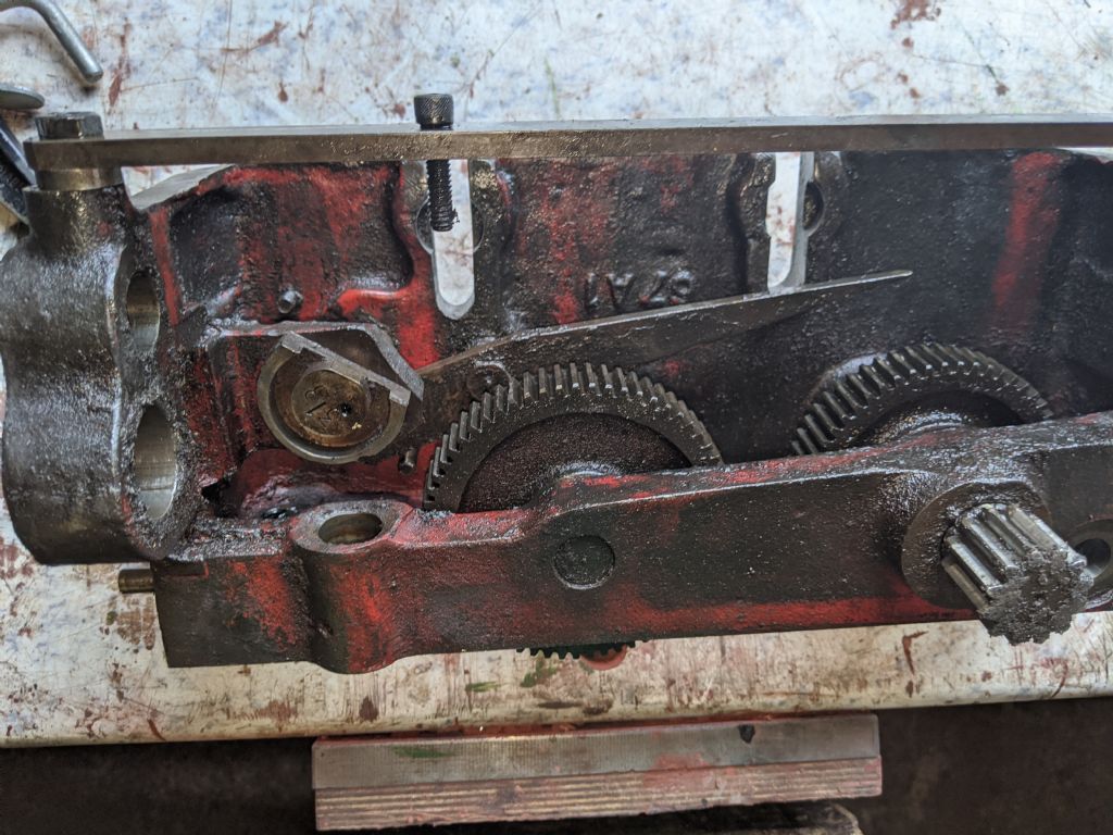

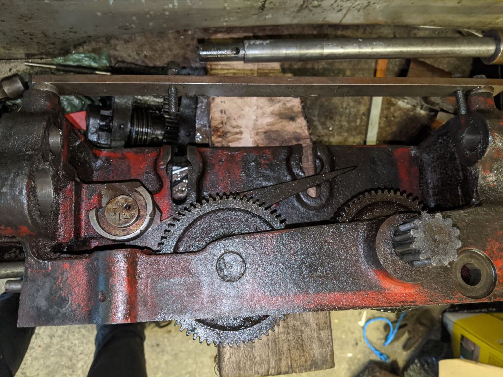

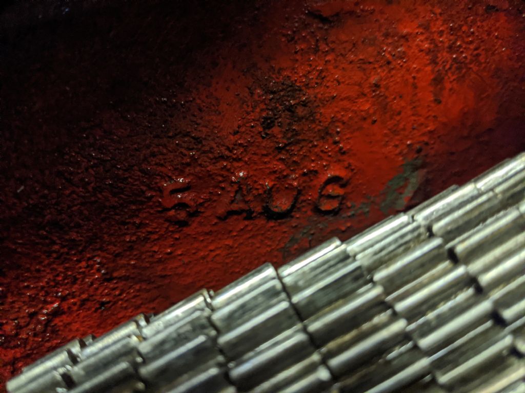

                              Anyway, back to cleaning. I was happily surprised how easily the whole assembly came to pieces
                              I started by cleaning a section just to see how easily the dirt came off, and I was happily surprised once again!
                              This shaft was held in with a set screw, which was easily removed with little effort
                              Then the next shaft was removed through a set screw that I thought was just an oiling hole for a bushing. Clearly not. This was very gunked up, but all clear now!
                              Here we have a few of the parts, still missing the handwheel shaft and the broken half nut, but as far as I'm concerned, a very simple apron. Only made less daunting through reading Hermans forum posts. So lots of appreciation there.
                              Then I popped out one of the tag holder pins and rotated the tag out of the way. This allowed me to go in and clean behind them since they had paint and gunk stuck, which meant they did not lie flat. More of a cosmetic issue. I bent them back flat and they look a little cleaner now, more like they're on the surface rather than having paint go up to them.
                              Then I removed the level/locking bar that stops the feed and screw cutting lever from being activated at the same time. So the machine does not pull its self to pieces. I have taken many pictures of the sizes below, since Hermans lathe was missing these parts. More to doccument them since Herman had a sketch of one that someone had made. Hopefully this helps someone somewhere someday!
                              I could almost have done with some of those hand garments too!

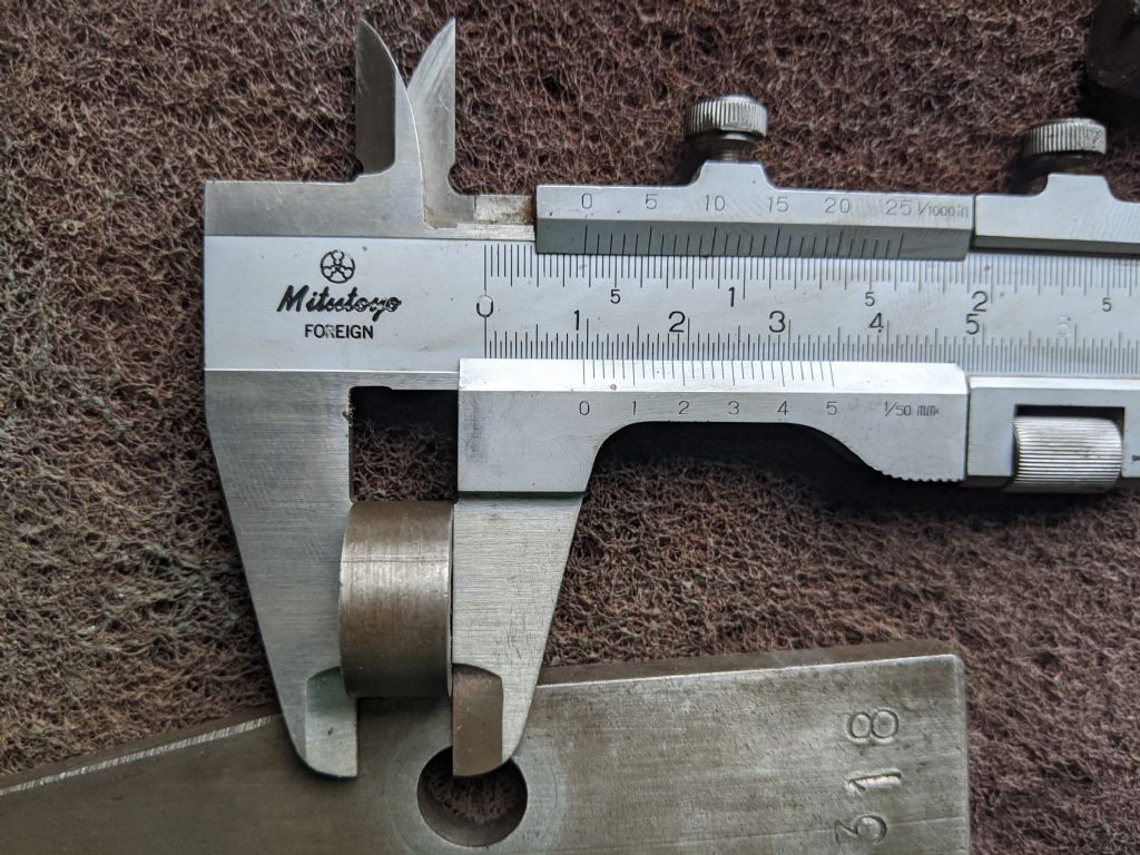

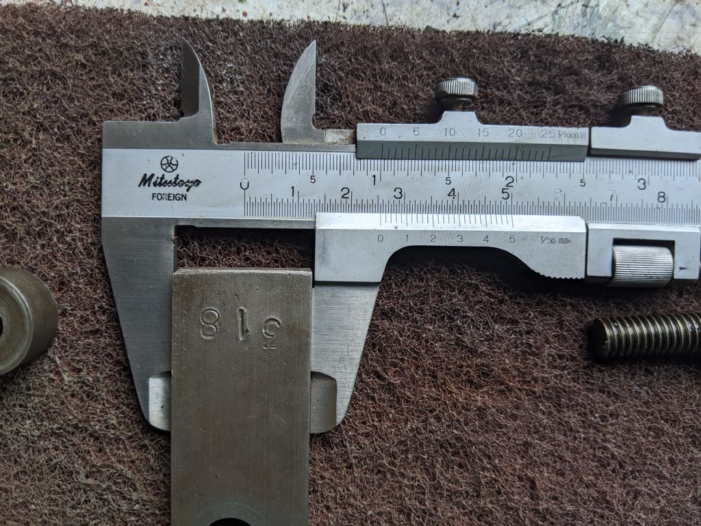

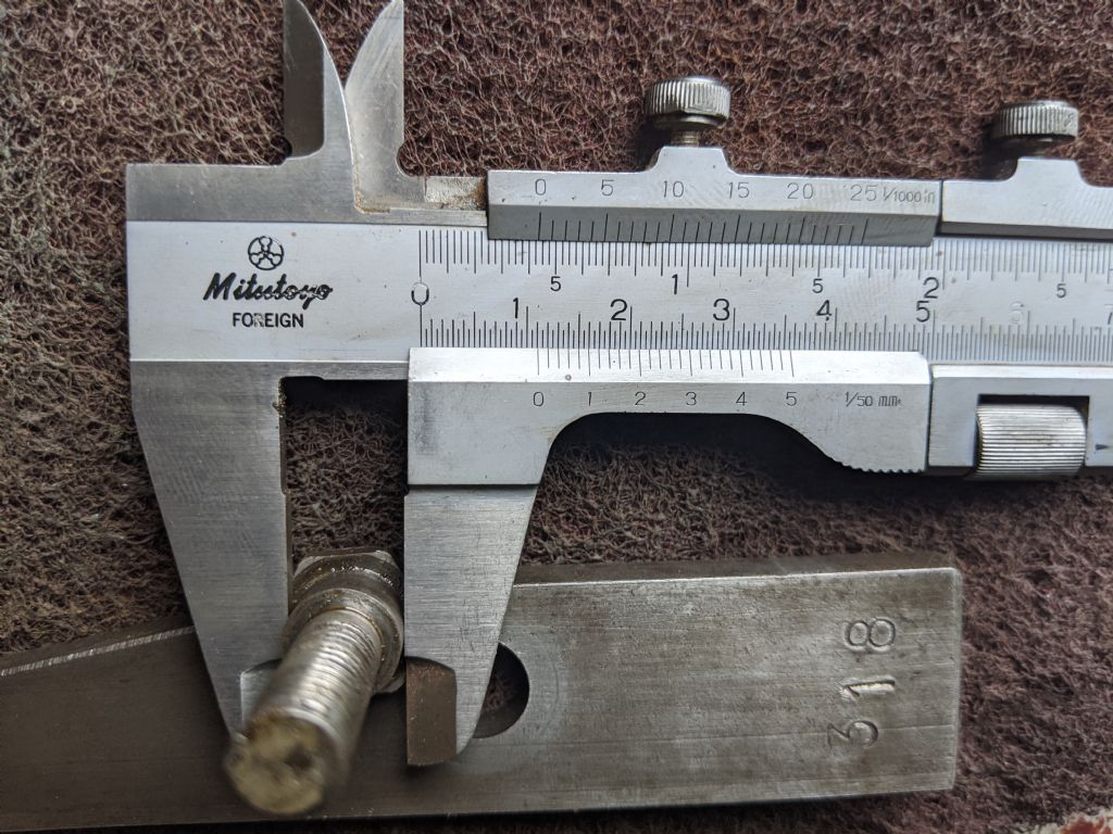

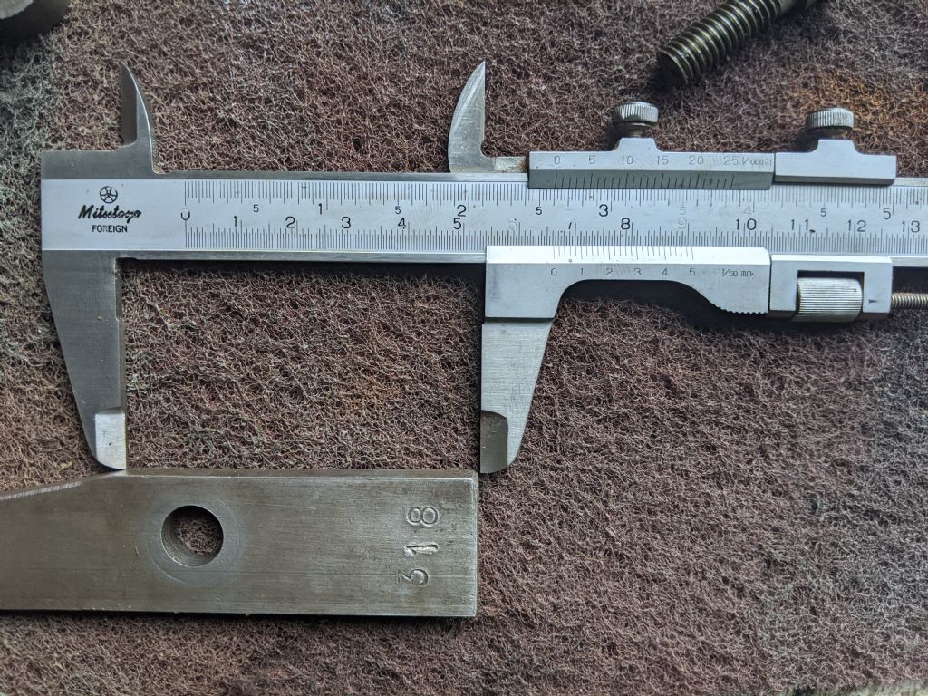

                              I did not measure the hole, but instead the shaft that goes through it. So it is always loose, so it is allowed to spin/turn
                              The thickness of the spacer is the only important feature, I am unsure if Herman knows of a spacer or something, but one is needed to put the bar at the right distance, and its thickness is as measured below. Fine tuning may be required (Pictures only represent half decent measurement, so take as you will)

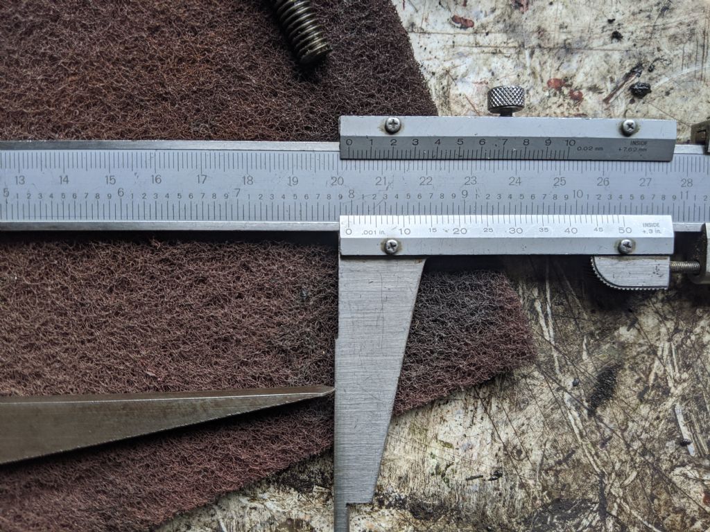

                              Then, lucky me, I got to get the big calipers out. A lovely piece of equipment from a very lovely home. The men in Scarborough that I bought some tools from. I regretted not purchasing a few bits from them, so I asked if I could buy a few more and arrange a courier. This is weeks ago now, but I got the big vernier, slip gauge set and the larger depth micrometer. So It really came in handy here!
                              Overall length may not be critical, but it is good to see a full measurement.img_20200804_162358.jpg
                              Then, after cleaning all parts, I moved to reassembling everything
                              I figured out that the spacer that I made was slightly too thick, preventing the circlip from engaging properly. This is why the whole shaft came out when the new(original old) hand wheel got stuck and I gave it a yank. So I really had to take this all to pieces anyway. So, the spacer is now the correct thickness and the circlip fits in the slot very nicely. I also took good care to clean out the spaces where the wormbox fits in. This will provide better registration.

                                The spring may be broken, but it has performed already and worked fine. Also with the years of abuse, perhaps a much stronger spring has been placed in your lathe when it should be weaker. We will never know. Unless I look at the manual…
                                I did not check the holes of the worm box for ovalness, but they seemed round to the eye. But I will measure them tomorrow. They seem round enough so I doubt that I will change them, but the measuring is always useful. I'm very happy you appreciate the bling. I will be blinging a few more handles as they look much nicer without the dings in. Mainly the apron handles since they're the most used. The handwheels can stay semi-polished since they are going to be well worn and show some character. Although who knows… I may bling at a later date! I hope the measurements are useful to you

                                  Look at your spring's ends. Ends must always have the double kind of turns. Your spring has only one end with this. This means the spring will not seat correctly and will not function as intended.

                                                  Herman, sorry if I didn't explain clearly, I mean to drill and ream down the shaft before I braze it, So it aligns. So the pin size is important as it will effect the fit
                                                  JasonB thank you for fixing the page.
                                                  Thanks for the message Mat, nice to hear someone else is here too. I have been on the colchester forum for a while, but only lurking. Your posts are looking very good so far!
                                                  #489954
                                                  Herman van der Merwe
                                                    @hermanvandermerwe76509
                                                    Oh, you mean the halfnut, not the leadscrew.
                                                    I would not do that. I would clamp it in a short length of thick walled angle iron and then braze it up. IMHO you will never be able to align the centres of the two pieces unless you do it on a milling machine with a DRO.
                                                    It is only a shaft with no micro accuracy required.

                                                    Richard Kirkman 1
                                                      @richardkirkman1
                                                      Yes of course, the half nut not the lead screw. Mixed my words up.
                                                      The shaft is actually very tight in the hole, so a very good alignment is required.
                                                      I'll take your word for it, however I would have thought that a 4 jaw with an 0.0005" indicator would have been able to get close enough to aligned. As long as the tailstock is aligned. Anyway I'll just braze it, I can reinforce it later if need be.
                                                      I've been painting and blinging today. Not particularly much progress as I didn't get the blinging finished.
                                                      The handle was deeply beaten up and had even more dings that you can't see in the pictures. It took a long time to file and get them out. I still have to remove all of the deeper scratches and other bits before I can polish fully
                                                      A while later on the belt grinder, the 600 grit belt was not abrasive enough, so I moved down to a worn 240 and then to hand files
                                                      Hand files and then back to the 600 grit gave a decent enough finish, but there are still some deeper scratches from filing that will need removing tomorrow
                                                      Almost at the pre polish stage. Not too much work to do tomorrow.
