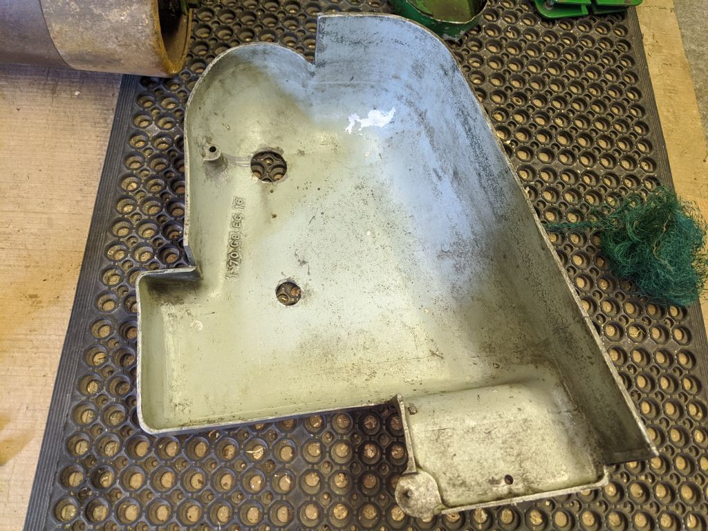

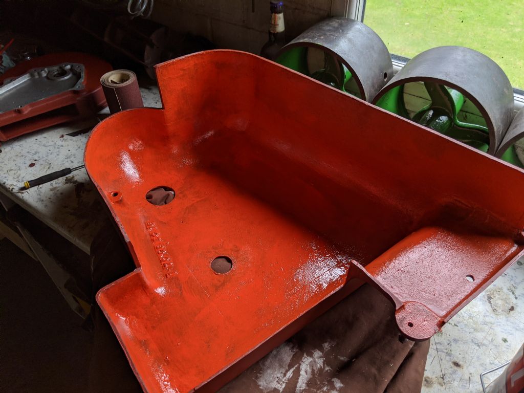

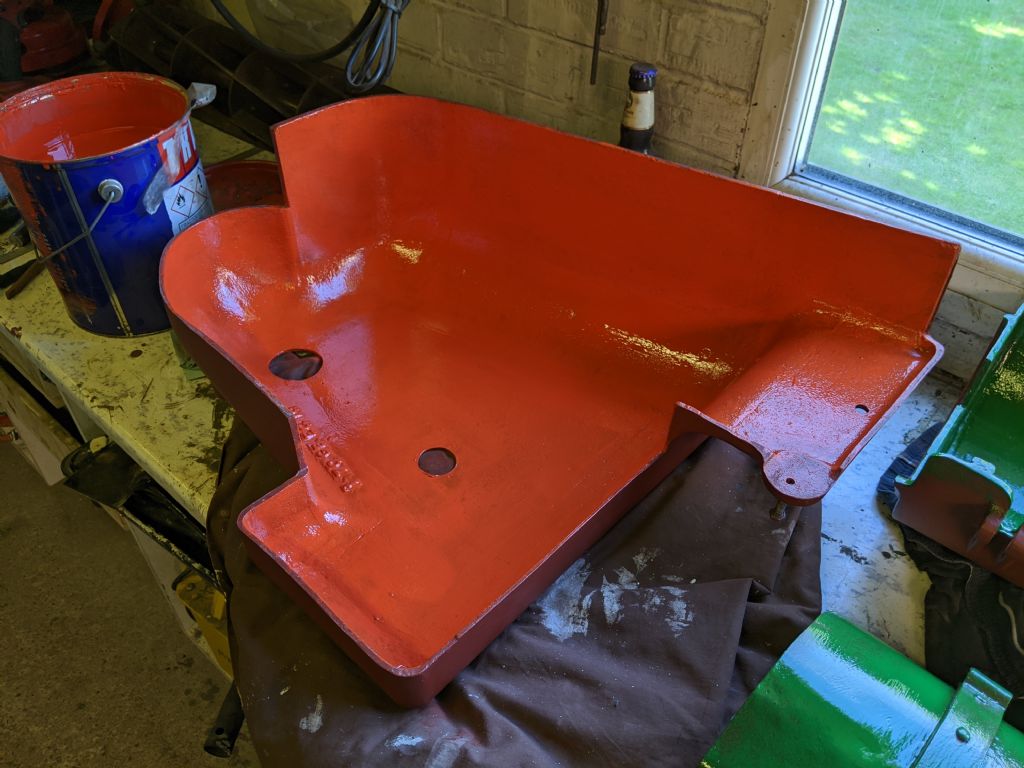

        First coat of red/orange on the inside. Not original, but it's how I want to do it! It'll be hidden most of the time. I will be painting the lip grey so the orange should be hidden when the cover is installed
        Just a very thin coat, but I'll build it up
        I've not been very productive since I've been working on finishing the g plan table as the owners need their table back as soon as possible.

          2nd thin coat today really brought the colour out! I'll probably leave it there and spray the rest.
          Perhaps the lathe needs some racing stripes so it'll go faster…
          It's looking so good it's almost a shame its going to be hidden. I'm sure some people out there will disagree, but I like it.

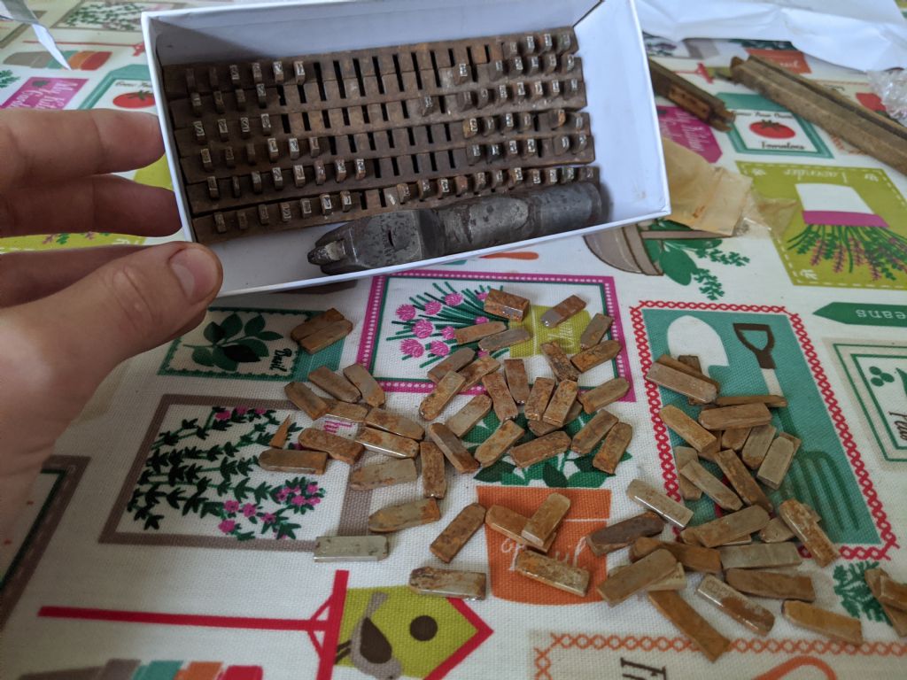

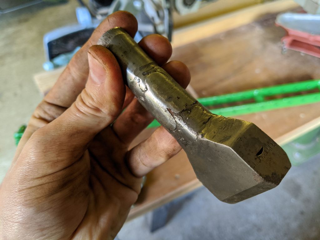

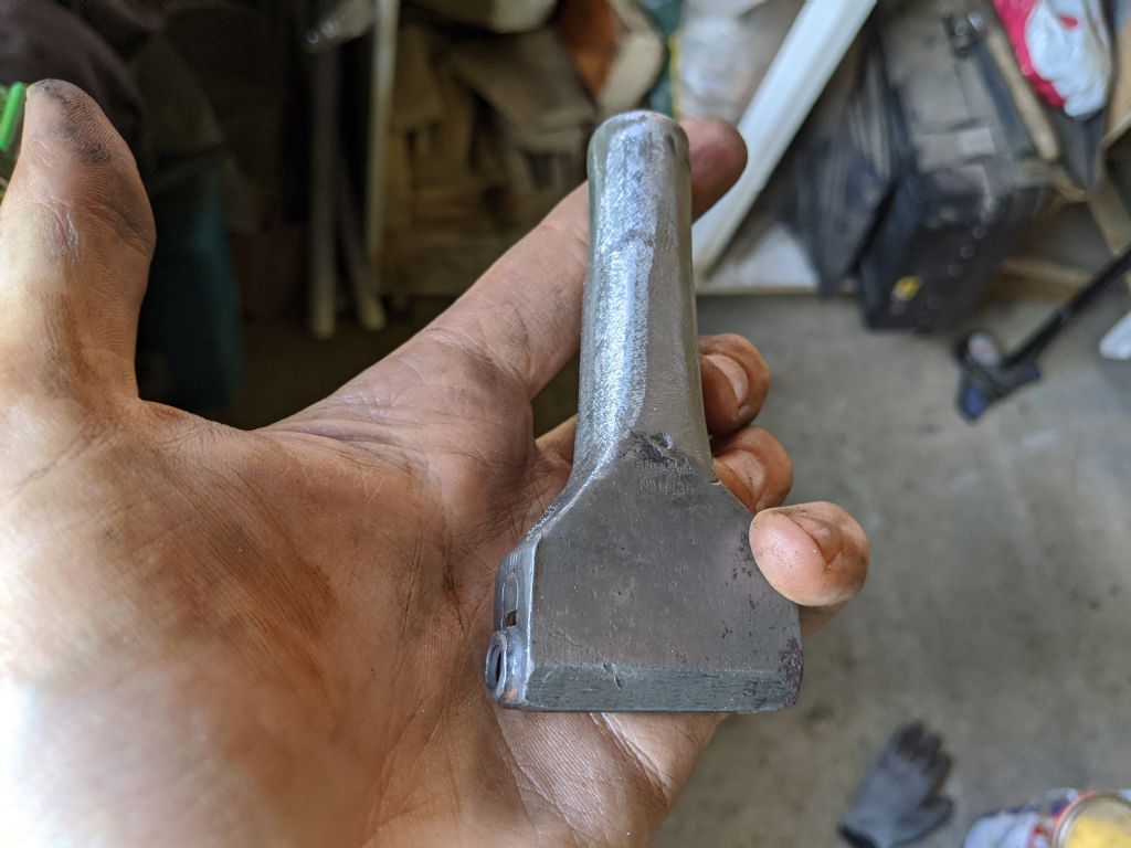

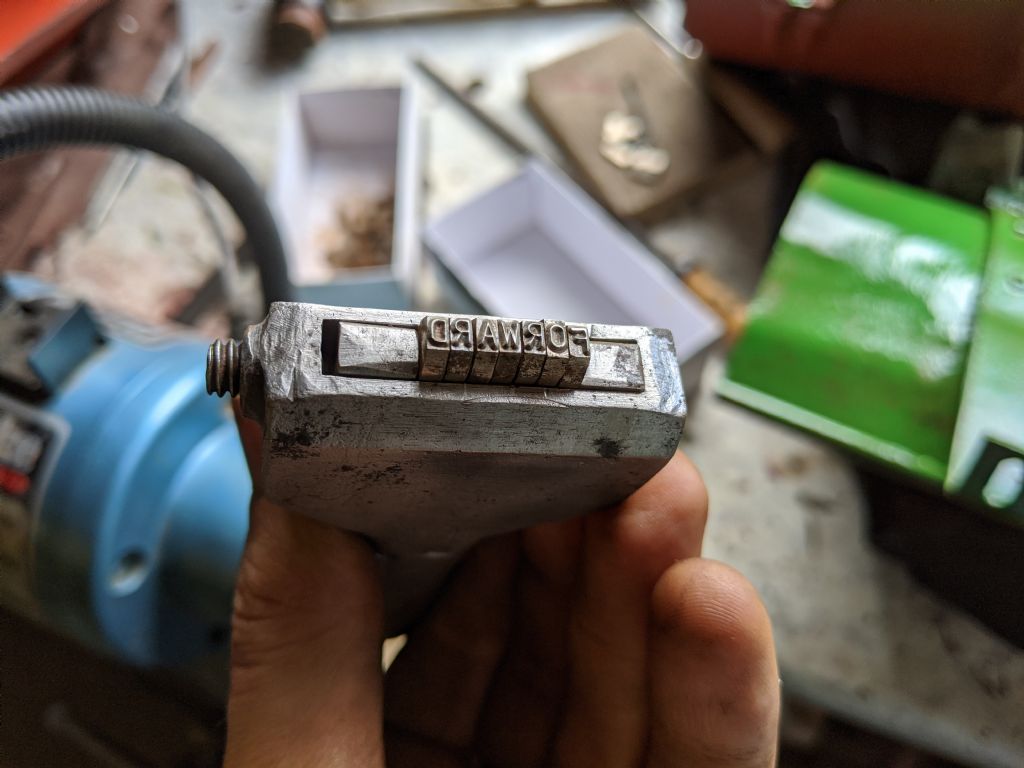

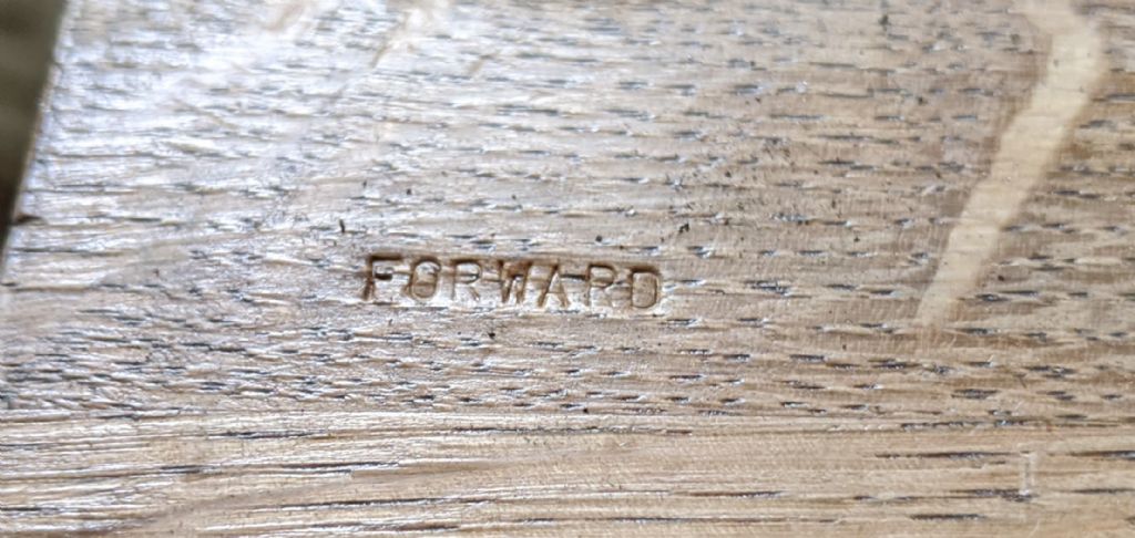

              New toy arrived this morning, only 4 days late thanks to my favorite royal mail.
              It's had a hard life. The listing said it was from the 1950s. It's been snapped in half(or cracked) then welded back together. So I thought I would blend the welds with a bit of filling so it feels a bit nicer to use. I'll probably polish it a bit more and cold blue it later.
              It hasn't come with a full set of letters, but I have probably 5 or 6 of ever number. I'll accumulate the letters I'm missing as I need them.
              However, after some cleaning, I found that I have enough letters to spell FORWARD, so we're halfway there.
              The imprint isn't currently even since there's still rust and crud on all of the letters so they're at slightly different heights. I'll sort that later too.
              It's going to look much better than F and R scrappily written in marker pen. Especially when on a nice brass plaque.

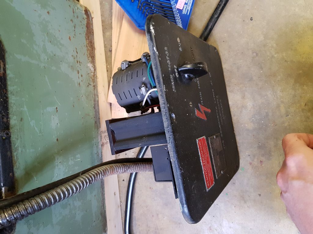

                            Thanks Richard. The key switch I've got a handle on – the drawers open easily, so I'm assuming that it's unlocked. Just to be sure I pulled the key mechanism apart and checked it over. Open or closed, the motor won't start. I will say my pump motor sounds a lot quieter then the one you had in your video though!
                            Not sure about the cover switch though. I can't seem to see anything that looks like a switch/button/contact anywhere on the lathe other then the obvious main power on the side and the off/on/on+pump dial on the front.
                            I'll have to take some pictures of my lathe. Yes, it's a Colchester Student lathe and there are many others like it – but this one is mine.

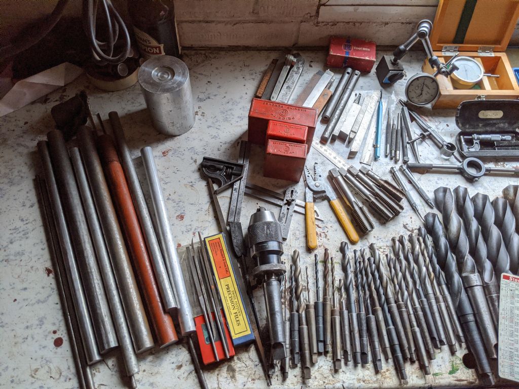

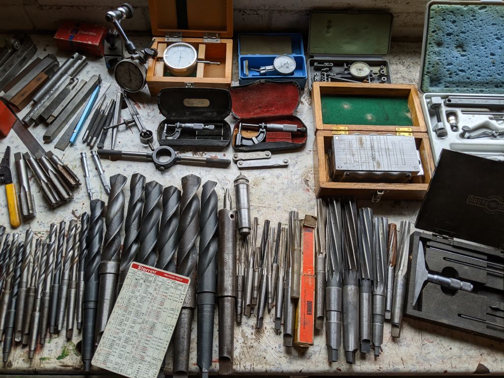

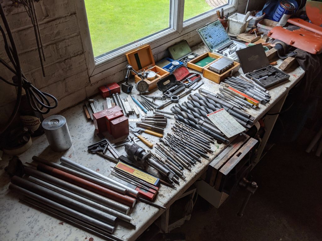

                              Just back from a nice trip to Scarborough to meet John/Ted and Brian, and to have a look through the tools available.
                              It was like Christmas, but much much better! Tools I hadn't even thought of, and tools that the previous owner had made himself, like centre drills on their own taper so you don't have to fiddle around with chucks. Simple idea, but will save time.
                              Ted and Brian were both very friendly and we chatted a while. I've come away with quite a few goodies. A few things that I was looking out for anyway, so well worth the trip. Popped in to see a friend in Pickering on the way back too.
                              Brian gave me a tour of his workshop and it was fantastic. He has a nice smart and brown lathe and plenty of stories to go with it. He also showed me what he's been making over the past couple decades. Incredible stuff. I haven't particularly looked into the model engineering side of having a lathe yet, but now I may be interested. Brian was even kind enough to supply me with various bits of steel and aluminium for me to play with.
                              Back home now and tools all laid out, some fantastic bits of kit
                              So, a few questions from all these tools.
                              The micrometers have one pin that's round. What are these used for? They looked too good for me to pass up. Are they for wall thickness measuring or something?
                              The mag chuck doesn't work properly, are they tricky to fix or would it be a waste of my time?
                              Does anyone know if there are any companies that make cards similar to that starret tap/drill chart but in a full-blown poster form?
                              That's all for now. A bit off-topic so I apologize. Hijacking my own thread more than Herman at this point!laugh

                                the cover switch is pretty well hidden, but once you've found it you'll never forget it. It just stops the lathe being operated while the cover is off.
                                What are you running your lathe with? Like the source of the electricity
                                I've always found that pictures explain the technical things I don't understand better than my words.
                                This is the cover, there is a switch in the lathe body that gets pushed in by the bolt that pokes out of the cover at the bottom middle part at that lump
                                    Ahh… I see!
                                    I've tried it with the cover on for the most part, though I'll now double check that switch to make sure it's not damaged or anything.

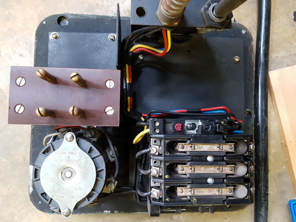

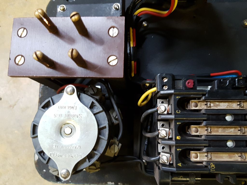

                                      It would be good to see inside the control panel of the lathe Donovan. Interesting to see and would possibly help.
                                      if your pump is only making a very small amount of noise, are you sure it's definitely spinning?

                                                      Hi Richard,
                                                      It *sounds* like it's spinning, and when I turn the power off the spinning sounds slows to a stop over the course of 3-5 seconds.
                                                      As for the control panel, here it is in all it's glory. I don't have the fuses that you do, but everything else looks about right.
                                                      (Here's an album with all the pictures I've taken so far)
