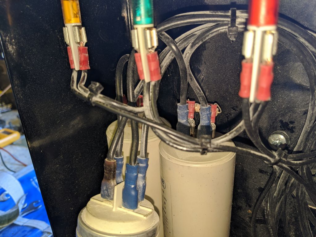

          That isn't a loose wire at T1. I checked all the wires were tight when it arrived. It seems like I'm going to have to strip everything out and clean everything. It looks like I'm going to have to learn how this works. I am interested in the exact working and how easy it would be to reproduce.

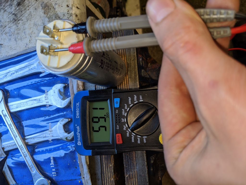

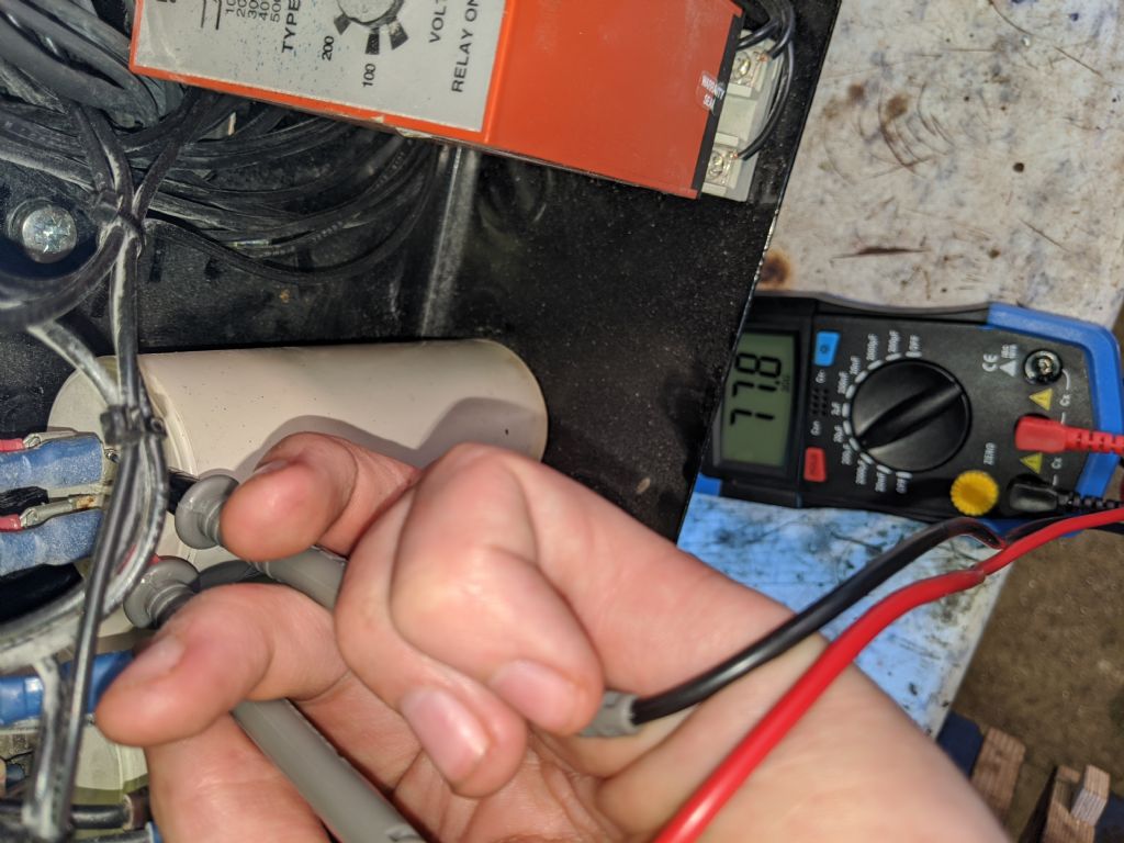

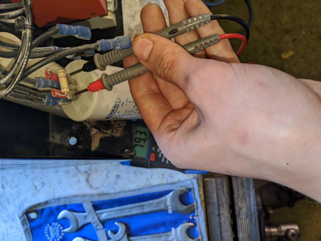

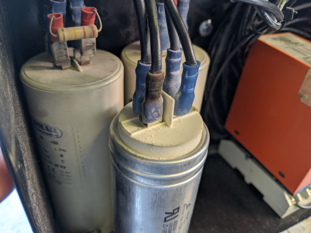

              Capacitance meter arrived, It seems fine
              I've taken the capacitors out and measured them all, but they're all within tolerance?

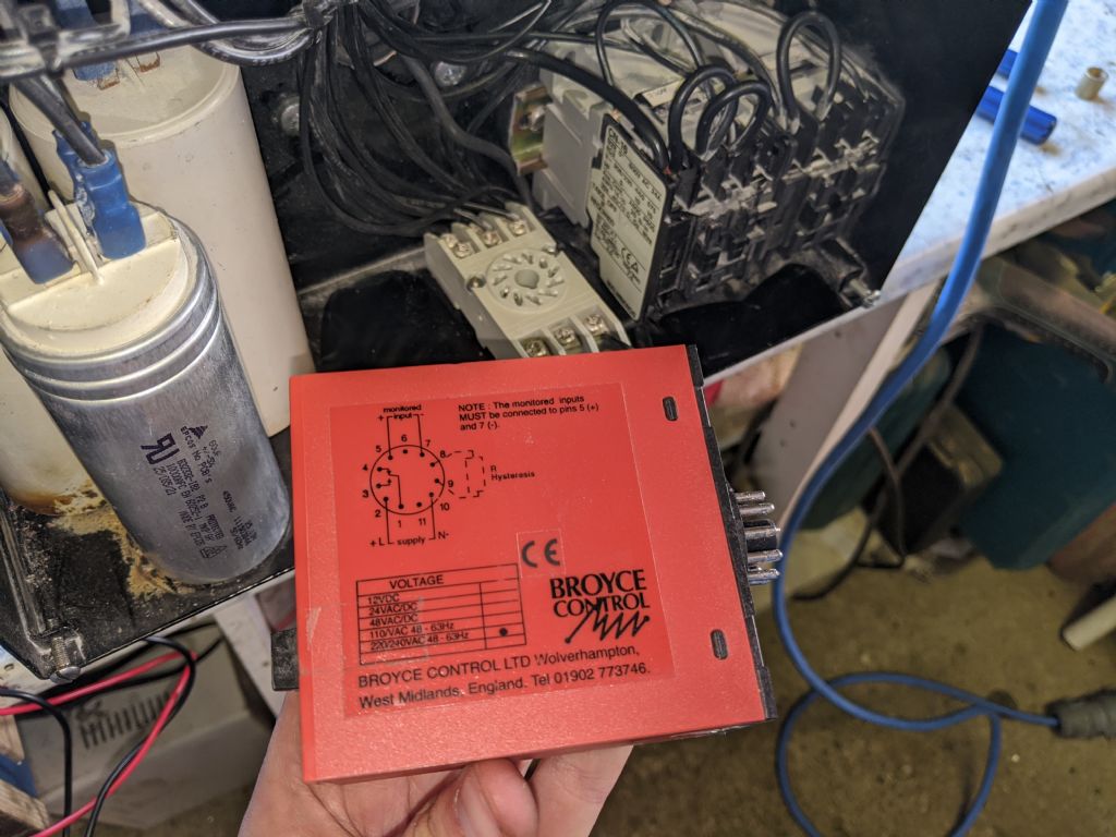

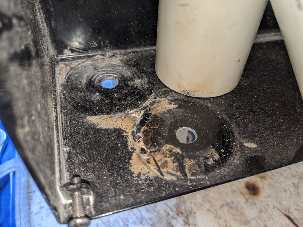

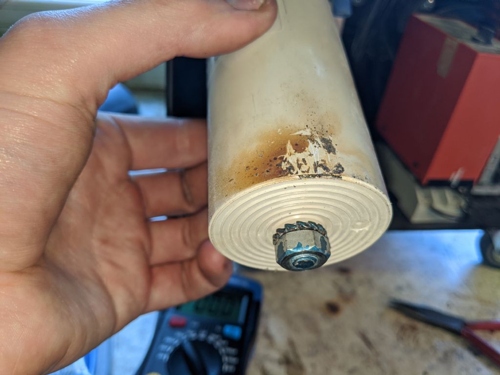

              The stuff at the bottom honestly looks like bird poo to me.

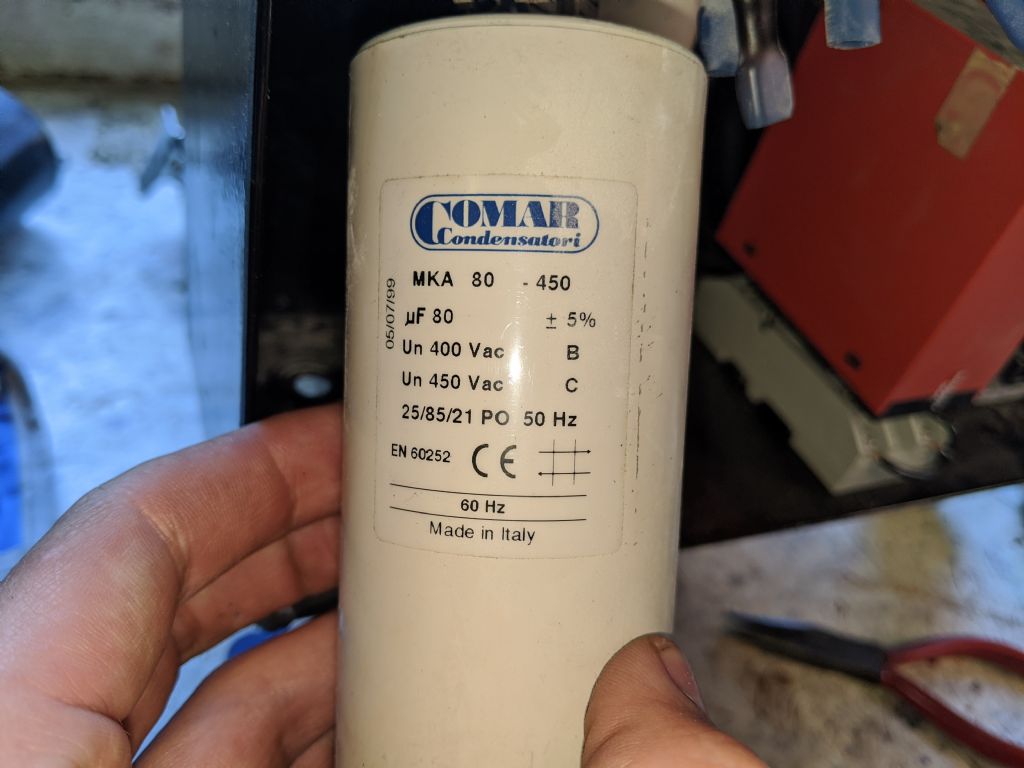

              Small one is 60 micro farrads and the big ones are both 80.

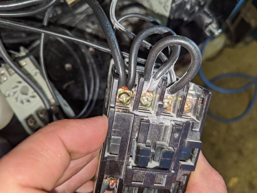

              The wire you said was loose isn't loose, it's just not pushed in far enough. It will be sorted
              Any thoughts on anything?

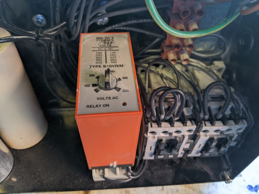

              What is the red box for and what does it do.

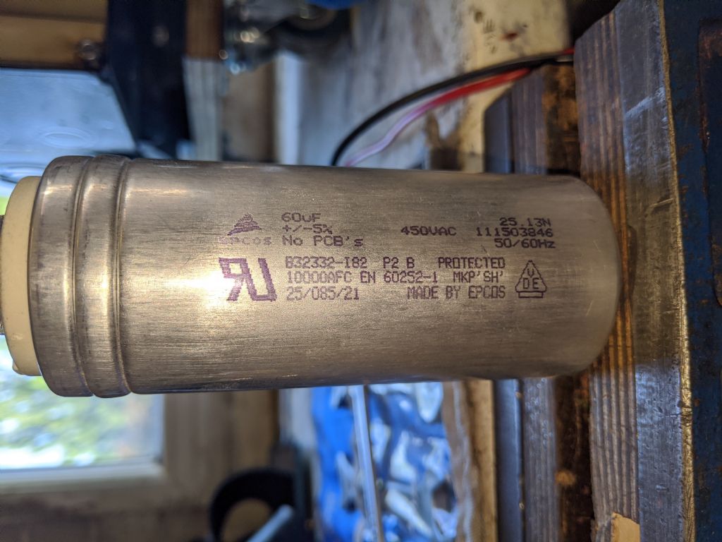

              Found the capacitors online, or similar replacements. not sure if they're the identical ones I need. But a full set of 3 would put me back around £75.
              60
              80
              Edited By Richard Kirkman 1 on 27/05/2020 18:08:55

                If the capacitors are measuring within tolerance, I would leave them for now, I must admit I did think you would have seen at least one out of limits. There is another test you can do, but it requires another tester, although it would be a lot cheaper than new capacitors, look up "equvalent series resistance tester or ESR. I would definitely replace the blackened spade connector, that has overheated and is not carrying the current it should be, that could even be all that is wrong with the convertor. I think the red box is a timer relay that switches the motor from start to run in the time set by the control on top. give the relay contacts a clean, replace the spade tag, and try it again.

                  I will measure the capacitors again tomorrow to double-check

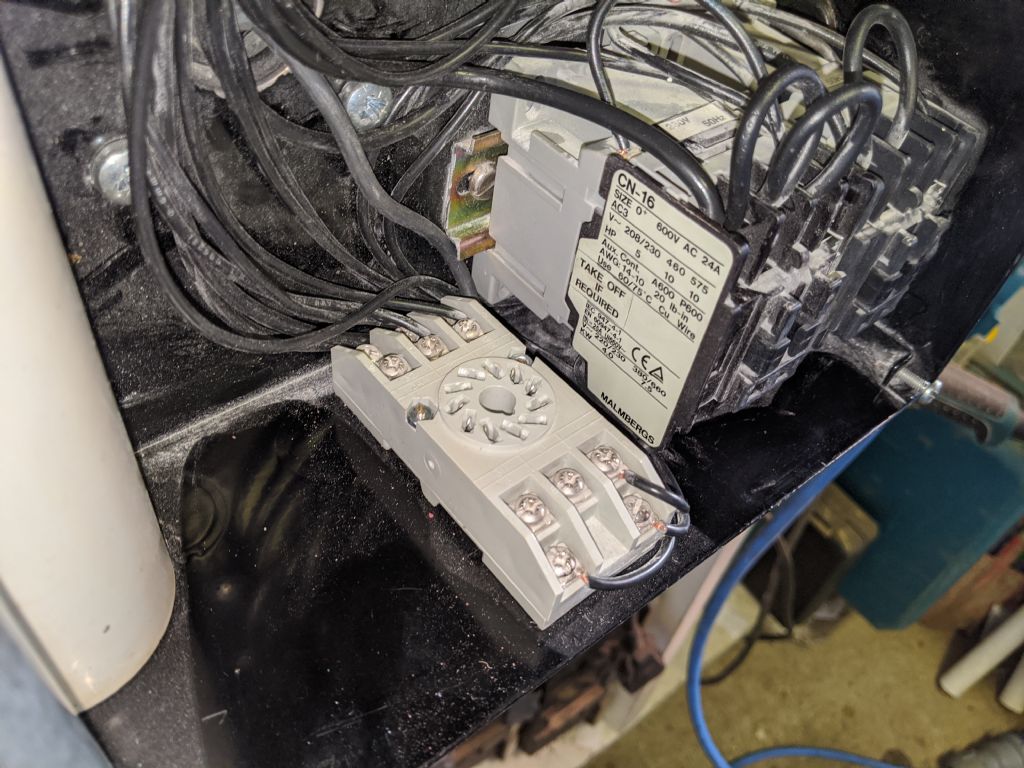

                  I'm not sure how the relay can be cleaned, seems like a lot of pins to me
                  I sorted the wiring that was poking out too far
                  Where do I find replacement spade tags? Just eBay?

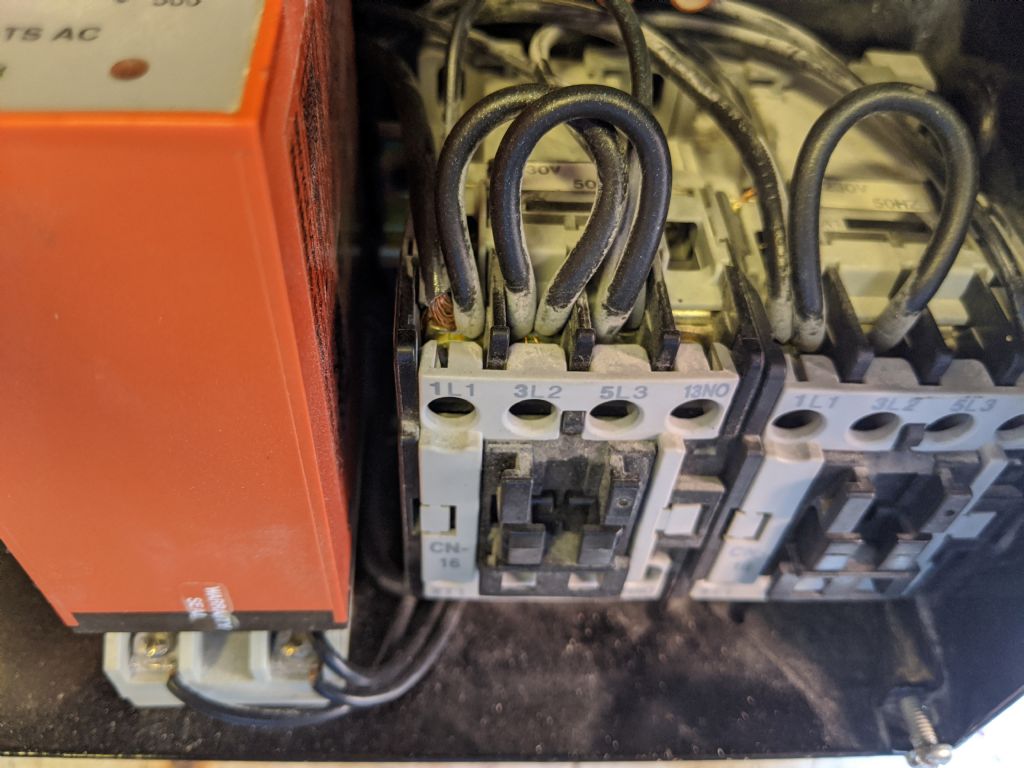

                  I checked the contactors for continuity and they were all very clear good connections
                  #475436
                  Phil Whitley
                    @philwhitley94135
                    I meant the black contactors, but if they are good electrical connections, they should be ok, do you have compressed air, blow out all that dust, and wear a mask! When contactors get dust in them, it burns/melts onto the contacts, and they arc, but there may not be any way you can get into them to clean them, remember I am old school from the days when everything could be stripped, cleaned and rebuilt! when it is clean, check the operation with the lid off to check for arcing.

                      That most definitely is not bird poo. That is a chemical spill from a leaking capacitor that failed due to age and then overloaded the circuit, hence the burned spade connector.
                      Someone obviously replaced the cap that was there with the silver one. Only issue is the value is incorrect. The white ones are 80uF whilst the silver one is 60uF. AFAIK the three needs to be the same value to ensure the phase formation is a smooth sine curve.
                      The age of the white caps are more than 10 years. The white caps reads 05/07/99. This is beyond design lifespan. They might measure to the correct value with your meter, but under load operational parameters must be determined as I said with a stop watch and a low voltage supply such as a 9V battery.
                      Me, I would never use caps more than three years old. Remember that the value of caps deteriorate in a logarithmic curve of capacitance vs time.
                      Question – Can you try and get hold of the circuit diagram of the unit?
                      The red box is a monitoring overload relay. It checks if the incoming voltage is more than the set value. If so, it will disconnect the circuit. Yours will disconnect at 300VAC as the selector is set to that.
                      Do have access to compressed air? Simply blow the contactor set clean.

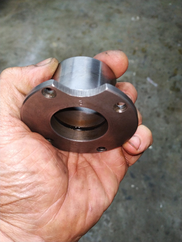

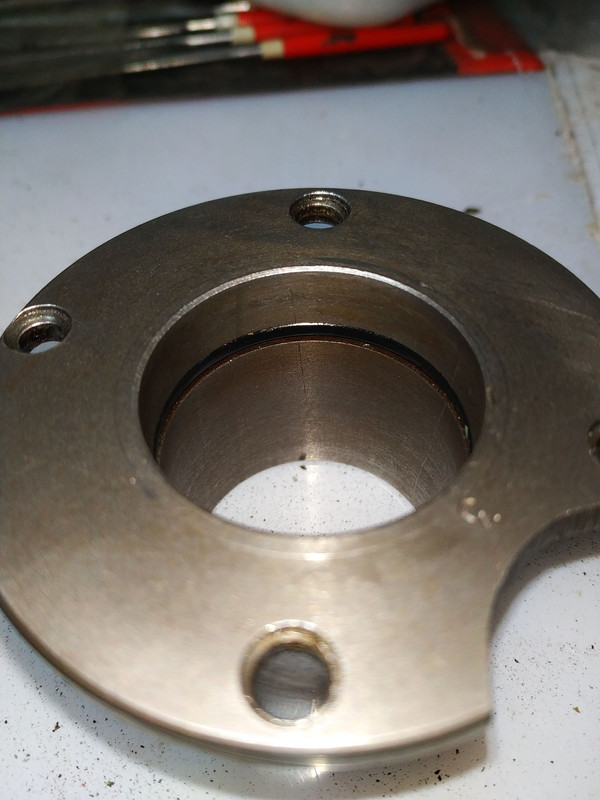

                        @Richard, I found an O-ring in the tumbler bearing bush. It is part # 6842. This O-ring was as hard as anything and could never seal. It is inside the bush on the gearbox side of the tumbler arm.

                          what should the disconnect be set at? Or is 300vac where it should be?
                          Interesting oil seal, no doubt mine could do with being replaced too!

                            If it was me? Yes I would replace the three caps and all to the same value (not size). Buy a good brand. They are not cheap though.
                            300V is fine. Leave it be.

                              I see you gave a link to caps. The 80uF link is for PP caps used in audio applications. You are after power factor correction running caps.

                                    No, those are three phase caps. You need single phase caps.

                                        Okay single phase caps then.
                                        This appears to be the identical model that is in my cabinet.
                                        LINK
