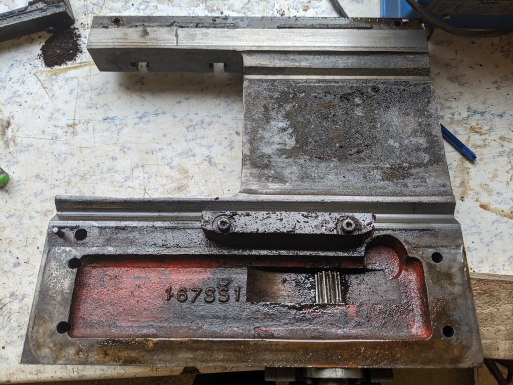

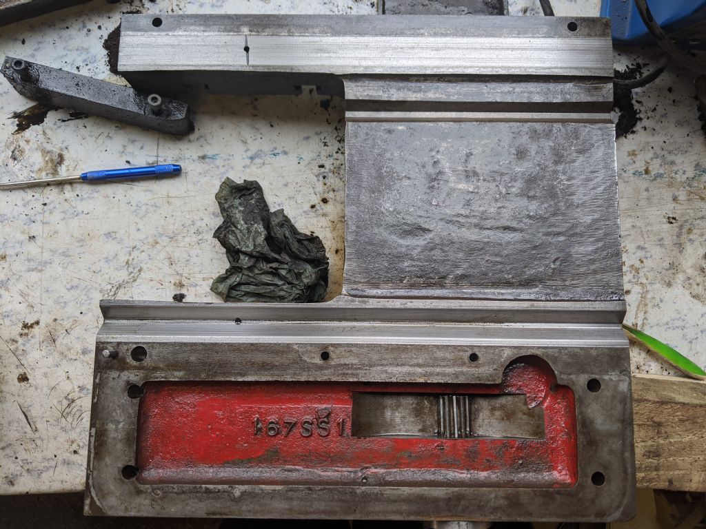

        I did some cleaning today. Got everything ready to go back together. I need to measure up the size of the new spacer I need to make. Needs 5/8ths bore, then o can measure the thickness when it's all back together. I need to remove as much of the slop as possible since it's causing uneven wear on the gears.
        All the oiler holes were bunged up with gunk, so a good clean should have helped them a lot!
        I cleaned the gap bed thoroughly, but I don't think I'll be painting it this time around. Maybe next time

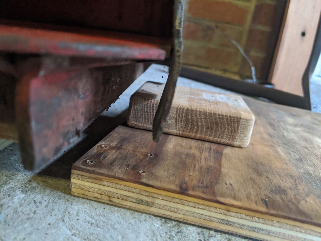

          Wheel video
          In the video you can see where it's already been worn unevenly

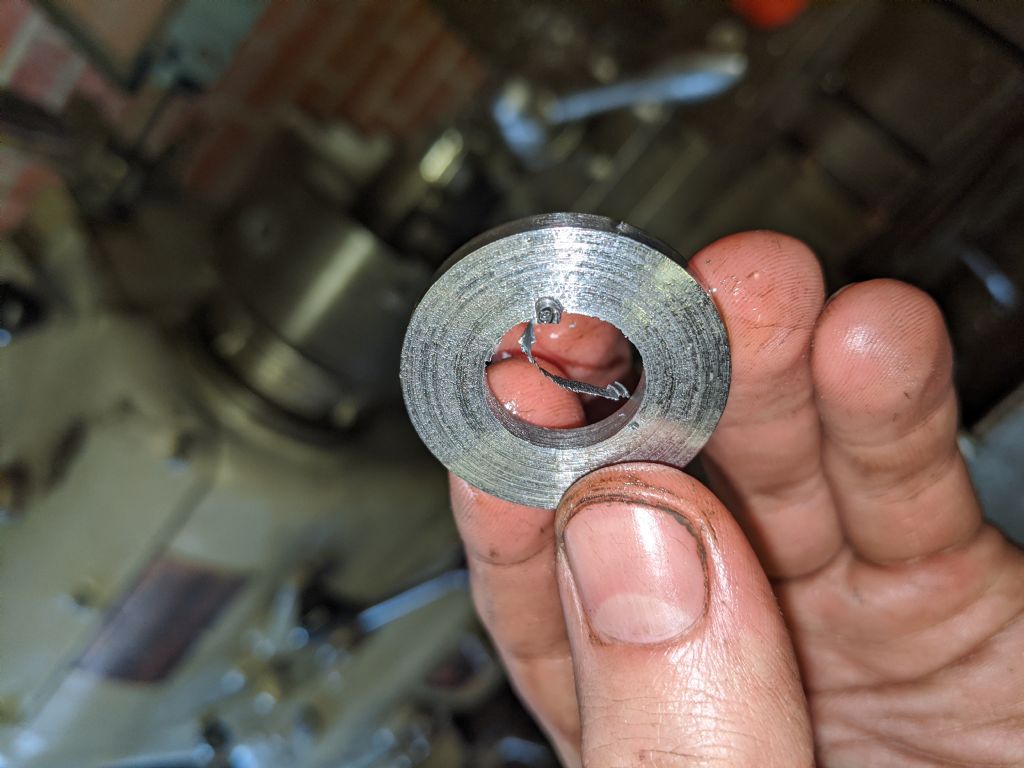

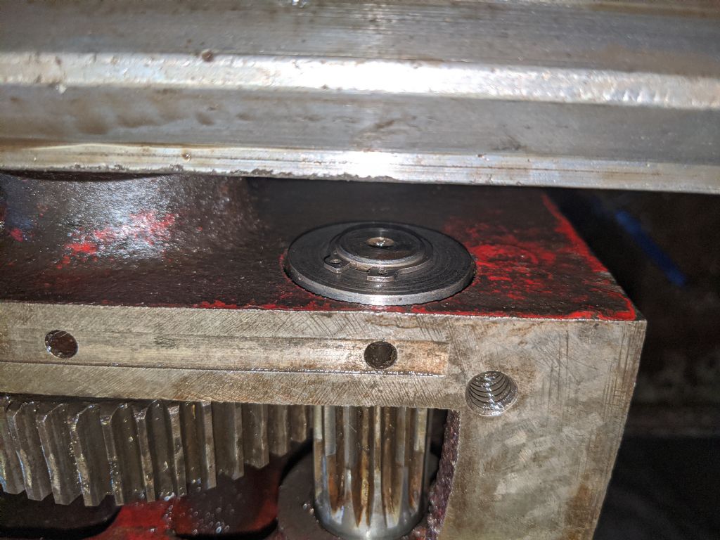

            Don't worry too much about the wear Richard, it is not a "precision" control. Fit a spacer to take up the play, clean out the oil holes into the bushes, and call it done!

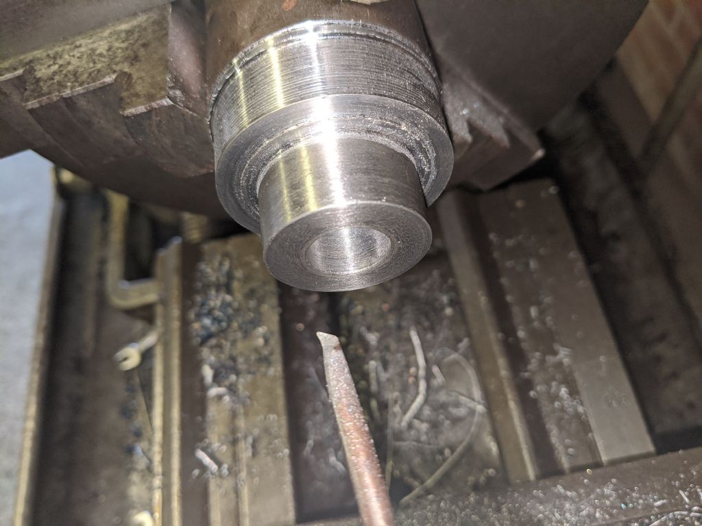

              I wasn't worried about the precision or the wear. It's just anoying having the wheel move in and out.

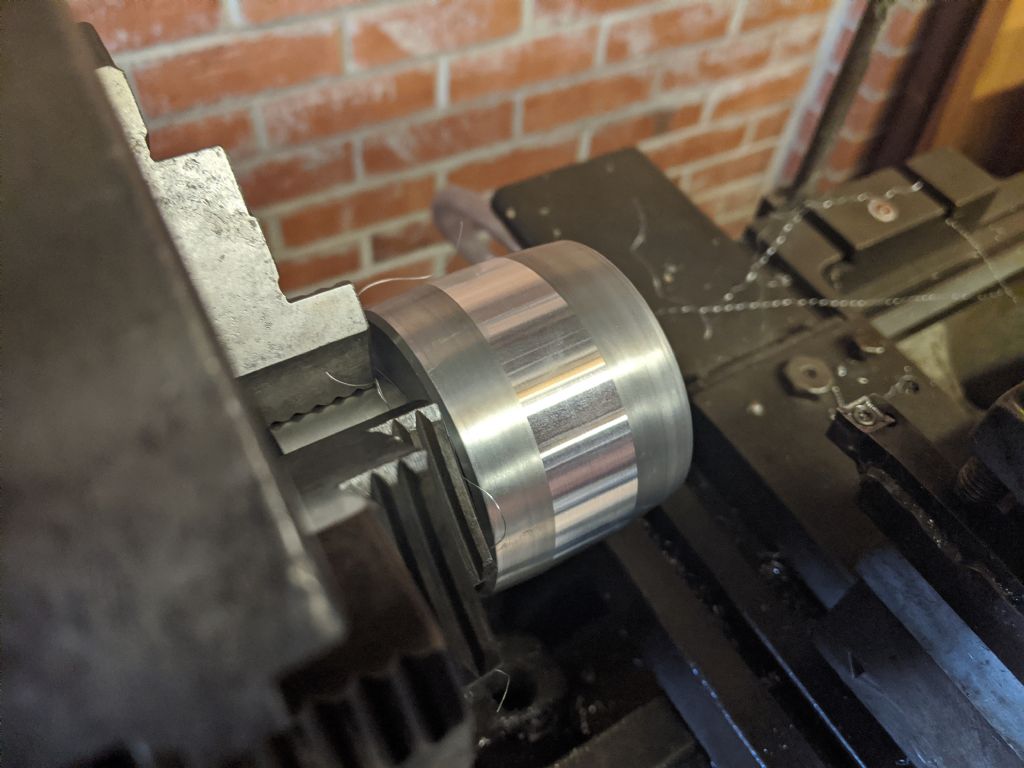

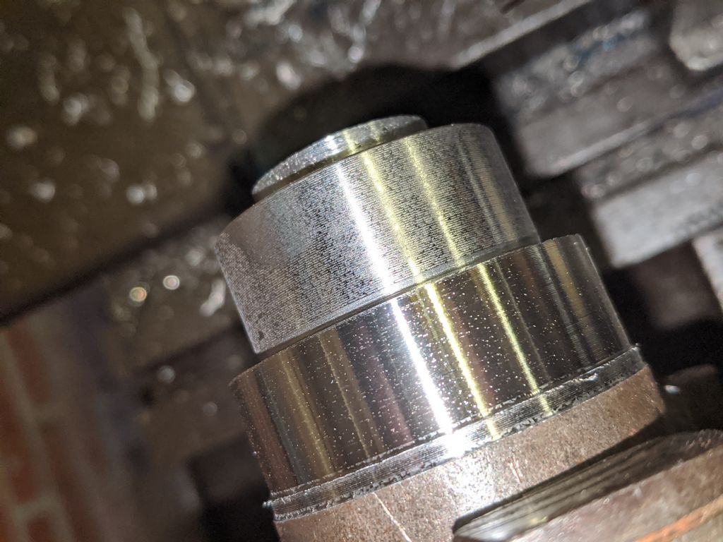

              I put it all together, measured what I needed, then made the spacer. I had a play with speeds and feeds. It would be nice if I'd remembered to bring my machinery's handbook back from uni with me
              Parting off is going much smoother now, so thank you for your tips. Although I am still using the carbide one, I will get back to the hss one since it's thicker and will be better for heavier work
              Parting off
              I'll take it to pieces again and reassemble with the spacer this afternoon. I hope it fits😀

                My problem with parting off is that the face is never as good as is obtained facing with a normal tool, which always makes an additional op for. me. So the tendency is to part off slightly over length and then face back to the required thickness, or even, most unusually for me; to make it look nice!.

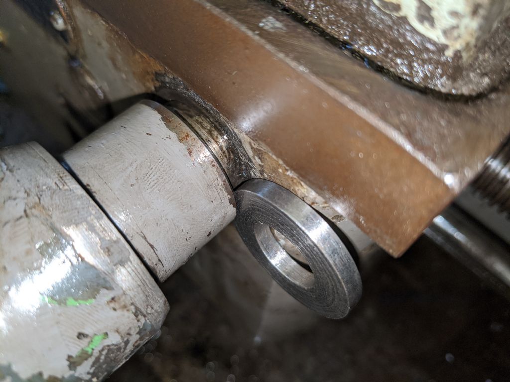

                  Thanks Howard, yes it could have been better. But it feels smooth enough to me and it was bang on the size I wanted. So I just used it as is
                  So much nicer to use now, it wasn't nice grabbing the handle and having it move in the wrong direction

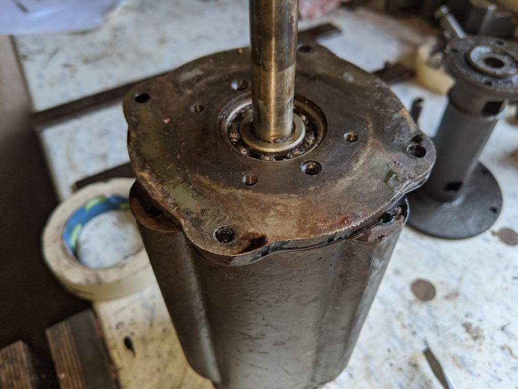

                    Didn't bother with the 3 jaw in the end. Gave it a and lilittle clean and oil since it was off, but nothing more than that.

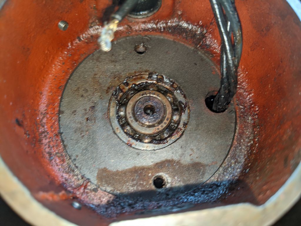

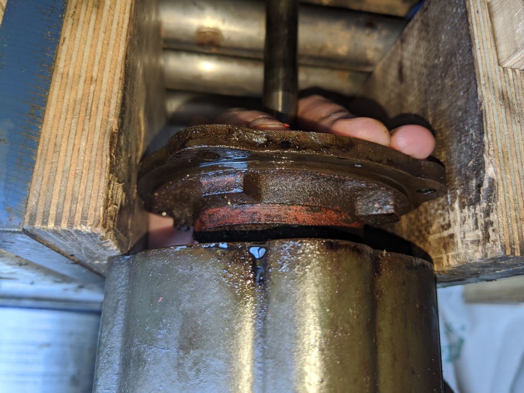

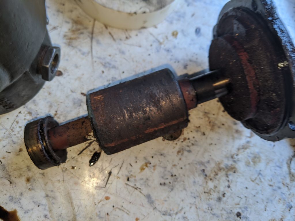

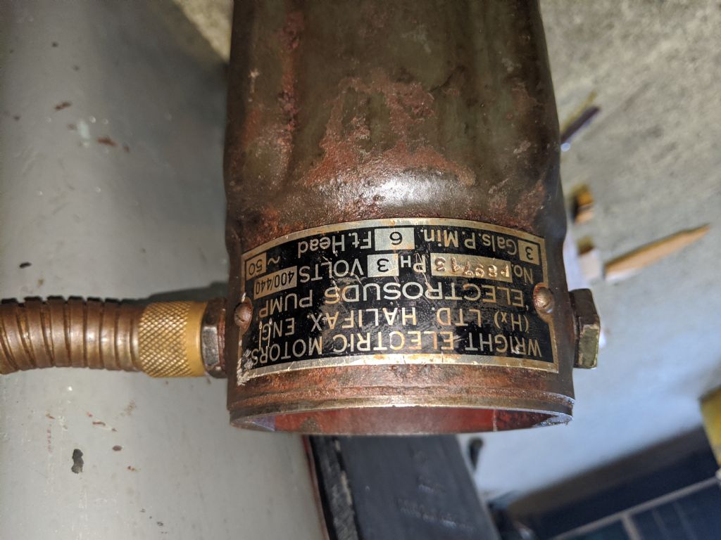

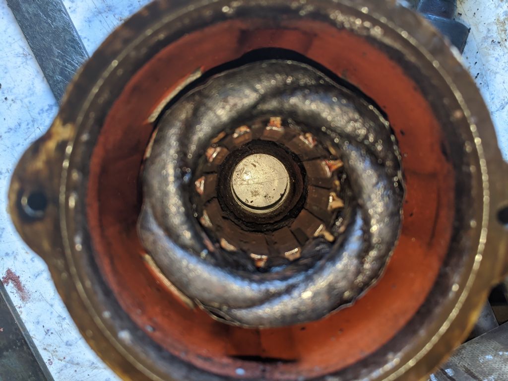

                    Then I took the coolant pump to pieces. I was surprised by what I found inside
                    It seems I need to get the shaft out so I can dissasemble it further to replace the bearings. Any reccomendations for bearing type to replace with, and what type of grease or things to do? I'm not familiar with suds pumps.
                    It's definitely not a very smooth runner

                      Just treat it like a normal motor. plenty of online bearing suppliers, order on ID/ED , Don't buy the cheapest, you will get the lowest quality chinese bearings, and some of them are rubbish, SKF or RHP are good. Just use a normal LM high melting point grease same as you would use for car wheelbearings. You could try cleaning out the bearings you have, but from the noise it was making, I think they are shot! can you post up a pic of the top end of the motor where the flexi conduit goes in? The rotor may just pull out, but there could be a couple of bearing retainer screws inside the terminal box, as it is vertically mounted. The lower (or both) bearingd may be axial thrust types.
                      Phil.

                          Hi Richard, That looks like it just knocks out, and they look like standard bearings, should be about a fiver each! try tapping the outer race of the bearing with a socket, or suitable size piece of tube.
                          Phil

                            it came out nicely with a few taps
                            Do I need to clean it carefully? or just normally? never dealt with motors before

                              Normal cleaning of the motor is fine. Remove surface rust from the rotor but dont worry about making it pretty. For the laminations in the stator I'd just use a nylon brush to remove loose material. You must be careful not to damage the insulation on the windings.

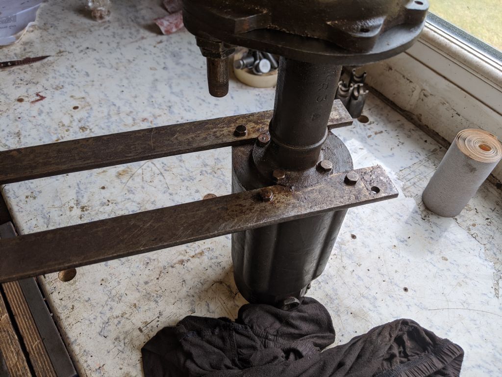

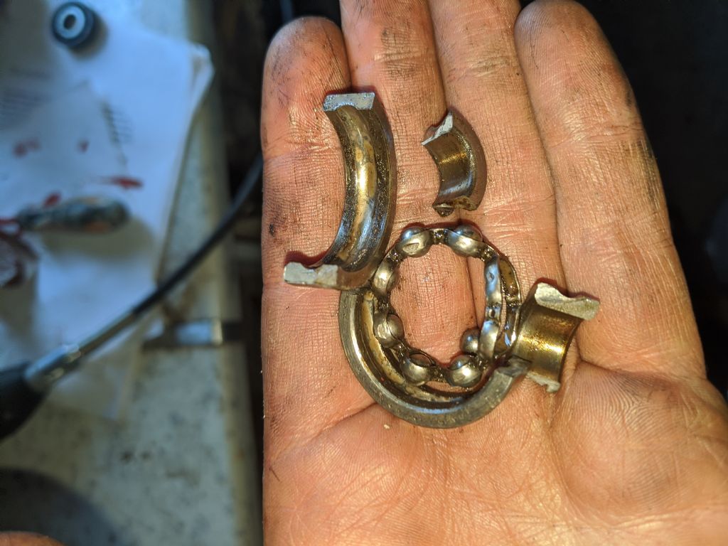

                                Didn't bother cleaning it too much today. But did spend a very long time just trying to get the bearings off the shafts. One came off very easily. Then the other was a pain

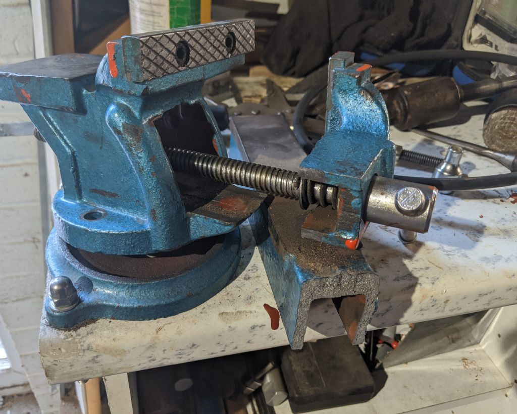

                                Anyway, long story short, I snapped my vice
                                Still, the bearings are off and it was a very cheap vice
                                I've found replacements, they're the right size. But will the type of bearing be okay? I'll double check the sizes before I order
                                Bearing

                                  Hi Richard, yes those bearings should be fine, the old ones weren't sealed, and suffered because of it. I use a tiny flat jewellers screwdriver to carefully remove the seal on one side, add some grease, about 3/4 full for this application, then refit the seal. They are not really "seals" in the true sense of the word, just dust covers. You will be amazed at how little the manufacturers put in! If one side of the shaft was very tight on the bearing, you can reduce the interference a bit with some emery tape, they will have been power pressed on!

                                      Maybe the one that broke up was the one making the noise?
                                      Do make up dollies for fitting the new bearings to minimise risk of damage.
                                      Pity about the vice. Cast iron is comparatively weak in tension.
                                      If you can find one, an iron vice would be better, but might be more expensive.

                                        Hi Richard, this vice is fabricated steel rather than cast iron, and not expensive!
                                        I bought one of these
                                        6″ FABRICATED STEEL VICE
                                        from my paint and tool van when they first came out in the seventies, it was £24.00! Exactly the same design today, but a bit more expensive. It has resisted all my attempts to break it in any way. I think I have broken two or three cast ones in that time!
                                        Phil.

                                          I think I'll wait and find myself an old record quick release vice or something like that, although I do like a swivel base
                                          I think the one that broke was just my fault really. I'm sure fitting new ones will be pretty easy.

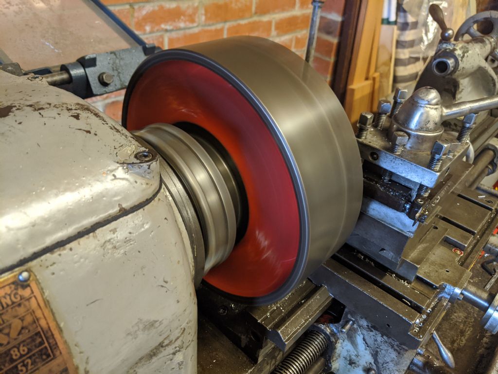

                                          I need to turn the tracking wheel from my belt grinder to a different shape since when I made it, I did it the wrong shape for belts to track well on it!

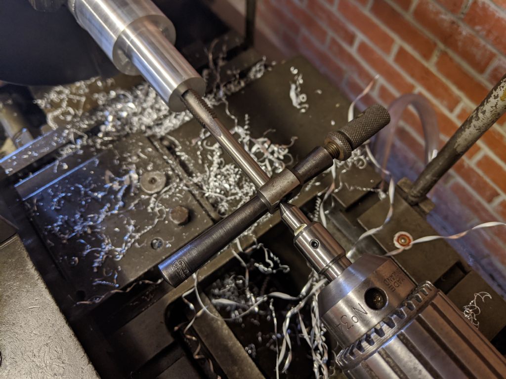

                                            I had a lot of fun today. i finally reprofiled the tracking wheel from my belt grinder.
                                            Initially when I made the sander, I didn't know about belt tracking as much, so I made the wheel this shape
                                            The wheel was too peaked and didn't track as smoothly as it could have done.
                                            I tried to fix this at college when I made it, but the mandrel that it had been turned on was not properly concentric. So when I tried to turn it, the wheel wasn't round and it cut one side but not the other.
                                            So I solved this today. I used the 3 jaw to make myself a new mandrel and washer to hold the wheel in the 4 jaw, then I turned the wheel down so it was closer to the recommended dimensions from
                                            This paper

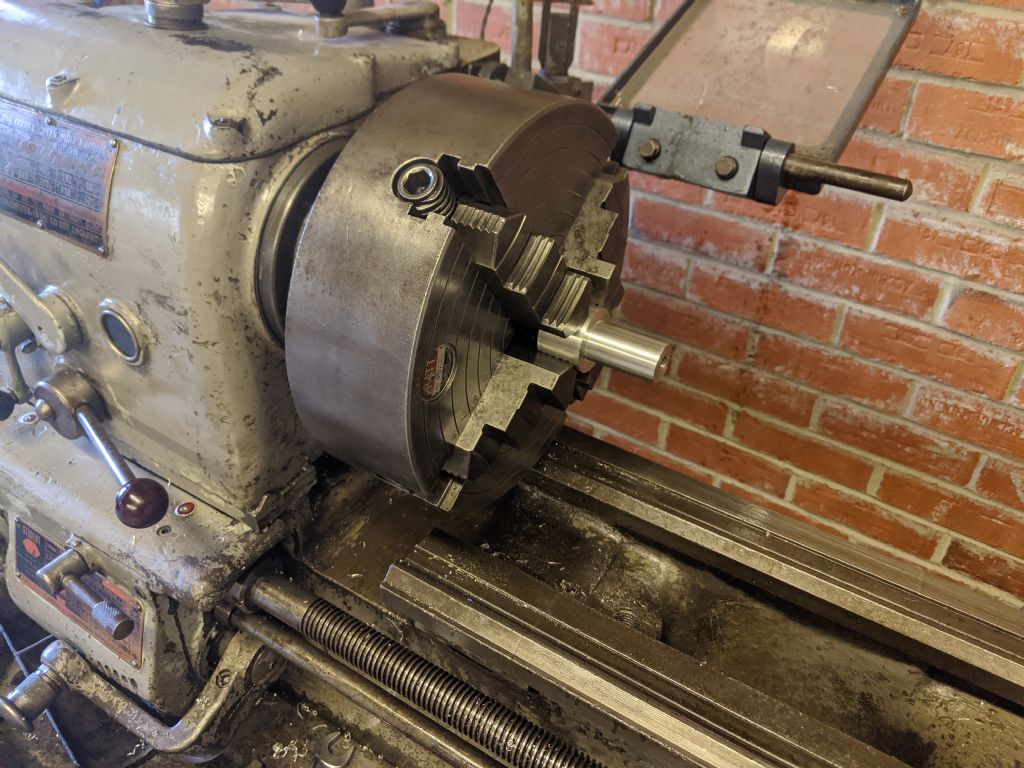

                                            I hadn't ever used a 4 jaw chuck before today. I found dialing in the chuck to be quite satisfying, once I got to grips with it.
                                            I also got to use my spring center for the first time! Very handy
                                            I aligned the mandrel in the 4 jaw chuck first, centering that up. Then I put the wheel on and centered it to that. I probably could have just done the wheel, but I wanted the practice
                                            Very good looking chuck i think
                                            I didn't need to take much off but I tried to get a really good finish

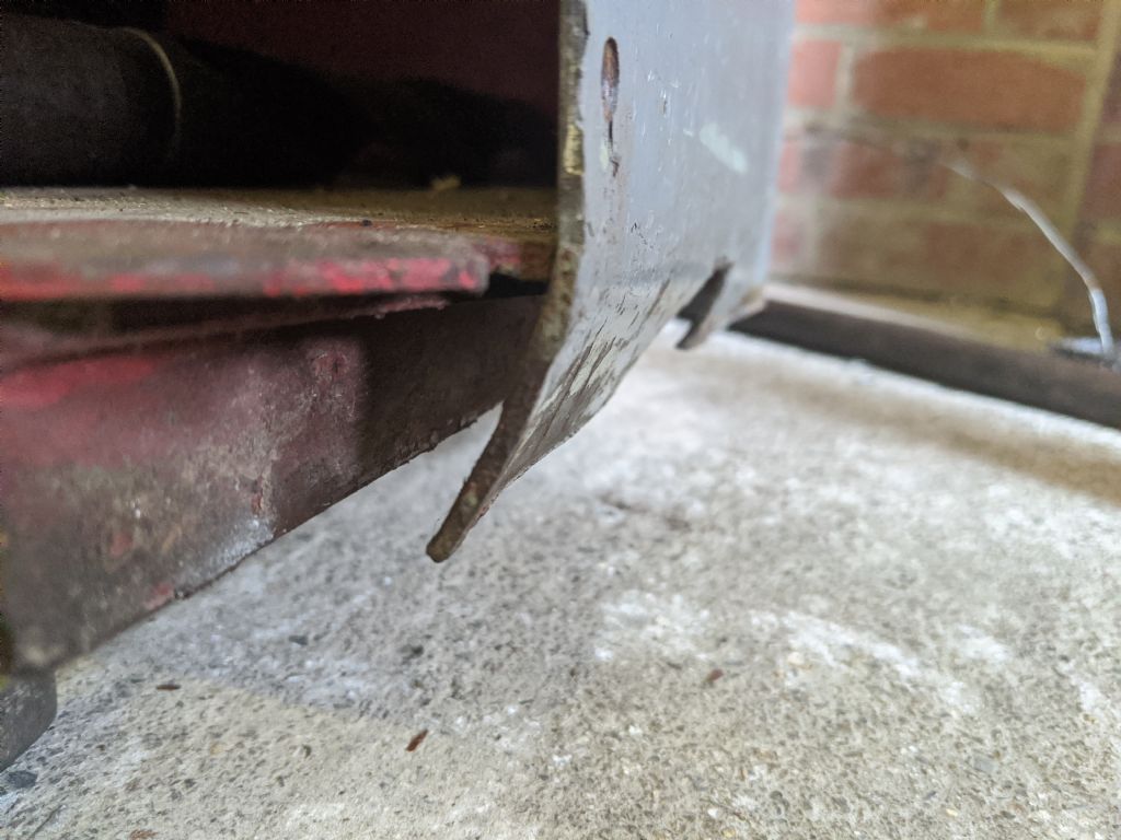

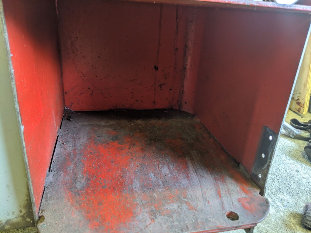

                                            The bottom right corner of the lathe was bent so i thought i'd bend it back a little. Not perfect, but better than it was.
                                            I also gave the cupboard a clean so I can put the chuck away nice and dirt free

                                              Hi Richard, looking at your last picture, is that a fixing hole in the base of the cupboard, or is it a threaded jacking point? According to your manual, which is correct for both our machines, because we both have the earlier 2 slot apron "levelling screws were not fitted to cabinet models, only to leg models" but according to my slightly later "1.5" model manual with the safety apron, there are leveling screws. I suppose tt all depends on whether they changed to the later cabinets at the same time as the later apron came in! Aslo in your manual there IS details of testing for twist in the bed and levelling, but not in mine.

                                                The hole isn't threaded. I don't think it's a good place for a foot anyway since it's not the most reinforced part of the base.
                                                the mk1.5 had 6 feet, so I think we're on a different base as you can see

                                                    yes, you are right, it would not be a good place for a foot, but it does look like a fixing position. Is that pic of the screw foot on your lathe? I have nothing like that on mine!
