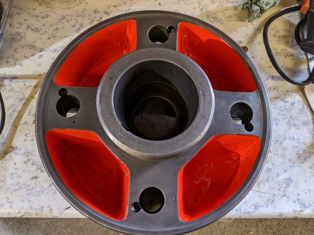

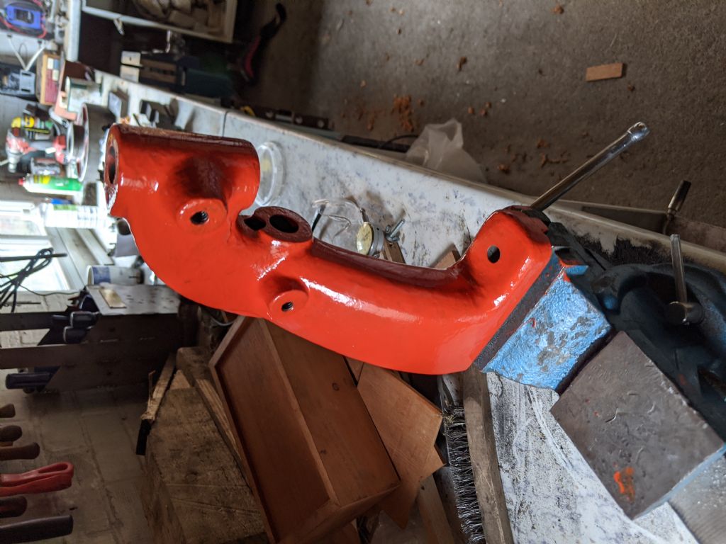

                  Traveling steady is looking very orange. It'll hopefully darken a little since it's meant to be red. But it's probably only 6 or so degrees in the garage. So it's not drying very quickly at all still, I don't need it any time soon. I'll just wait before I sand it and put another coat on. Might even bring it in the house to dry
                  That picture makes it look better than it is. And that still looks rough
                  Got the inside of the chuck painted too. I think it looks very nice. Perhaps unnecessarily nice. But I like it

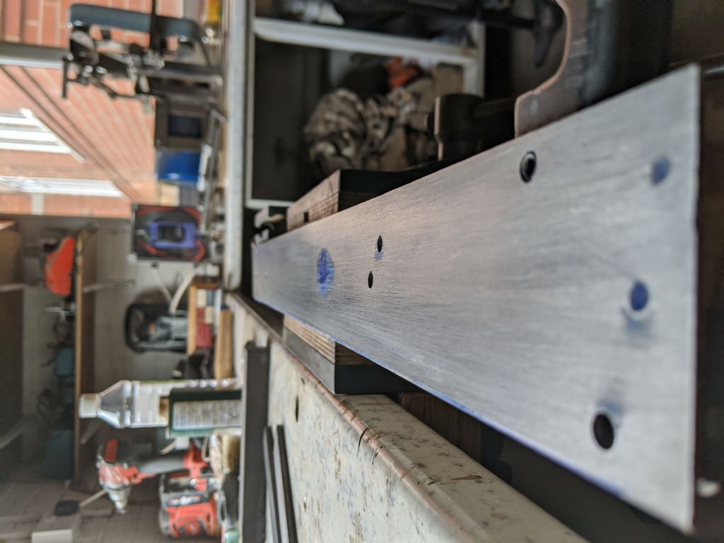

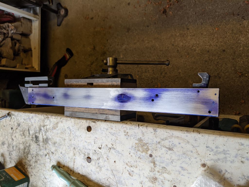

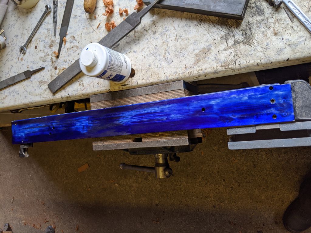

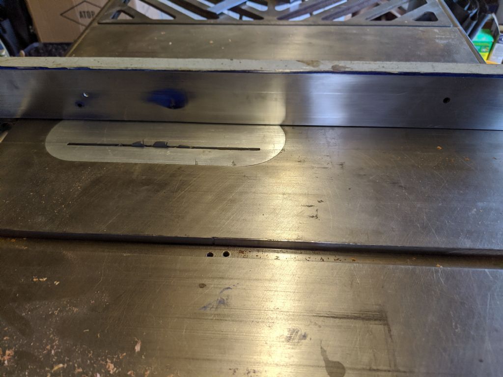

                  So I've blued it up
                  Letting that dry then I'll get back to filing it some more

                    I see the problem now, it is pressed metal, not cast, and looks, with the round clamps at either end, like it comes from a very similar sawbench to mine, which is a startright? The fence on mine is missing.sad

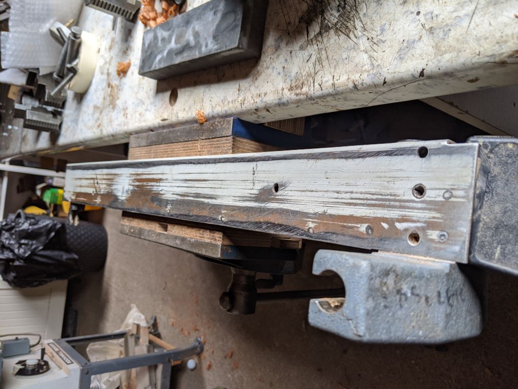

                      Well it was a lot of filling. But it's a lot flatter than it was
                      I've just blued it up again, now I've glued a bit of 240 grit paper to a bit of glass so I'm sanding it flatter (hopefully)
                      It's an old Rockwell 9 inch. Canadian. Not as good quality as startright or however you spell it. But it should do the job when it's aligned properly. It's been causing me problems for a while. Either that or I'm the problem
                      There's a few low spots, but it's good enough for woodworking

                        that looks a hell of a lot better Richard!

                          Still had some low different low spots when I started to sand, but they cleaned up quite quickly. I didn't bother to get them all. Did 240 then 600 grit. Left it there
                          All done with that now. Although I still would like to machine it at some point since it's not square to the table either

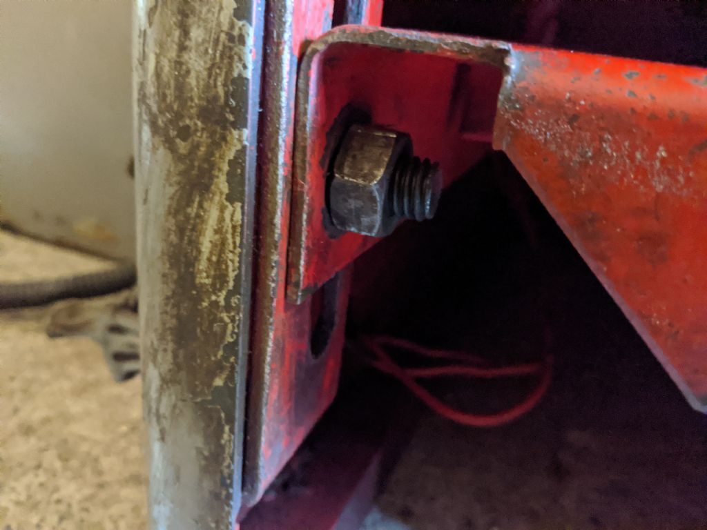

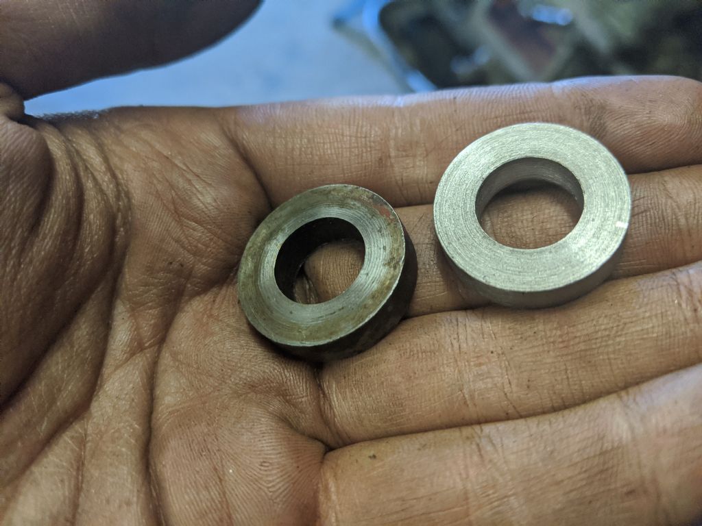

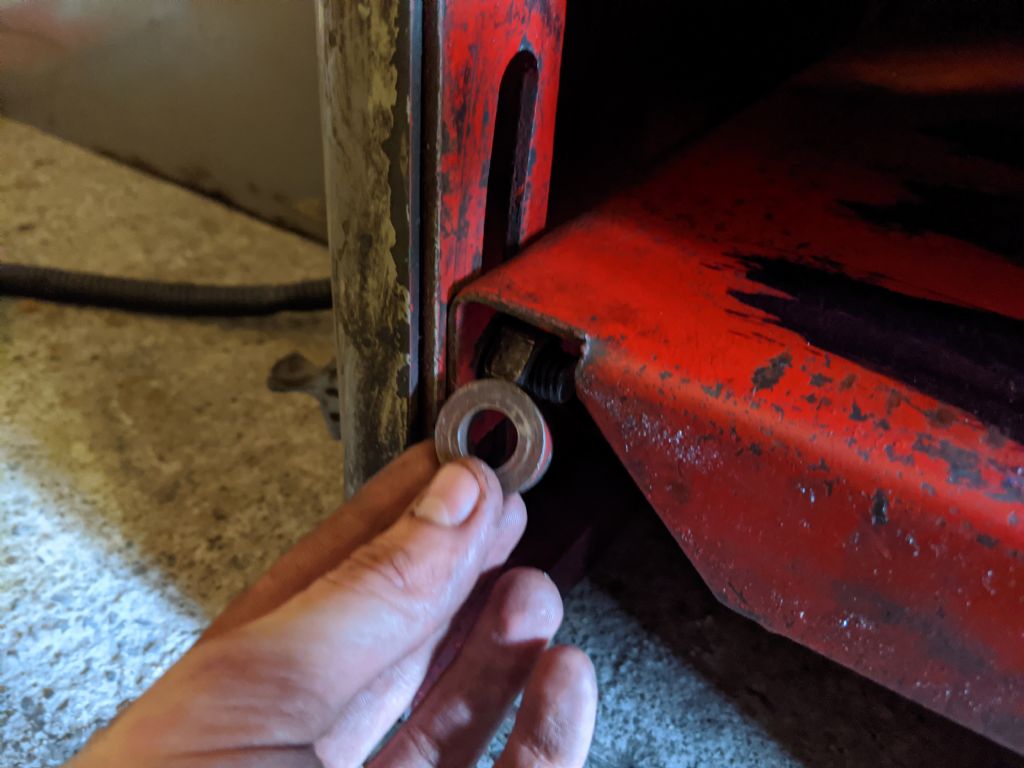

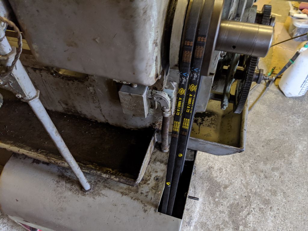

                            In preparation I fitted the motor properly in location and the belts, fits much better than the old belts and allows for changing of the tension of the belt
                            the motor plate only has one washer, so that'll be my first project, to make a secondimg_20200404_111427.jpg

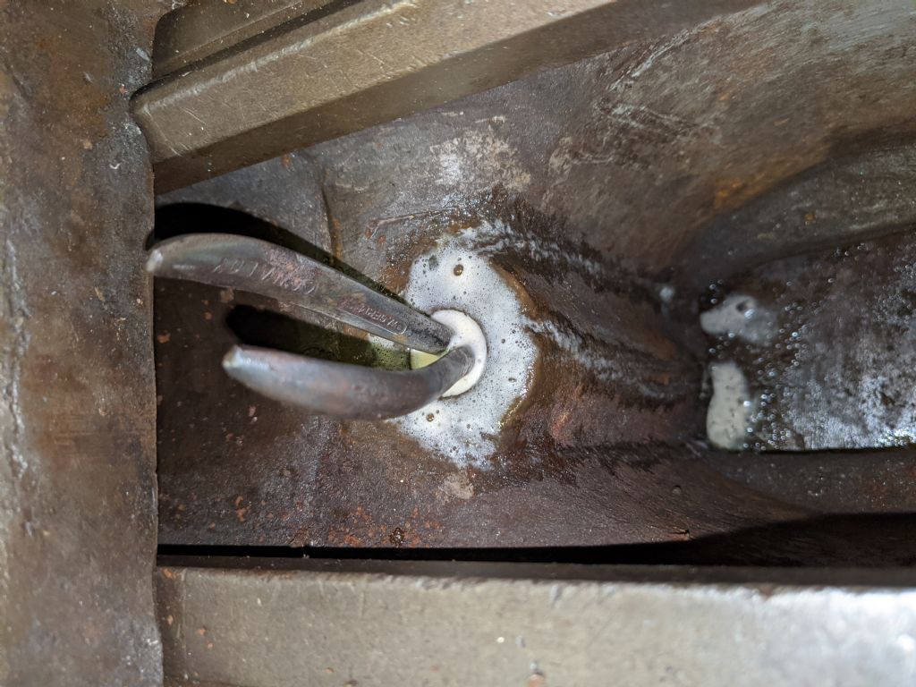

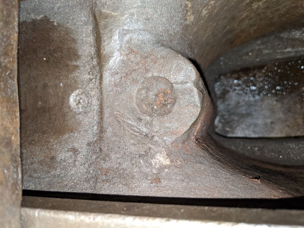

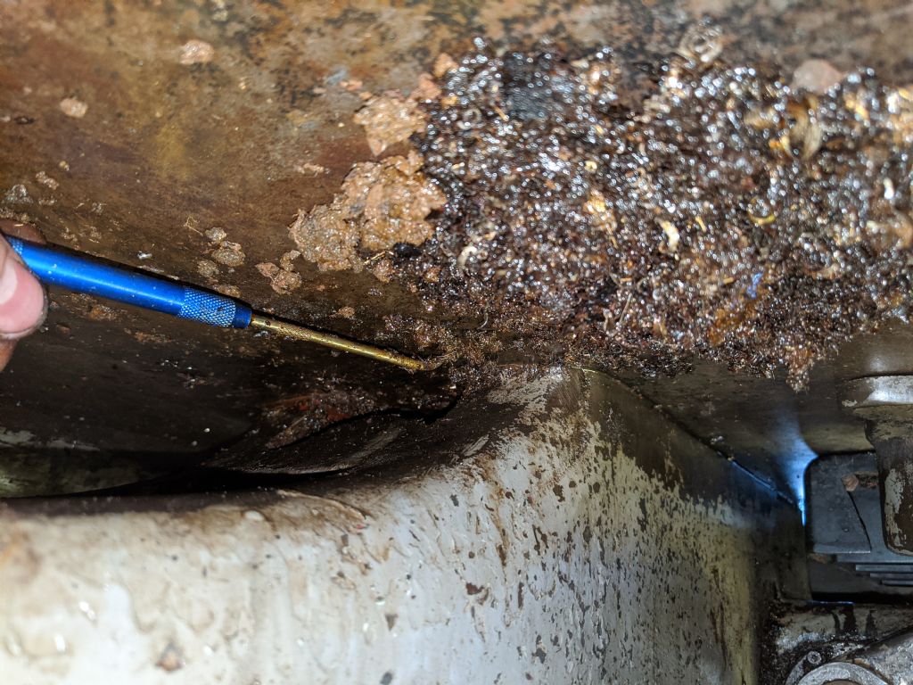

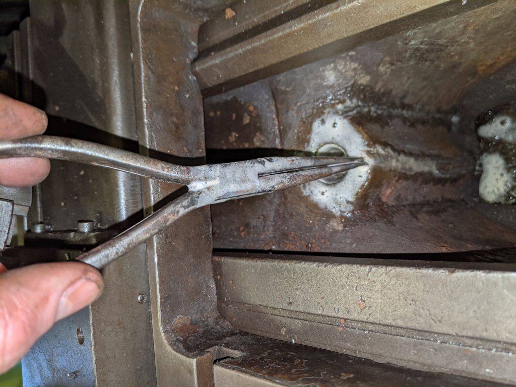

                              Found a hole that I thought was going to be a bolt head or something, but it turned out to be a threaded hole and about 4 inches deep. It's just in the lathe bed. Not sure what it's for? It was full of crap, but I got most of it out
                              Just showing the depth
                              Then below there are some holes which I managed to clean a lot of stuff out of
                              Upside down, but you can see the gunk

                                That big hole is for the lifting eye, if you take the chuck off, put in the lifting eye, and attach a crane, you lift the entire machine, moving the saddle left and right to get the balance.

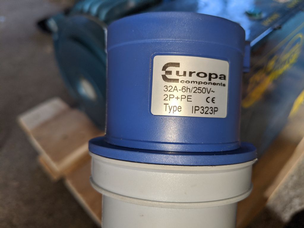

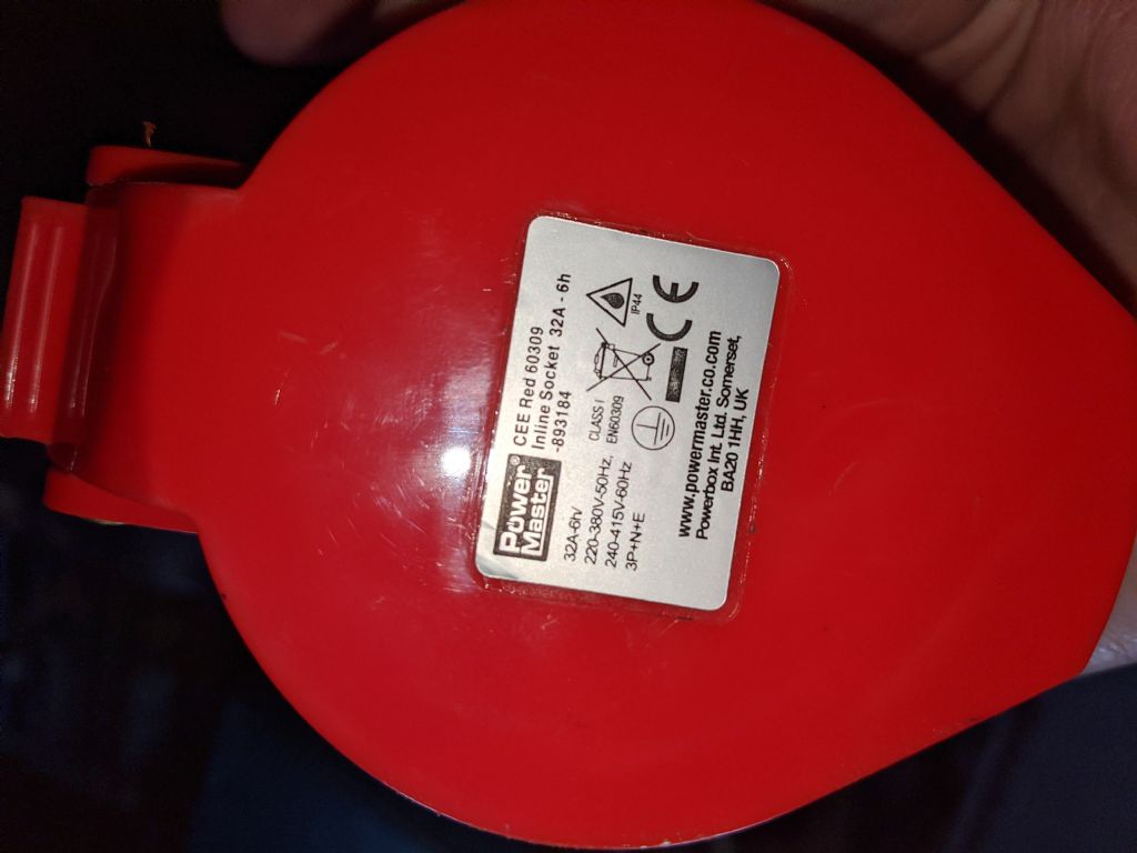

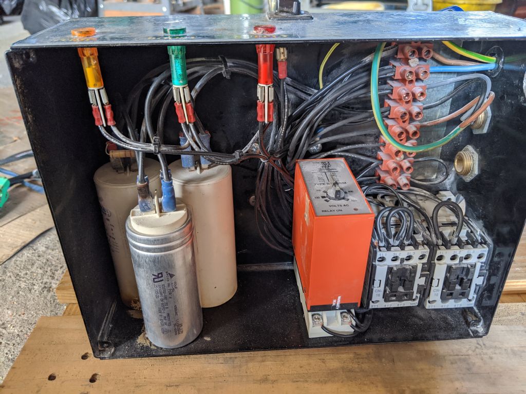

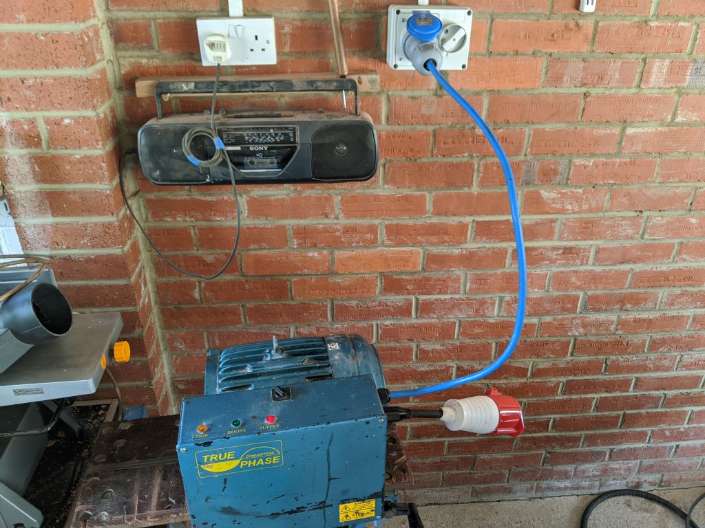

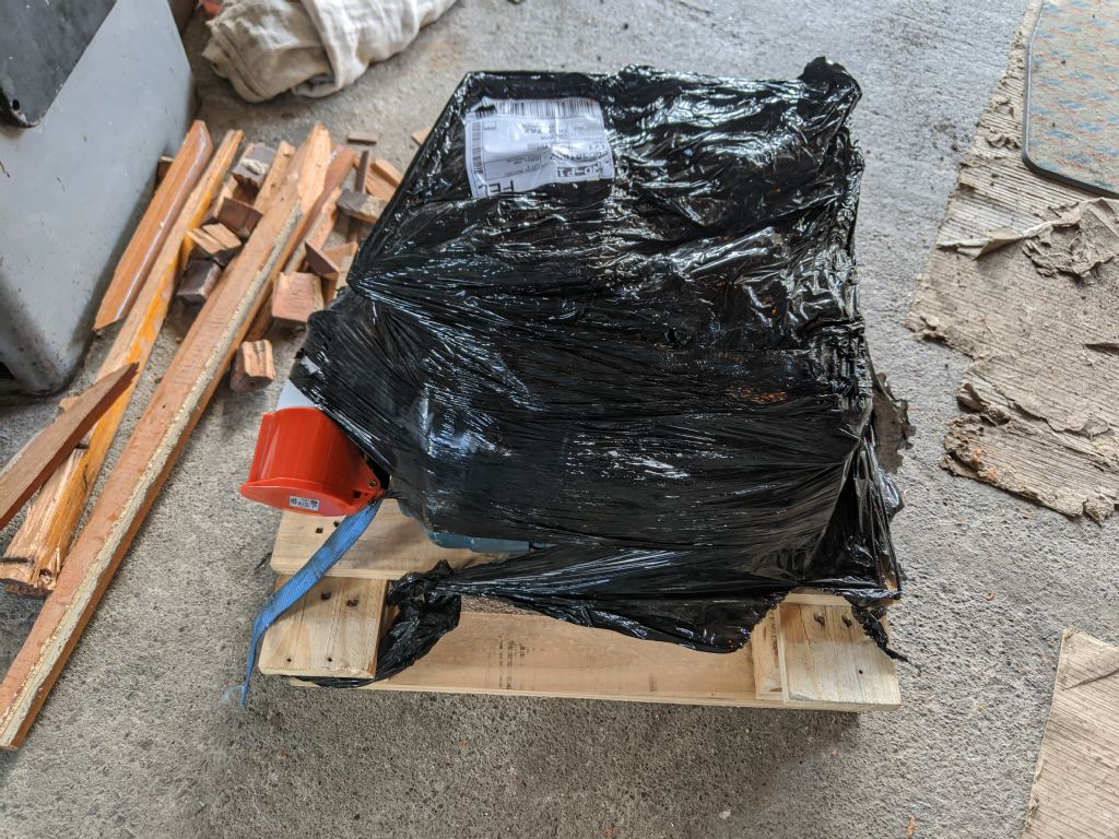

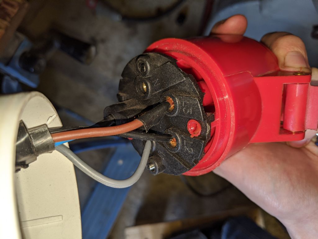

                                    We have a big blue box. As expected we have a 32 amp 415v ket on the end, so can't plug and play. Where can I get a 32 amp plug today? Especially with lockdown

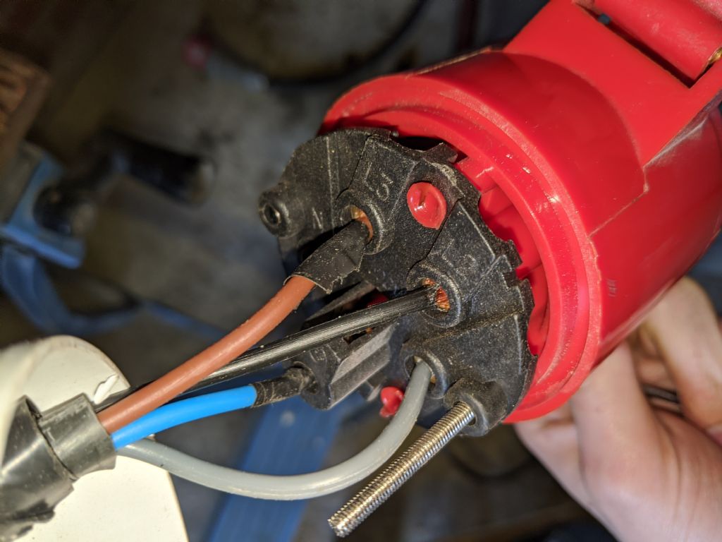

                                    I've swapped the 16amp plug on it for the 32amp one that had left over from the Clarke converter also noticed that the connections from the box seem a bit off, so added a gland to secure it since had one spare. I'd like to fill in the other holes to stop dust getting in
                                    Plugged it in and it seems to turn on just fine. Better than I thought it would. I'm surprised how quiet it is
                                    https://photos.app.goo.gl/VU5hf6xW3RThjGwh6
                                    #462734
                                    Phil Whitley
                                      @philwhitley94135
                                      OOOH exitin! Have a ring round your local electrical wholesalers, CEF, Tep, and YESSS! See who, if anyone, is open, all should carry stock of this, very common item. I guess you will have done, but if not, clean the dust out of the inside, especially around the contactors, and keep fingers away from the capacitors, they bite hard even with the power off! If nothing else, tape over the spare holes, you could get a mounted socket and fit it to the box, save having the flying socketThe moment of truth approaches!
                                      Be safe,
                                      Phil.
                                      Oh, and check the earth continuity from the single phase socket to the lathe! Most important!

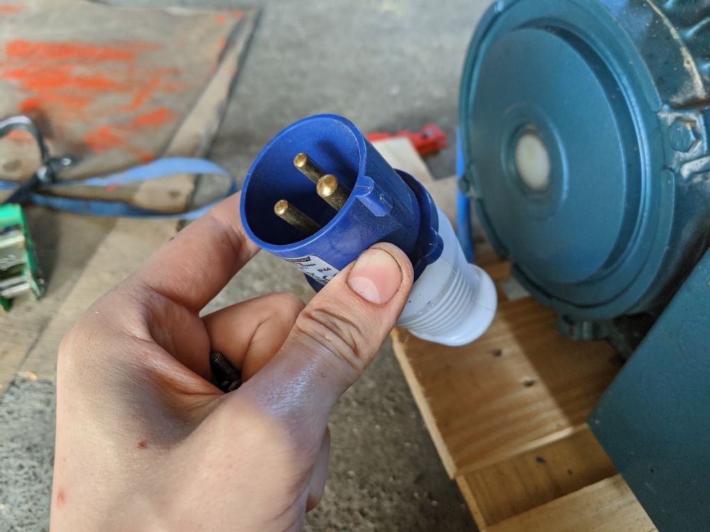

                                        The socket on the machine is 5 pin 3p+E+N but the converter doesn't have a neutral and neither does the lathe
                                        So, do I get a 4 pin 32 amp socket to fit to the machine and get a 32 amp 4 pin plug to go on the lathe(up from the 16 that's there, although it shouldn't be drawing anywhere near 16amps) Or can do I need to change things around?
                                        I don't know if a 16 amp 415v plug is smaller than a 32 amp one though?

                                          I would get a 16a 3pole +earth 4 pin socket, no need at all for a 32A, the only 32a socket I have is for the welders! if you add the FLA on the motor and the pump, I doubt it will come to 10a! 16 anp is smaller than the 32a.
                                          Phil

                                            Make sure you wire an earth from the incoming supply earth in the phase convertor to the output socket earth pin! It does not appear to be earthed at the moment!
                                            #462758
                                            Richard Kirkman 1
                                              @richardkirkman1
                                              Are there any safety advantages of putting a 32 amp plug and socket on instead?
                                              #462759
                                              Phil Whitley
                                                @philwhitley94135
                                                NONE! all my 3 phase machines runs on 16A sockets
                                                Edited By Phil Whitley on 06/04/2020 13:14:50

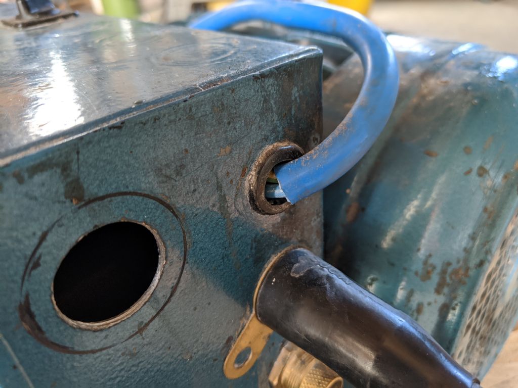

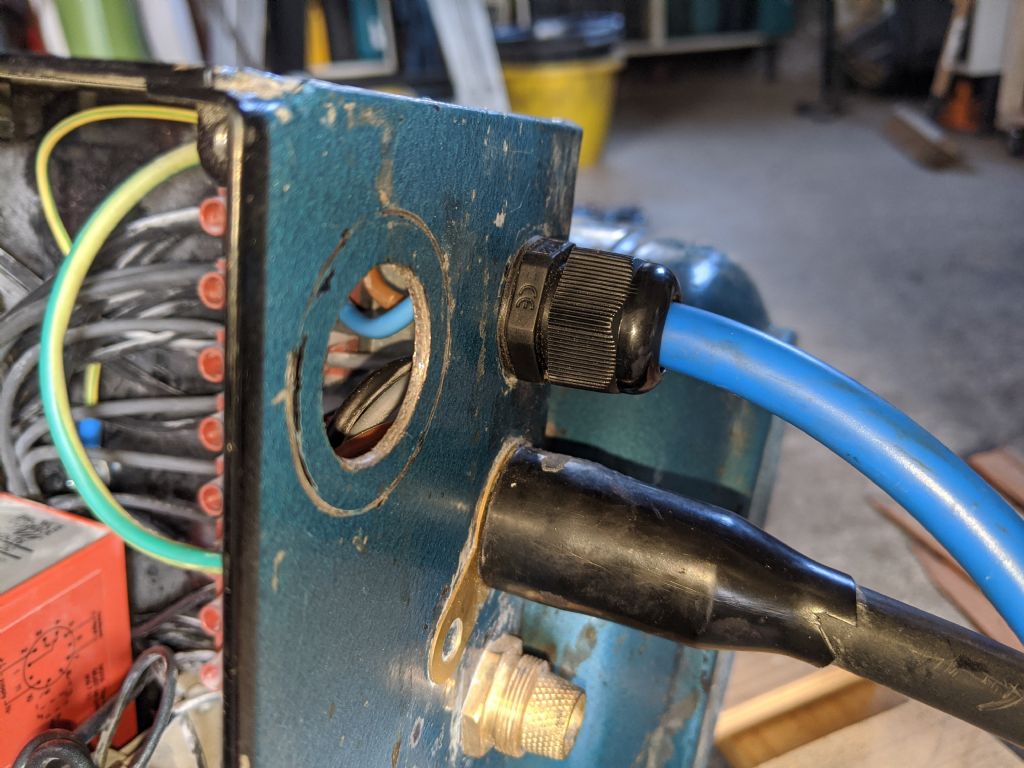

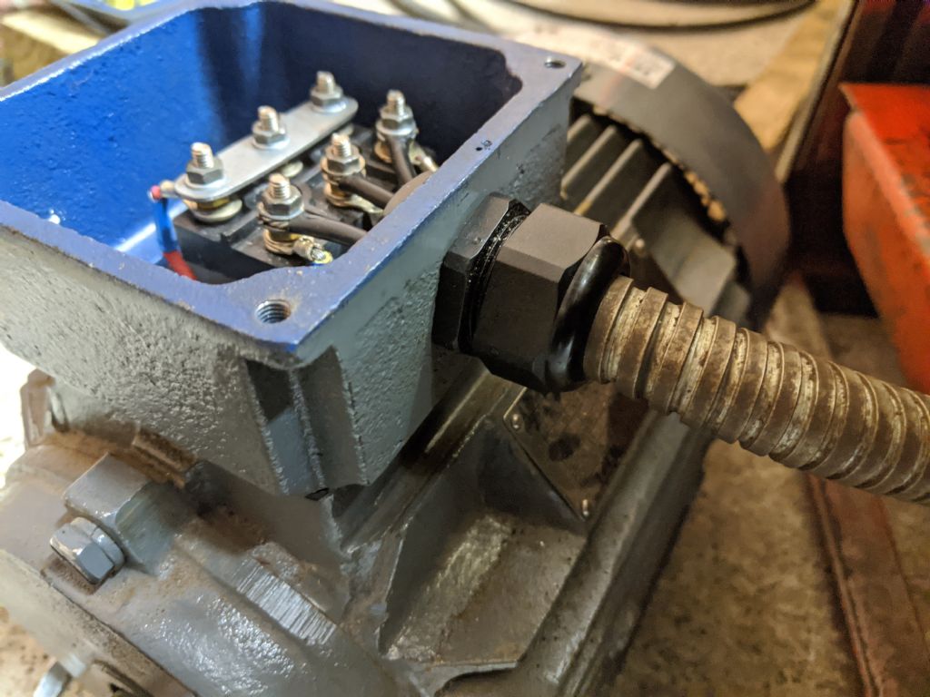

                                                  I took the motor out and put that spare gland I had on it. It's holding the conduit very well. It's not the stuff that threads in, but it's doing the job
                                                  I'll keep the motor out for when the socket arrives tomorrow. So I can just test without a load. I'm pretty happy with the converter so far. Much more satisfying to turn on than the Clarke static one 😄

                                                    Yup, that gland is fine Richard, just remember that when you try it out, the motor will not be earthed!! put a seperate earth to the motor when testing!
                                                    Phil.

                                                      Socket arrives around 2.30 so I went straight out and fitted it. Lathe works beautifully. See videos for footage. I did turn it on once or twice and it didn't turn on(see 2.22 in the first linked video), so I presume some contacts need cleaning. Possibly in the c and d switch on the back. There's a clicking noise coming from the lathe too, but that's just where the belts are flexing and hitting the frame, a tiny bit of filling will sort that. I still cannot hear the contactor pulling in like I'd want. See what you think from the video

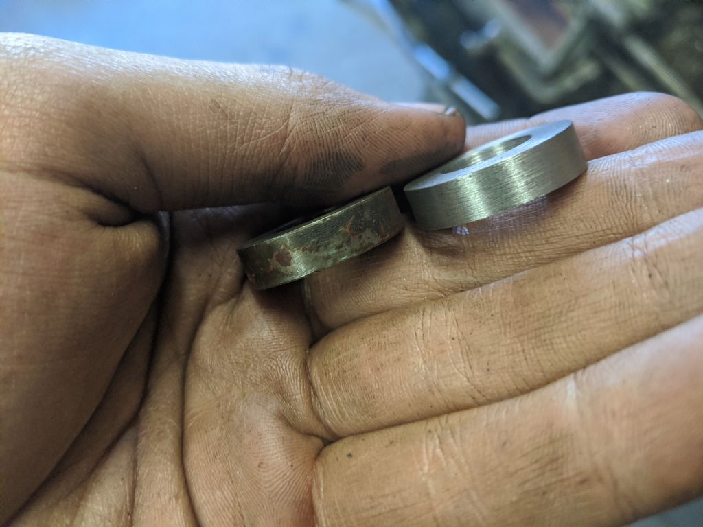

                                                      As I said I would, I made a spacer to go where the missing one was. It was fun to try and get them to be as identical as possible, but was difficult with my available tooling(no boring bar big enough and not a drill bit the right size) still, I managed
