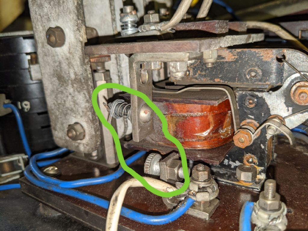

      there is a loose piece pictured in the casing that looks broken and i have no idea where it may have gone. The reverse forward switch which has been added looks fine to me and all the pieces inside the case are fine.

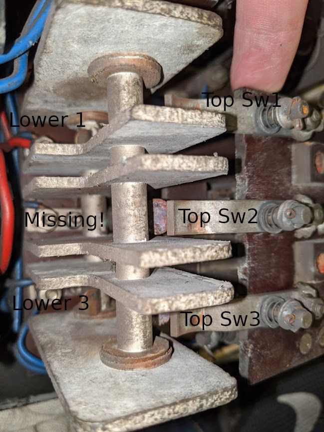

          may be the centre tongue from whatever this is: (I think it's the contactor)
          Slightly worrying that someone has already been at the electrics.

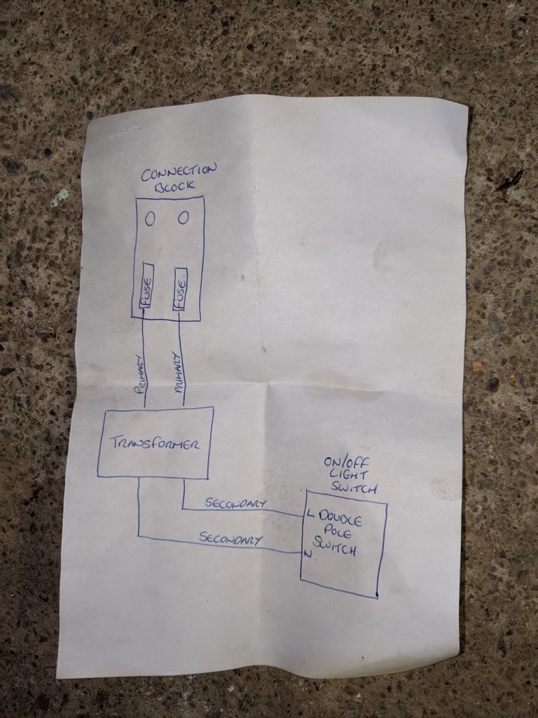

          and the missing indicator lamp:
          Tempting to assume it's a major rewiring job, but it's possible it was left in running condition. Check everything obvious first. Then look for missing connections, bust contactor, broken rotary switch, or duff motor. That will involve tracing the circuit with a test meter, which is another subject.
          Any Colchester owners able to positively identify the contactor? Are those fabric insulated pillars inside short wide coils thermal cut-outs that might need TLC?

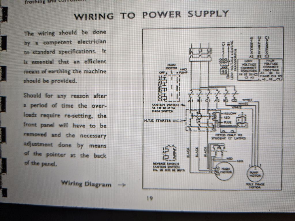

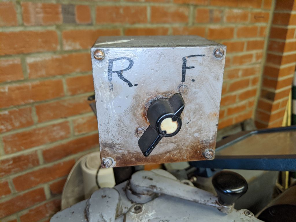

            Hi there Richard, first off, do you have a manual? If you search the files at colchester lathe user, you can download one, if you have problems I can send you a pdf. There is a wiring diagram in it. In the pic below, the square box on the back of the headstock operates the contactor, and is operated by pressing the front lever with the red knob down.
            Just a small thing, and probably wont apply, but the Student has a key switchin the opposite end of the metal cabinet, you put a small key in it and turn it, and it opens the cupboard doors, and turns the power on. most of these are disconnected very quickly by owners, but worth checking. You need a mains tester with which you can check the presence of mains power at the contactor terminals safely!! First, check that the front lever is operating the switch correctly. can you send some pics I have a student Mk1 and I am next to it every day, and can answer most questions you might have by checking mine. Where are you in the UK?

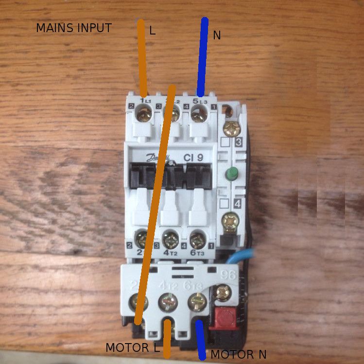

                      Have you got a neutral connected to the switch gear – I think I'd expect the contactors to need a neutral to the coil, not be connected line to line. But if they are line to line the point above about being connected to the transformed input phases and not to the false phase is valid. What voltage is your converter actually applying, and is it three phase at all?
                      If you are not familiar with machine electrics that might sound like gobbledegook, so can you tell us where you are, maybe someone with the relevant expertise can assist "hands on".

                        Posted by Simon Williams 3 on 25/11/2019 20:23:19:
                        On all my industrial machine tools the contactors run phase to phase because a) I've measured the coil voltages and b) the machine inputs are 4 wires – three phases and earth – so there is no neutral.

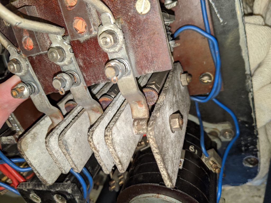

                            But in this part it looks like the contacts are very rusted, if they are contacts that is.
                            As far as the light switch not being there, I would like to fit one, but I cant seem to find a genuine replacement for the part(any direction from anyone appreciated?)

                            And yes I do have the manual specifically for the earlier model and this is the wiring diagram from itimg_20191125_133412.jpg

                                  Hi Richard, mine is definitely a Mk1, but looking at the levers on yours I would say it is a very early mk 1, I do not have the "safety apron". If you can hear the contactor pull in when you press the front lever down, and the switch for the main motor is set to on, then it should run, stupid suggestion, the chuck guard doesnt have a safety switch on it? The main contactor is pulling in, and usually the safety switches are wired into the coil circuit, but who knows if a second contactor has been added. Turn OFF and disconnect the power, and with a multimeter, see if you can test from the contactor to the reversing switch, and from the reversing switch to the motor. This does depend on whether the reversing switch is before the contactor or after it, but I suspect it is after, it is a start anyway!

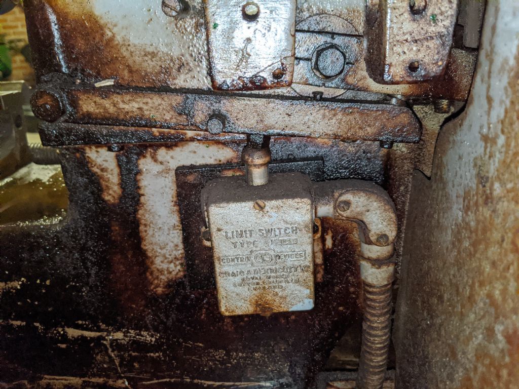

                                      I'm getting quite confused with all these terms. Specifically which part is the contactor, is it this part? And if its not this part, what is this part and what does it do and why?img_20191125_125101.jpg

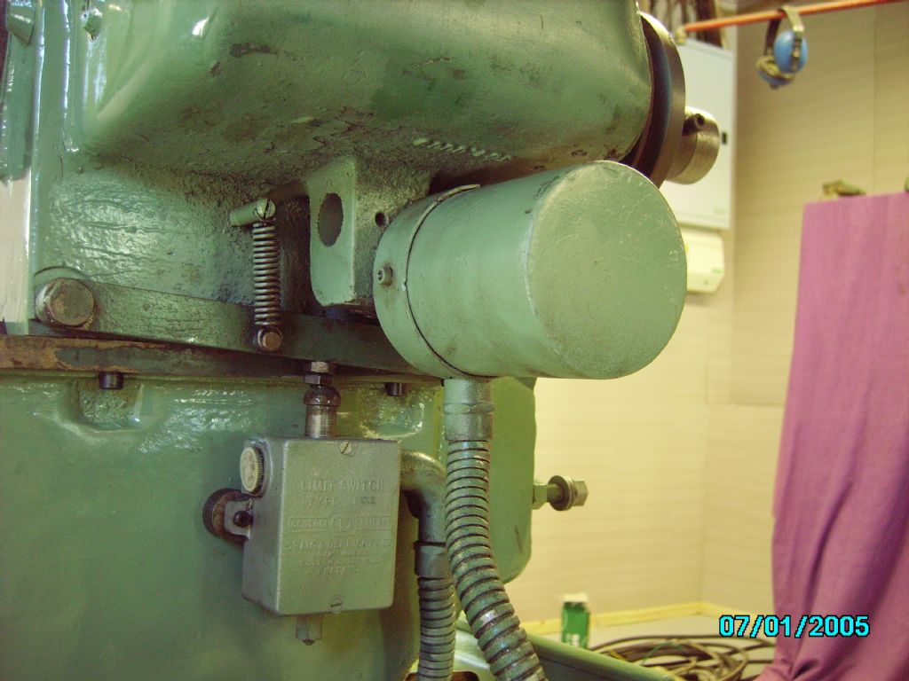

                                      Or is it this part at the back. The piece that says limit switch has a pin that moves up and down when i switch the lathe on from the lever on the front and makes a click as it goes into place. But, I'm not too sure what noises i'm looking for?img_20191125_130059.jpg
                                      And no, there isn't a switch on the chuck guard. Also, i have access to the motor round the back so I am able to check if it buzzes but i have not done so yet.

                                        Don't know if it's been mentioned but from memory Colchester students have a limit switch on the gearbox door, presumably to knock the power off if its opened whilst in motion. Might be worth checking.
                                        Guy

                                              Hi Richard,
                                              The item pictured with 3 contacts separated by grey (asbestos?) insulation panels is the contactor. The contacts don't look great. If you can hear this clunking with the start lever operation the PC40 is powering it.
                                              Do you have a multimeter / test meter? You really need to get into some fault finding.
                                              First thing would be to check the contactor contact resistance you can do this with it unpowered by manually closing it , pushing down on the brown (Tufnol) insulator that carries the moving contacts and then checking the resistance across each contact.
                                              Robert G8RPI.

                                                  According to the circuit diagram the contactor has two pairs of 3 switches. One pair connects three phase to the pump and the other connects 3-phase to the main motor.
                                                  Contactors are electrically operated switches. Basically a low safe voltage is applied to a magnet coil that pulls the switch contacts together, and they do all the heavy lifting. Your contactor is very old-fashioned; everything is out in the open, making it vulnerable to damp and dirt.
                                                  Joining the dots:
                                                  1. The contactor must be working because the pump runs (you think!) However, the contactor should make a distinct 'clunk' noise when it switches on or off, and that's not been mentioned.

                                                    Posted by SillyOldDuffer on 27/11/2019 11:37:46:
                                                    Joining the dots:
                                                    2. In the photo above I've labelled the switches. I guess the three on top (SW1,2,3) connect the pump. If so, the lower set connect the main motor. The rounded ends of two switch tongues can just be seen: I've labelled them Lower 1 and Lower 2. I believe the centre tongue, labelled 'Missing!' has broken off, so the motor has at least one of its 3 inputs disconnected. Given that the contacts are filthy, may be more!
                                                    Although the contactor may be of obsolete design, the control circuit is isn't! Much the same is used on modern lathe.
                                                    Modern contactors like the example above come in nice sealed boxes, rather smaller than yours, with no maintenance required. Entirely possible to replace the old contactor with a new one, the main problem being to identify one with a 240V operating coil, and six switches. They're readily available. (Ignore the annotations – they're for a single-phase motor.)
                                                    Dave, I don't think the pump does actually run. I just hear it buzzing, but I don't think it's a loud enough buzz for the motor to be running. But the point is it's getting some electricity
                                                    When I turn the on switch, I hear a large clunk noise. But I think that's just the noise that the switch makes. I don't think the contactor has moved apart from when I'm in there.
                                                    The tongue you mentioned is definitely missing, I hadn't noticed before. And I've only just noticed now, that another tab and contact that should be paired(the one that's broken in the bottom of the case) should probably go here?
                                                    The white/dirty white cable going from the bottom is the coolant pumps cable. So the blue wire has been put down there when it should be going onto the contactor above and have the tab which is loose in the bottom connecting the pump. Does that make sense to you? I'm just guessing sti, but it seems to be logical to me

                                                      SOD, I think you are mistaken.
                                                      ''According to the circuit diagram the contactor has two pairs of 3 switches. One pair connects three phase to the pump and the other connects 3-phase to the main motor.''
                                                      The Colchester diagram shows the coolant pump being started directly from the rotary switch, by 3 of the poles, the other three poles are connected to the line contactor and thermal overload and thence to the spindle motor.
                                                      Hope this helps.
