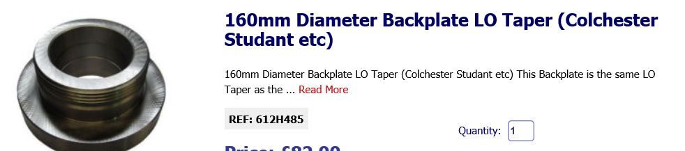

                I've mounted 2 chucks on re-machined L0 catch plates for my student. They came from Ebay and at about £20 a go were much cheaper that the premachined L0 backplates from the like of gloster, and the accuracy was already there…. An ER40 will go onto one at some point soon as I've got a couple of spares.
                I added an RDG HBM 150mm 3Jaw, which is much more accurate than the original 40 year old Burnered one, the only downside is it jams more easily with Cast Iron dust. If I need more accuracy I use collet chuck (multibore), or the huge 4 jaw.

                                  You can buy a LO backplate and fit a ER collet chuck to that which is what I did on my AUD Boxford

                                      Mines a standard Boxford threaded adaptor but you can by LO backplates and fit a similar ER40 chuck

                                        #223874
                                        Bob Brown 1
                                          @bobbrown1
                                          #223877
                                          Bob Brown 1
                                            @bobbrown1
                                            You just add one of these to the backplate above
