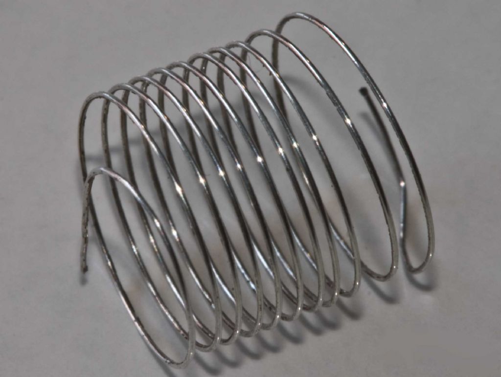

                Sam Stones
                  @samstones42903
                  IF ONLY I'd known about that method when I was winding my balance spring(s).
                  This was the best I could manage using guitar strings. All previous attempts ended with intertwined loops whenever I released the tension.
                  For reference …
                  Wire diameter = 0.008" (0.2mm).
                  Spring diameter = 0.375" (9.5mm)
                  Turns required = 9
                  BTW – For those interested, the clock has been running since late 2010. You can track my article about building John Stevens clock using the notes at the bottom of my profile.
