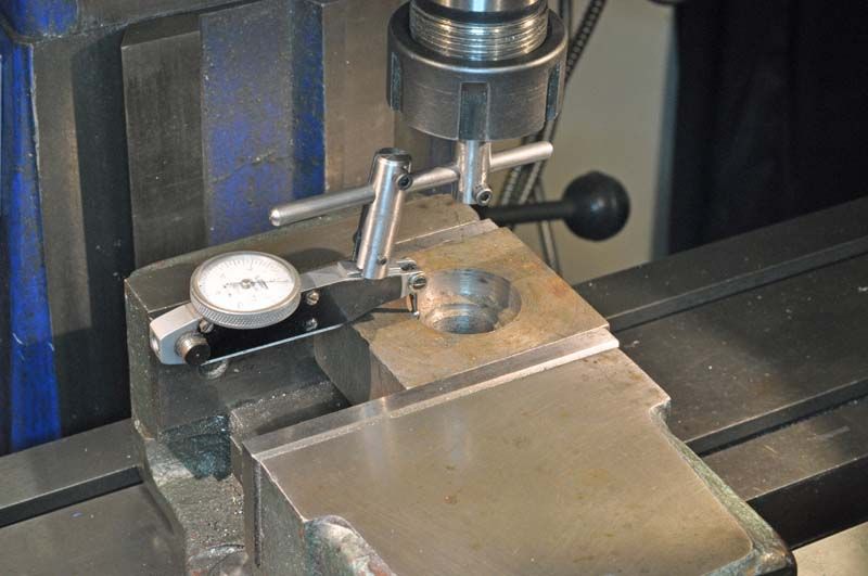

                      This is how I do my co-axial centring:
                      Not quite as convenient as the real McCoy, it won't work if the hole is in a hole (if you see what I mean) but I can at least see the dial through the whole 360 degrees and it takes up much less head room.
                      Rod

                                      Rod's solution is very ingenious and is also possible with this indicator holder I bought from Chronos…
                                      **LINK**
                                      The only issue with the Chronos version IMHO is that the shaft for mounting in the chuck is 8mm – not a standard end-mill size. So I sleeved it up to 10mm so that it fits one of my end-mill collets without me having to swap out the collet chuck for another.
                                      Jon

                                        ARC do something similar **LINK**
                                        However, Muzzer's method really is easy with a DRO – plonk your edge finder somewhere in the hole and touch both sides using only the X axis and divide by 2 to get on the Y diameter, then repeat in the Y direction to get the centre. Why didn't I think of that? – I must be an analogue kind of guy, not digital sad. Actually, you don't even need a DRO, you can do the same thing using the micrometer dials on the X and Y axes surprise.
                                        I suppose, in theory, a rotating system eliminates any run-out of the probe held in the mill chuck but if the chuck is that inaccurate you're already in trouble!
